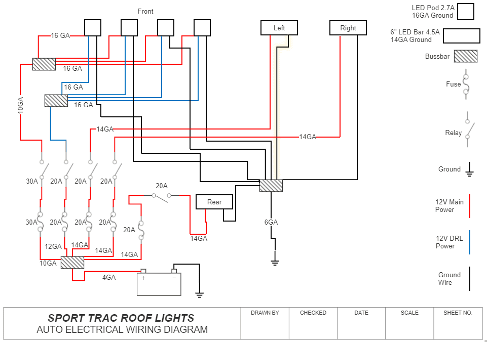

I recently picked up a 2010 Explorer Sport Trac to use as a daily and the modding bug has already got me. I want to add a roof basket and some off road lighting. I want to have 4 pods up front and a 6" light bar for left, right, and rear. Does anyone see any issue with the way I plan on wiring things? I want as few wires as possible going up through the roof. I'm going to concentrically twist the power wires into a harness so it will only be the 5 wire power harness and the ground wire coming up through a dual wire waterproof pass through.
Here is the specs on the wire I will be using. Prowireusa
Any help is appreciated!
