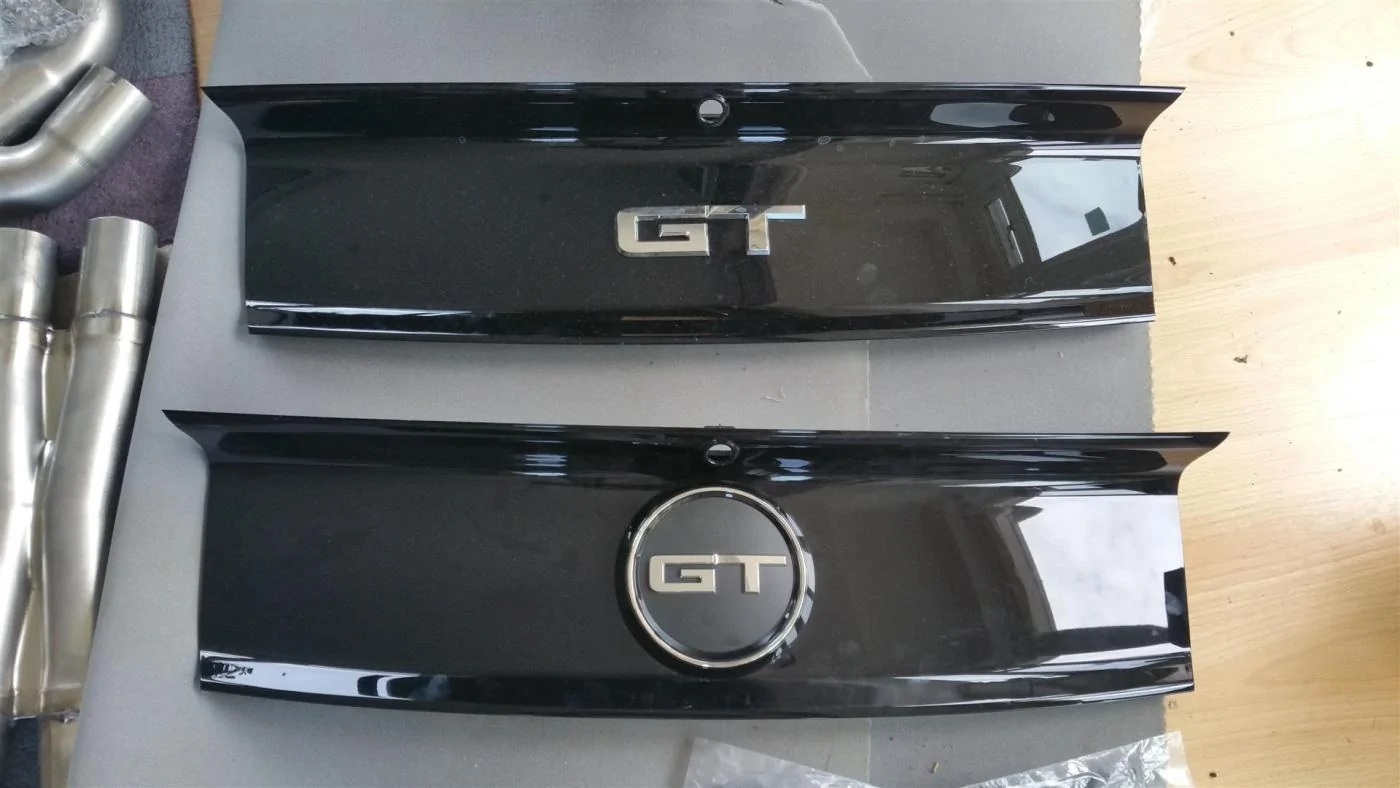

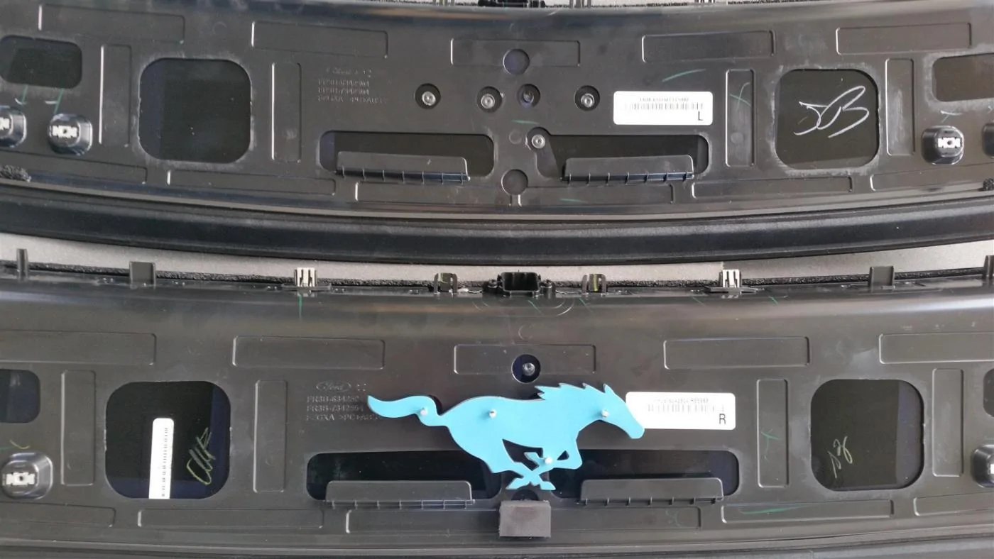

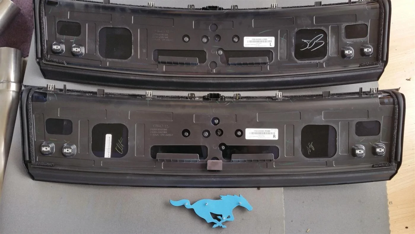

Hey Chaps,
For all of you thinking of buying replacement rear badges (emblems if you ar american).
Here's a comparison of the badge securing points for US deck lid and the UK deck lid from my GT.
As you can see the UK deck lid panel has 2 extra securing holes. 1 at the top and 1 at the bottom(under foam pad) for the 50th anniversary style faux 'gas' lid.
not that interesting a post and some may think its obvious, but this is for all you visual learners out there that have to see it before you believe it (like me).

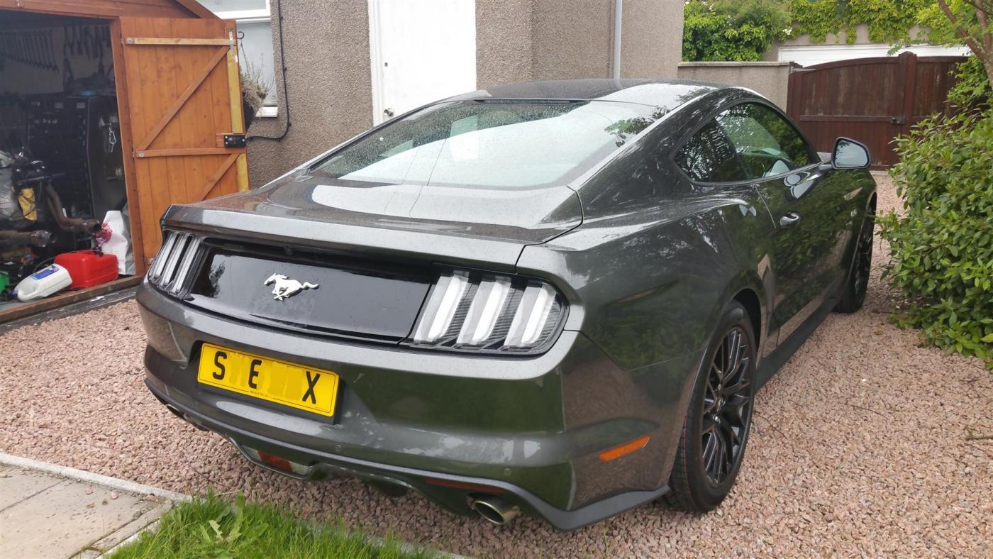

I fitted the US ecoboost panel and am still toying with my matt black ponies or not...
so there you go...
