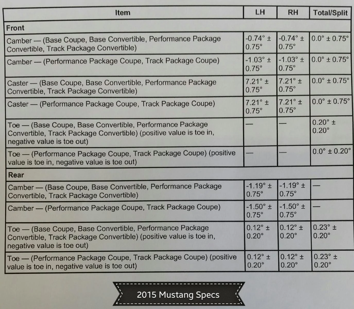

So I installed my springs over a week ago and went to get an alignment today at les schwabbs. They said All they could adjust was the toe setting? what do i need to get so they can do a proper alignment? Here is where it sits now. Screwed up? Thoughts? I've got the performance pack if that matters. Anybody know what Steedas recommended settings are?
