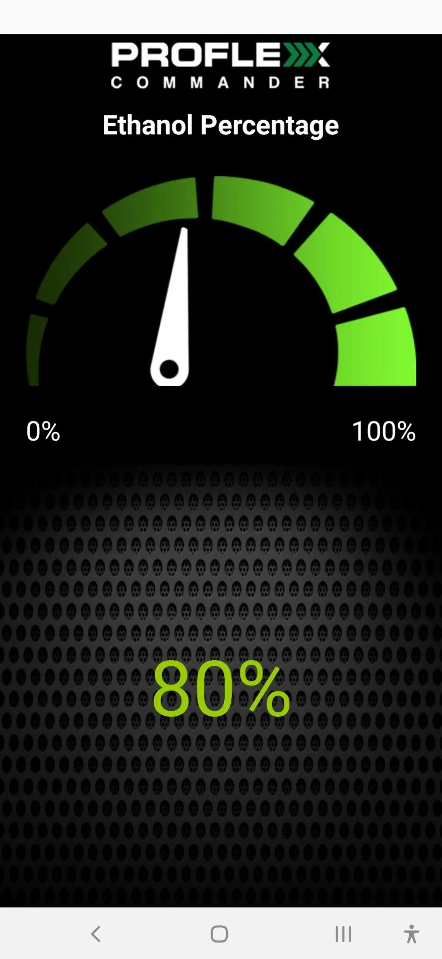

on another note, kind of weird how your 71% dial is closer to the 100% than my 80% on my app.
That is weird but I think mine is where it’s supposed to be. Look at the middle line. That’s 50% so 70% is round about where mine is. On the other hand your 80% is less than 50%. Lol
