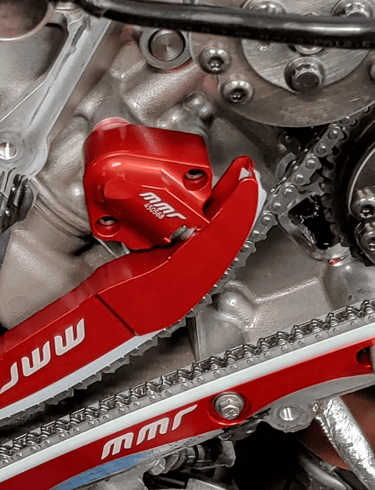

Just wrapped up the install on Comp Stage 3 N/A Cams, MMR Oil Pump Gears, Crank Sprocket, and Timing Chains/Guides/Tensioners.
Everything seems to be golden, but I noticed clicking during startup. After teardown I found the culprit to be the MMR tensioners coming in contact with the MMR guides. It only happens during cold start as once there's oil pressure they don't make contact.
Overall this seems like a design flaw where the small piece sticks out and contacts the guide. Just curious if anyone else runs these guides/tensioners and have had similar issues?
I could probably shave off that small tab on the tensioner to prevent contact, but seems silly that I'd have to do that.

No, not yet. I know the noise is coming from the tensioner contacting the guide. I had turned over the engine by hand and could see and hear the clicking. Next time I take off my timing cover I'm going to grind down the little arm on the tensioner. It's there to hold the pin that holds in the piston, but honestly it's not hard to push in the piston, so I think it wouldn't be too bad grinding it off and getting it back on without the pin holding it for you. I don't plan on tearing the cover off anytime soon, so will have to live with it for now.
Car runs great for me too, just the really bad CLACK CLACK CLACK until oil flows in is pretty annoying. Makes the car sound unhealthy for a second or two every cold start.

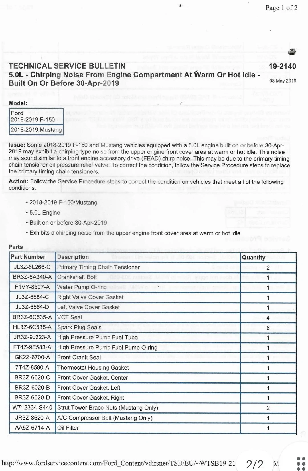

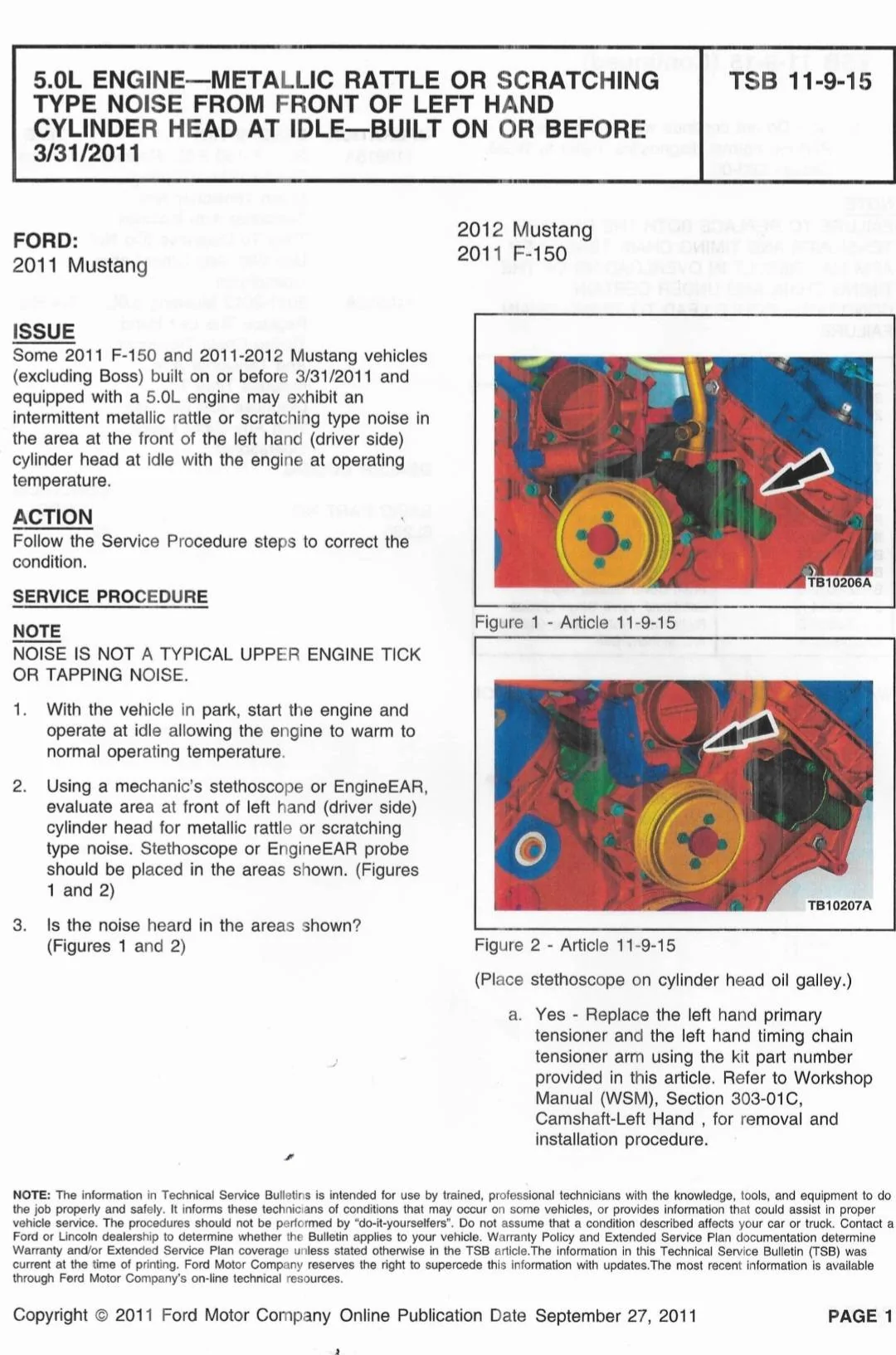

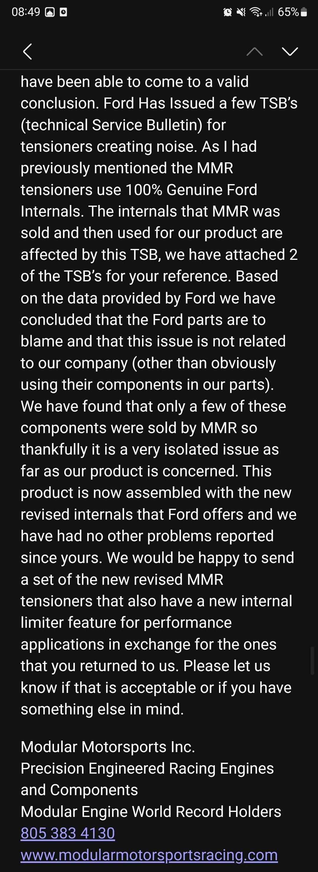

So this is the reply I got from them back when.
It was biggest load of BS I ever read. They sent me a TSB from back in 2011 ( can't understand how that TSB would apply to parts sold in 2019)
And the second TSB was for the 3rd gen coyote regarding phaser chirp. Mine is a 2nd gen and these engines don't suffer from the phaser chirp. They sent me TSBs to try to cover their butt for all coyotes basically. Terrible really.
I didn't bother arguing but I'm not stupid. This shiiii I went through because they F'd up their own QC. The noise didn't come on slowly or it wasn't the case that there was no noise and after 100 miles of driving it showed up. It was there instantly. They tried to say that it may have been damaged during postage because it was international IIRC
But... I purchased these in the US and had the shipped to a US address and then brought them to the UK in my carry on.
