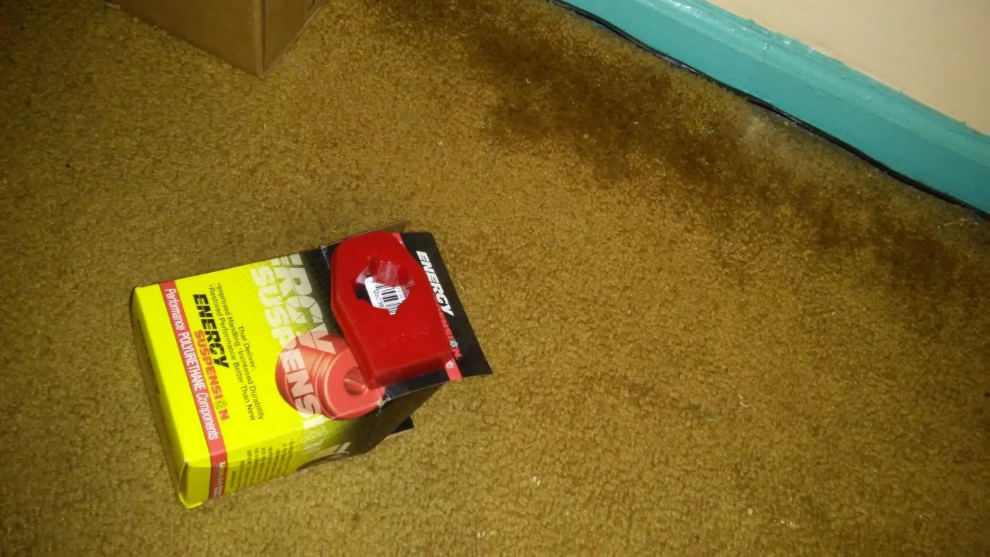

Hey, thanks for taking the time to write all of that for me. I appreciate it. Does sound like a pretty good thing to try for the $ spent.If you get under your car and grab the end of the tranny it is quite easy to move it around. The rubber mount between the cross member and the transmission has several openings in it that allows you to deflect the rubber with your fingers. The insert is a urethane molded piece that fills these openings to stiffen up the mount. Steeda, Whiteline and a couple other outfits sell them.
When I first got my S550 I would get locked out of 3 or 5 about 1 in 4 shifts when driving aggressively. After installing the Steeda version I have not missed a shift since.
This is another no brainer upgrade since these inserts cost only $30.
Having the shifter remotely mounted is great for isolating the interior from noise and vibration but have the tranny and shifter moving around independently of each other is not good for precise shifting. These bushings and inserts reduce the amount of motion so shifting is improved.
There are a couple of outfits that make brackets. That bolt to the tranny and the shifter mounts to the bracket is no longer attached to the floor of the car. This almost cuts the independent motion to zero and is the best solution. After that you are talking about replacing the factory shifter altogether.
I installed the tranny insert first and it made more improvement than the bracket bushing but that could be reversed if I had installed the bushing first.
