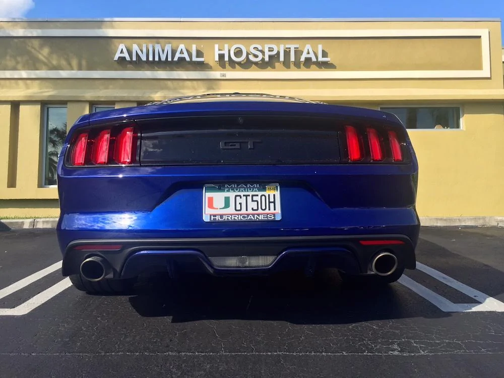

After install video
[ame]
[ame]
Looks and sounds GREAT!After install video
Headers were supposed to go on today, but my guy had an emergency so it got pushed back to Sunday. I will be hitting you up again soon for the stop the hop pack though! can't wait to have this bad boy really rolling, these springs make a huge difference in appearance man!Looks and sounds GREAT!
You'll get them installed soon enough! I want to hear it in personHeaders were supposed to go on today, but my guy had an emergency so it got pushed back to Sunday. I will be hitting you up again soon for the stop the hop pack though! can't wait to have this bad boy really rolling, these springs make a huge difference in appearance man!
Looks great! Headers are tempting but the install looks like a huge pain haha.
