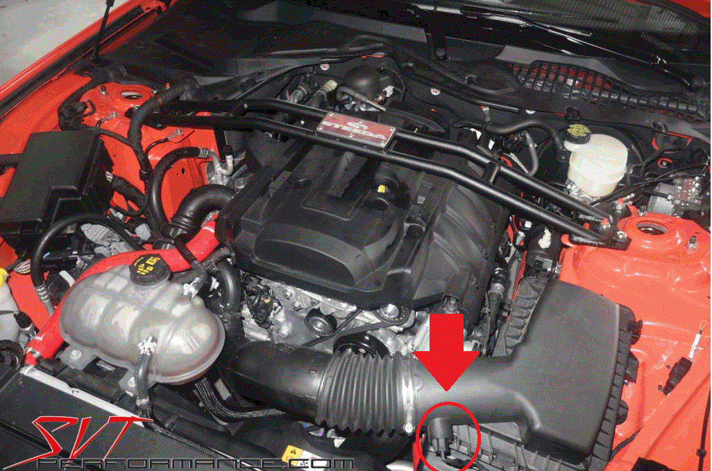

I am in the process of going back and forth with email tuning. It's been one issue after another and my tuner has been awesome in helping correct some of the issues. The most recent issue that I do need help with is the temp reading from the Intake Air Temp sensor. First off where is it located? I ask because I wanted to verify nothing was damaged or affecting the temps. Even with my MAP IC my temps have been pretty high during the summer months and with this cold blast we currently have in TX my temps are no where I thought they would be. Driving on the highway in 55 degree weather generates IAT temps about 10 degrees above ambient. If I drive long enough in the highway, it will go down as low as 6 degrees above ambient but never quite gets to ambient. With these temps it's not such a big deal but when it's warmer say 85, the IAT temps will be 15-20 degrees above ambient while driving normally. None of these temps are obtained during any kind of spirited driving.
I recently cleaned my JLT intake air filter and reoiled per instructions without oversaturating about 6 weeks ago. My tuner turned off my secondary O2 sensor due to check engine light which came on after 6 months of having my catted MAP DP. Double checked sensor wiring and no issues found. Other than the occasional silicone hot side piping popping off when i go into full boost, There are no other issues than i can think of that would/might/could affect anything.
As i stated in the beginning I would like to check the IAT sensor to make sure it's not damaged/or not correctly installed. Other than that I'm at a loss as to what could be causing the temps to stay so high. Another example was the other night it was 49 degrees ambient and my IAT temps were at 71 degrees.
