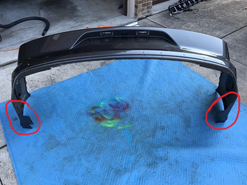

The piece that i circled below.
I just pushed the pins through both the bumper and the new valance pieces. Might have been easier if I removed them but I was concerned that it would put extra stress on the 3M tape holding the side wings to the bumper and it may eventually pull away...then you have a flapping cover in the wind.

Where did you start cutting? Do you cut below the lip?
OrangCrush
Jun 26, 2016
300
2015 Mustang GT Auto 3.55 - X pipe,Roush axleback
Anyone?
OrangCrush
Jun 26, 2016
300
Going to attempt this weekend. Will the dremel 100 series do the job?
