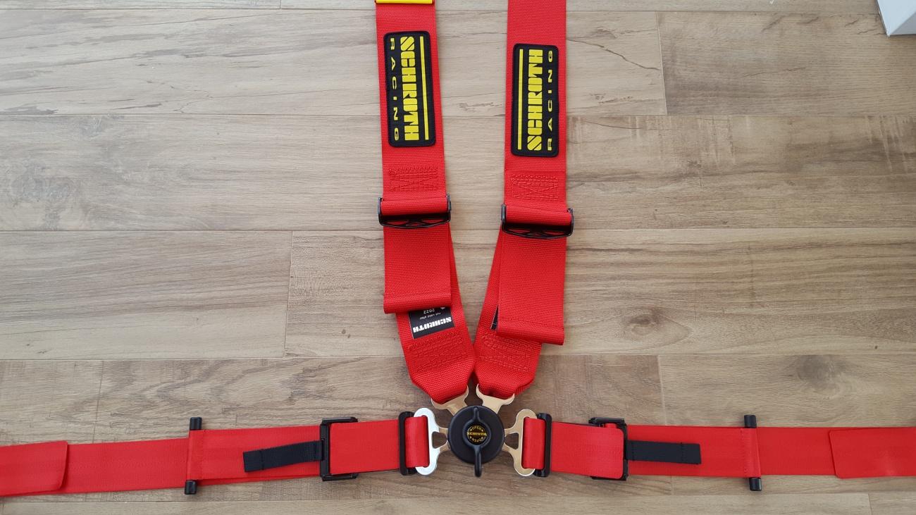

I said enough is enough to the analysis paralysis, so today I pulled the trigger on the Schroth 4pt Profi II ASM for both driver and passenger as well as the SHR Flex HANS.
I spoke with Mark at Schroth this AM to finally settle my concerns over a harness to be used with factory front seats in conjunction with a Watson 4 pt roll cage. As I mentioned in an earlier post, I knew that I was unable to mount a 5 or 6 point harness to the factory seat correctly. It was brought to my attention that the 4 pt Profi II ASM could be adapted to a 5 or 6 pt in any instance should any particular track require it. Although not 100% correct, it is acceptable for any tech inspection.
There are two versions of the Profi II ASM, one is the competition model and the other is the street legal version.
The competition model as seen below is the one that I ordered. The differences are the release style and the clips as opposed to bolt in eyelets for the Profi II ASM FE.
The Profi II ASM that I ordered (mine was ordered in red)
The Profi II ASM FE (street legal version -note the push button release and bolt in belt eyelets)

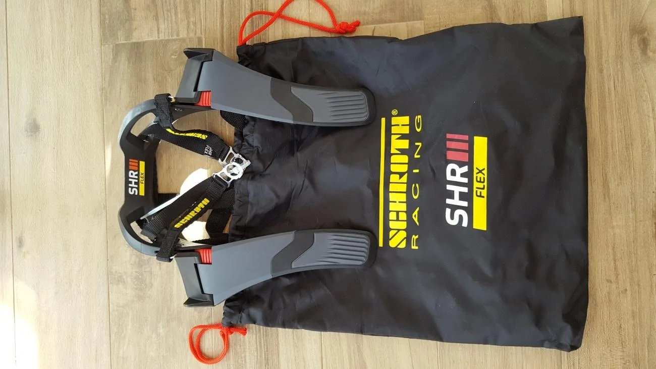

The SHR Flex Hans style device

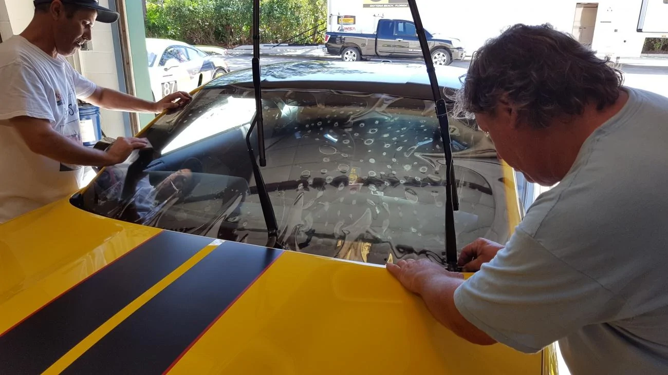

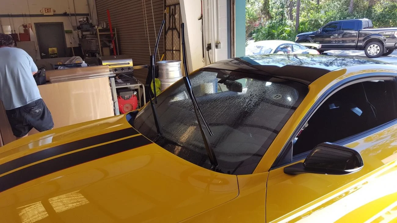

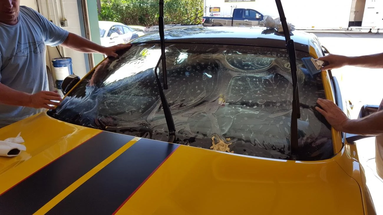

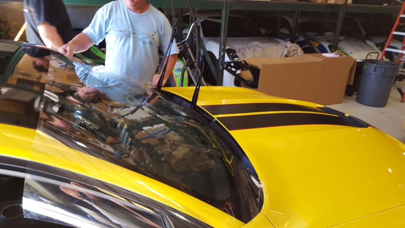

I had been inquiring about windshield protection for quite some time. Last year at Daytona, my windscreen was sandblasted and pitted and I vowed that next year, I would protect my windscreen. I came across a windshield protection film company that specializes in track cars.
http://racetearoffs.com/
Carl, the owner of the southern division, was here in my local area today helping out some of the folks over at BGB. I stopped by the local shop where he was doing work to have my 2 layer windscreen protection installed. The two layers provide 8 mil protection and after the next track event, the outer layer will be peeled off and another outer layer put down.
It started with a good windshield cleaning
Then the bottom layer was cut to fit.
Then it was installed
And then a second layer (tear off layer) was installed
Pretty incredible stuff. NASCAR has been using the peel off windshield protection for quite some time. I know that after last year, and the damage the windscreen suffered, I decided that something like this was necessary.

Absolutely, the principle is the same. I guess the big difference is that this system is designed for track/race use. The tear away feature of the outer 4 mil layer provides a disposable layer while keeping the base 4 mil layer for absolute protection.
To give you an idea, I wrapped the entire front end in road wrap last year. I believe road wrap is 2.5 mil. The debris from the track, over three days, eventually left some damage. The windscreen had pitting all over it as well as a small spider crack. 2 layers and 8 mil of protection should eliminate any windscreen issues this year.

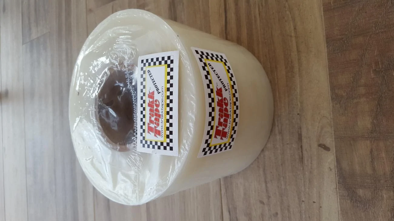

As for the paint protection, I ordered a roll of Trakk Tape a while back. The car is already PPF'd. I believe Xpel is 8 mil thick. The Trakk Tape gives another 5mil layer of protection. That in conjunction with the PPF, there should be no issues with sand blasting this year ;)

Yes, the wiper was a concern. I wound up turning the wipers on to get them in the top position and then quickly turning the power off to set them in place. A lot easier than removing the wiper IMHO. When they were done, powered up the car and the wiper blades were guided down.

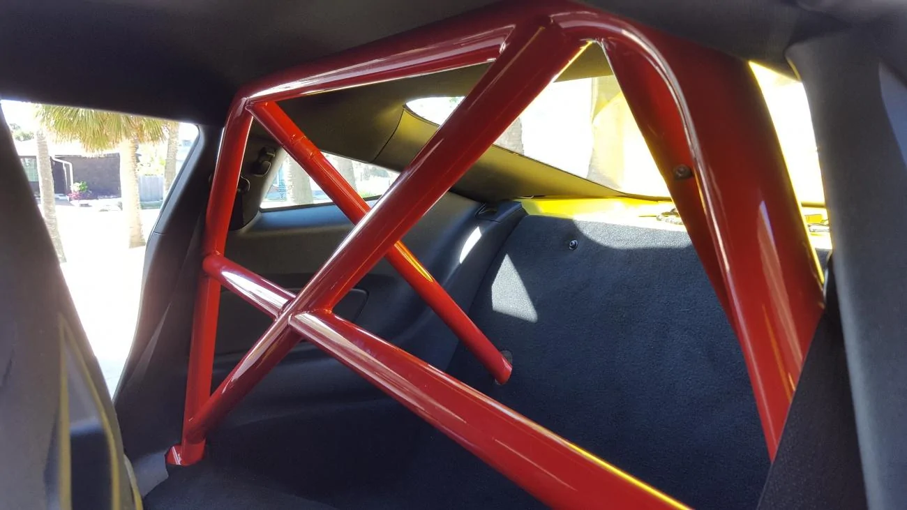

Today, I finalized the installation of a Watson 4 point roll cage into HR361. The full install notes can be found here..... http://www.mustang6g.com/forums/showthread.php?p=2046986#post2046986
The Good:
My initial impressions are that the car feels more rigid.
I feel the car is safer. I plan to install a 4 point harness and use a HANS for the track
The Bad:
The Car now weights 60 pounds more. That carbon fiber drive shaft is looking better and better. The cost of safety.......

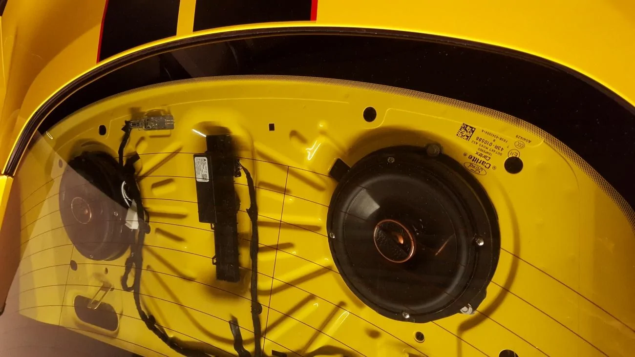

While I had the whole rear of the interior apart, I decided to replace the CRAP factory rear speakers with Harman infinity REF6522IX 180W reference speakers. The speakers pictured below in the box are for the doors, which will be another update down the road.....
All I can say is Wow! what a difference in the sound.
I first got the idea from reading a post by [MENTION=25907]torque124[/MENTION] http://www.mustang6g.com/forums/showthread.php?t=80057 . All of his suggestions were spot on. Everything from the speakers, to the wiring adapters, to the housing adapters made the job a lot easier than without.

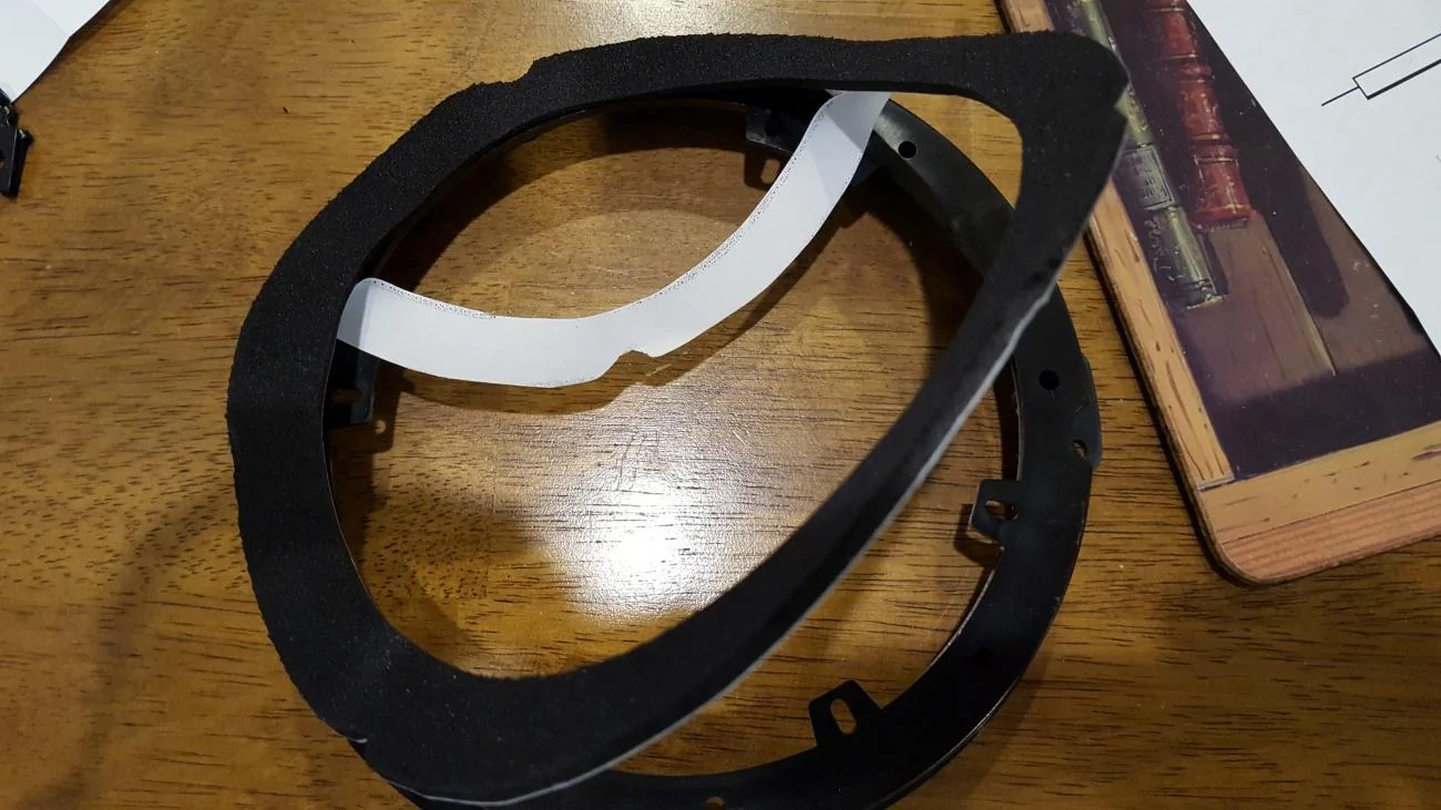

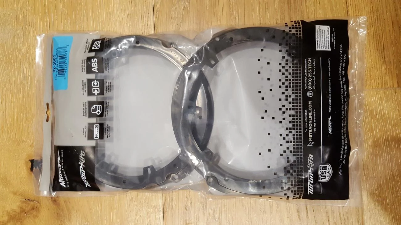

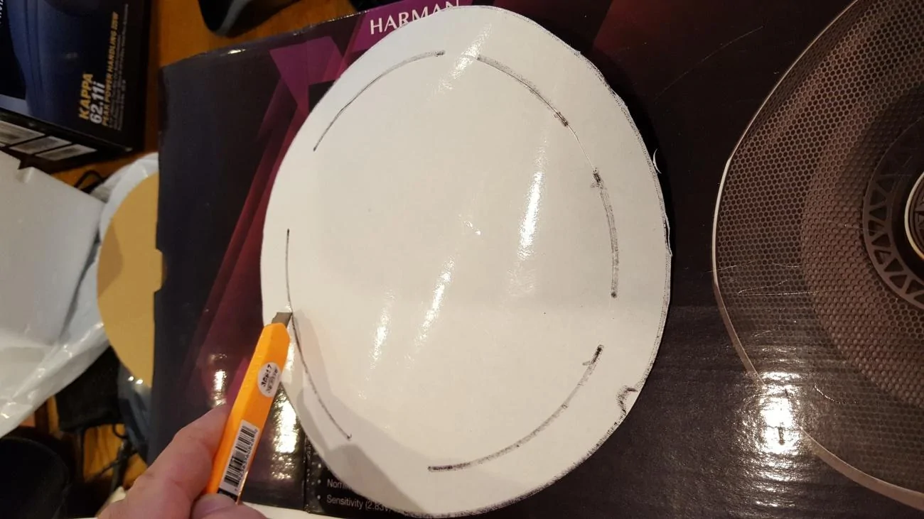

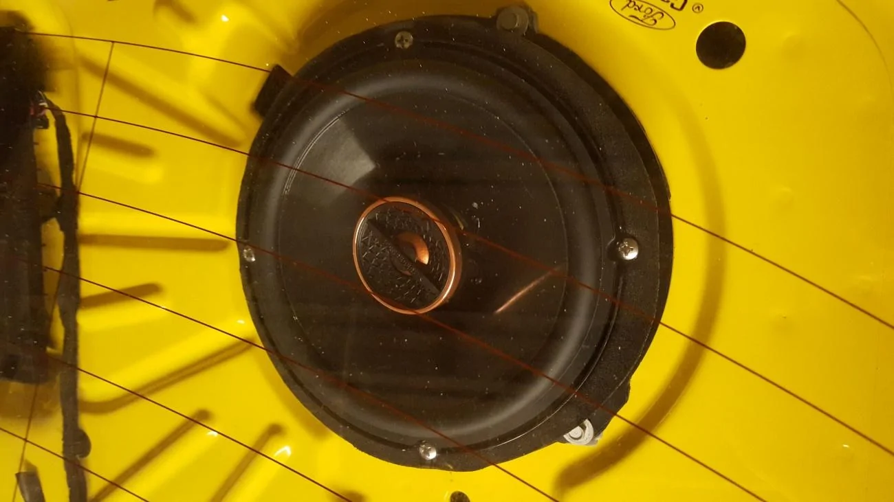

I had some adhesive neoprene laying around and decided to use it in lieu of the weather stripping that was provided with the speakers. I cut it to size to adhere to the adapter housing (4 hole industry standard speaker to a 3 hole ford proprietary mount).
The adapters are pretty decent quality. They appear to be very similar to the mount that the factory speaker sit upon from the OEM assembly

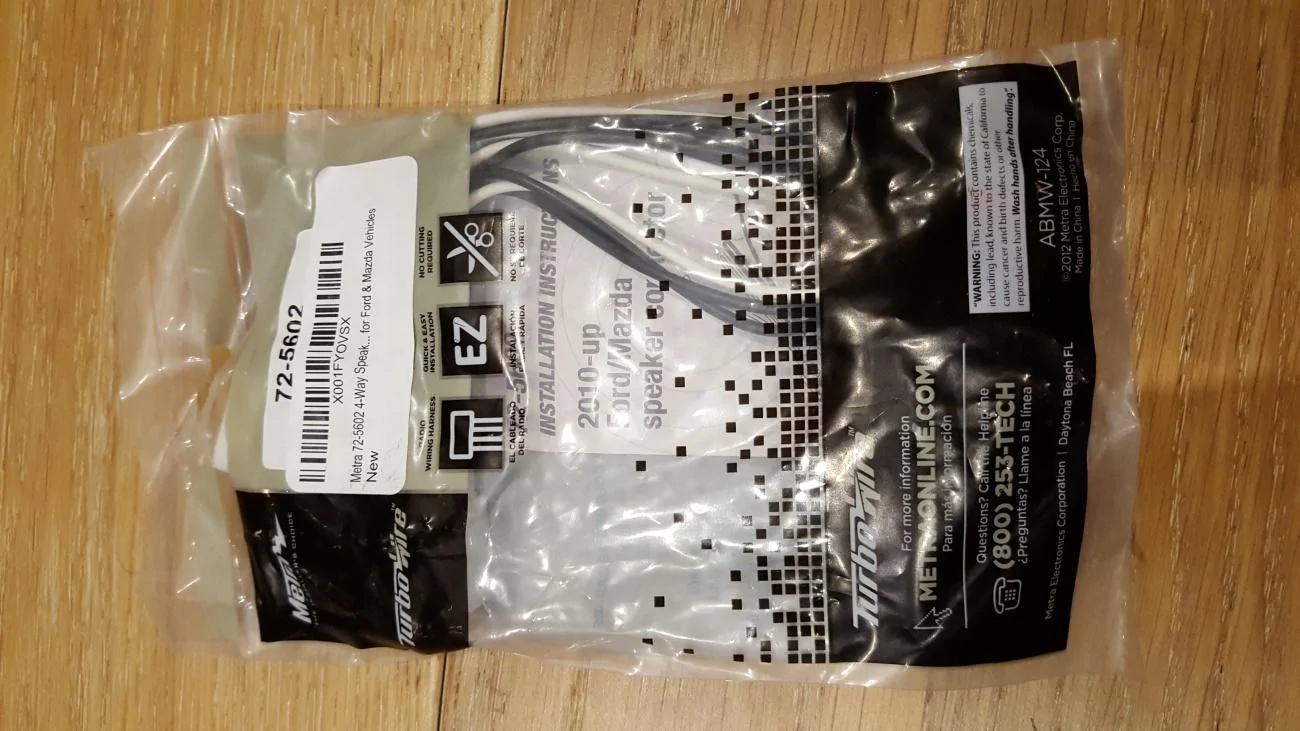

Who wants to mess around with cutting and splicing wires from factory harnesses to add aftermarket speakers? Metra (who also makes the housing adapters) makes a wiring harness adapter to simplify the installation
The result is a installation that was not only easy, but sounds excellent!
I couldn't believe the difference in the sound...... Yes, I know its a track car, but man oh man, if you are going to have the speakers installed with a stereo, why not improve the quality exponentially with just a very modest investment? Thanks again torque124 :cheers:
