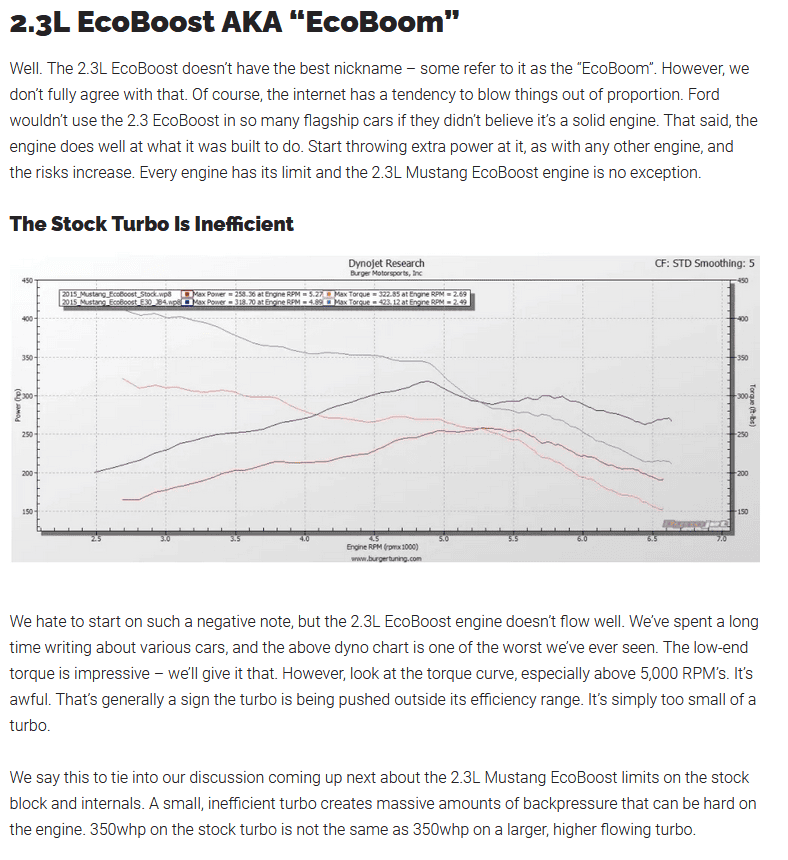

I don't know what you're on about anymore lol, I don't think anyone disagrees there are short comings on the platform is the stock IC inadequate yes, is the downpipe little restrictive seems to be, could the stock turbo be bigger yes. Talking about the engine will just be going in circles again your providing anecdotal accounts as proof from forum/s like it's proof or something new, but I think torqueman elaborated on the matter well.
I don't know many manufacturers that give a lot of leeway on a high strung boosted 4 cylinder engine out the gate, Il give you Subaru for example their FA20 WRX can barely go above 300-350HP reliably is everyone making unreliable engines cause it can't do above 350hp, I don't understand your argument logically sensible. You say the 2.7 3.5 are fine, these are not being applied to cheaper sport cars like these and people with trucks are not tunning and sporting like you would in bigger numbers, its a truck after all. Also the bigger the displacement the bigger headroom for gains that's common sense such as the coyote it's NA 5.0 litters to work with already at 450+ you think it's a surprise when going FI you get big gains? How would that translate to over engineering? it's a bigo V8 NA, Let's put this in perspective to make better sense if it came out the factory boosted lets say @650 all of a sudden your bigger gains % gap shortens from internal stock tuning potential would that make it flawed engine because you can't do 1000hp out the gate? It's all a money problem always.
public relations wth are you talking about now lol? This article was from tuningpro.co they list a lot of engines some of which they say negative things about you should check it out you might learn a few things. Here is another piece on the 2.3 a lot of which you might agree with and anyone else that wants to check it out. https://tuningpro.co/best-ford-mustang-2-3l-ecoboost-bolt-on-performance-mods/
