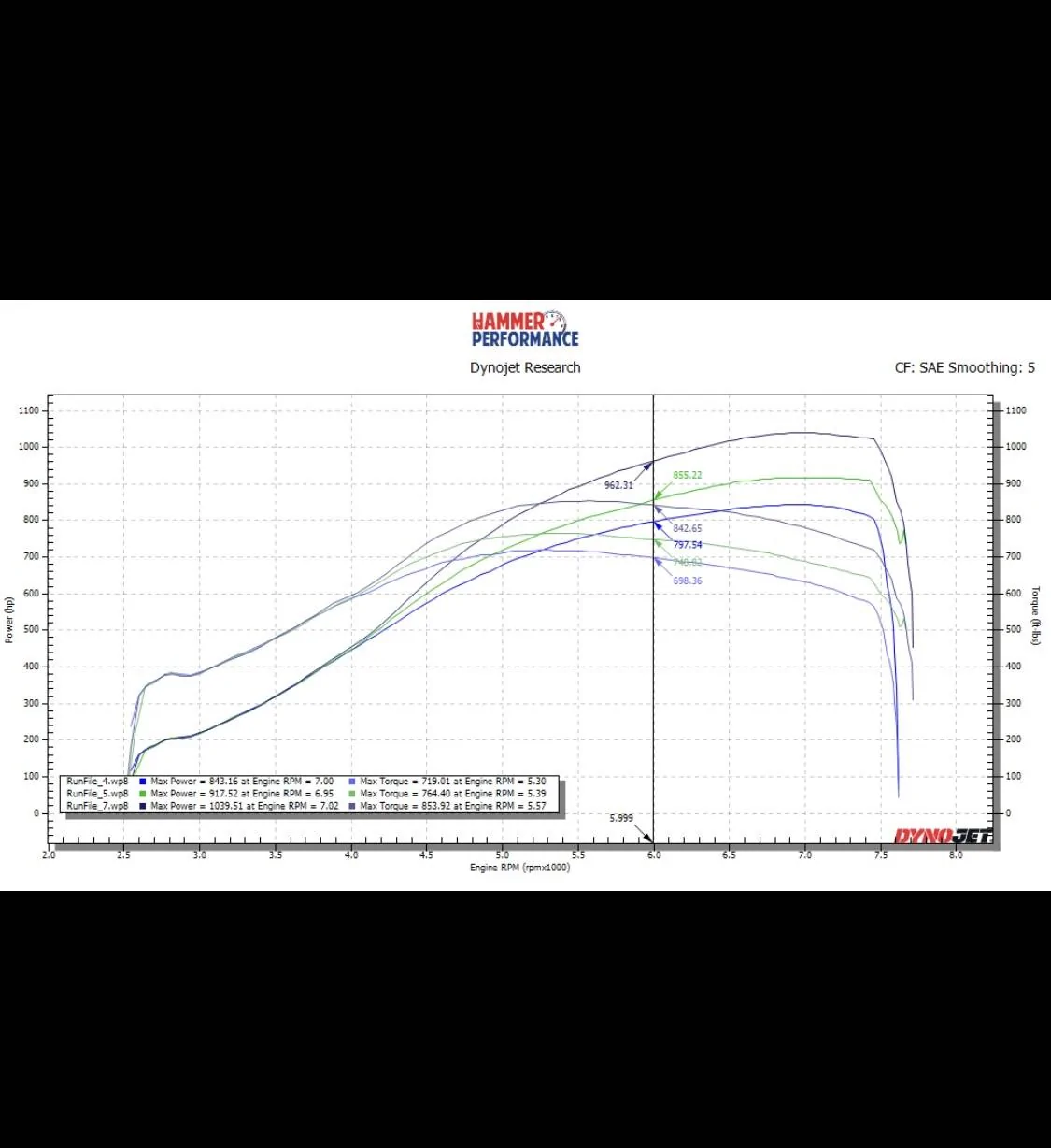

Hey everyone so after looking at Brad's 60-130 thread and seeing how you are able to do estimated whp calculations based off the logs, I am now curious to see if my dyno numbers and logs match. I have always felt my numbers are a bit high compared to the norm for boosted 5.0s. I do understand turbos are more efficient but still think they're a bit high. I will post my dyno graph as well. The three pulls on the graph were made on 9,11.5,and 14.8 psi.
The car has a Hellion TT kit with Precision 6266 BB turbos, Division X fuel system , and a Eboost 2 controller controlling boost. I have the settings on 8,10,12, and 14.8 psi. I have recently been fighting some traction problems ever since removing some weight from the rear (removed Corsa mufflers and put in lighter seats with a rear seat delete) so that is slowing me down some on my 60-130 times. I usually make the hit on 8psi and bump it up as soon as I feel the car is stable enough. The car's pb 60-130 on these settings is 4.55 and the DA was around 4300ft that day with 50 degree weather. Car definitely feels strong. I have a couple logs from last night that I can email to anyone and dragy slips that I can post as well. Just curious to see what everyone thinks.
