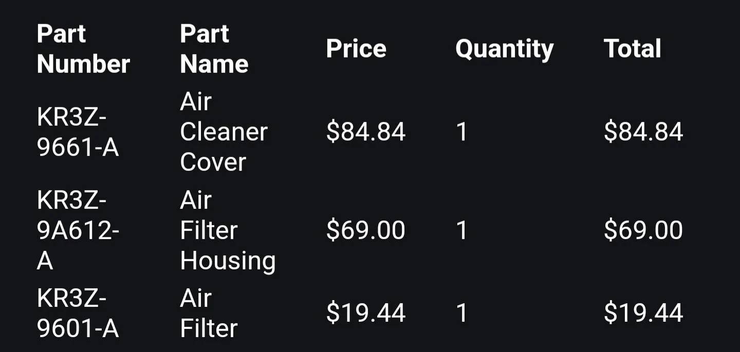

When you mention the brake aspirator tube is it just the 90* connection or did they change it up again?I thought I would drop a review here for anyone that does not want to dig through 175 pages who is maybe looking for recent information on this kit. I have a 2020 GT A10 that I bought used with only having exhaust on it. Steeda H and little bullet muffles (Loud - borderline too loud). I drove the car stock for a bit, it had 18k on the clock when I got it in 2021. was not pleased with the shifting and decided to get a throttle position enhancer. There was a deal here via Solar. I used that until I pulled the trigger on this kit in November. Installed it over Xmas holiday.
