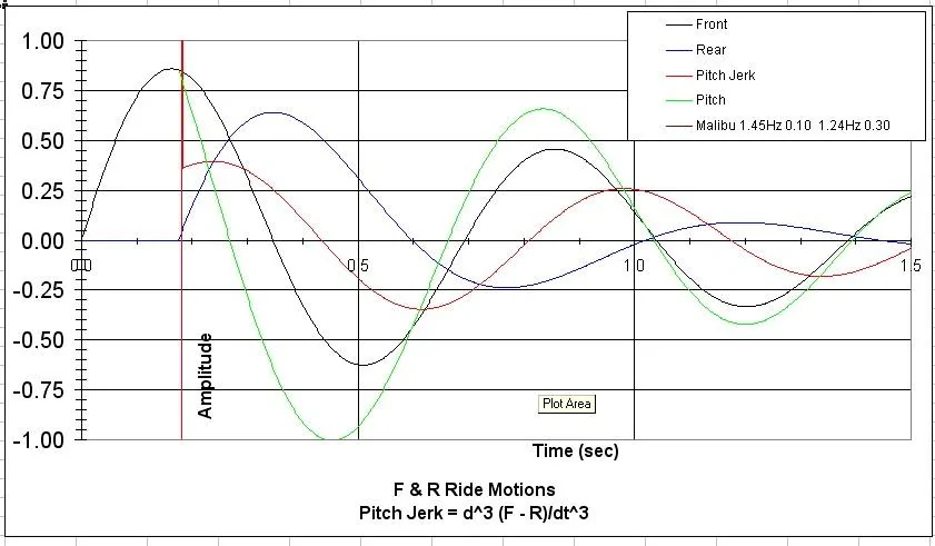

Some years ago I put these flat-ride plots together for a 3500-ish lb 108" wheelbase car. These and similar ones have been used as illustrations here and there.
Rear ride frequency 1.17 x front ride frequency, not too far above the 1.10 factor that's commonly referenced. 10% critical damping - think worn-out shocks/struts. Lots of motion, but the pitch (front displacement minus rear displacement) dies out fairly quickly. Perhaps more importantly, pitch jerk (think in terms of front-to-back head toss where lack of being constant means it's harder to keep your neck muscles "in sync" with the pitch.

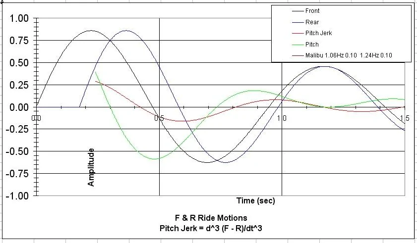

Here's a badly mis-matched frequency set with the front ride frequency higher than the rear. Let's also give it worn out front shocks and OE-replacement-ish rear shocks. Lots more pitch jerk, and the vibrations are slow to decay.

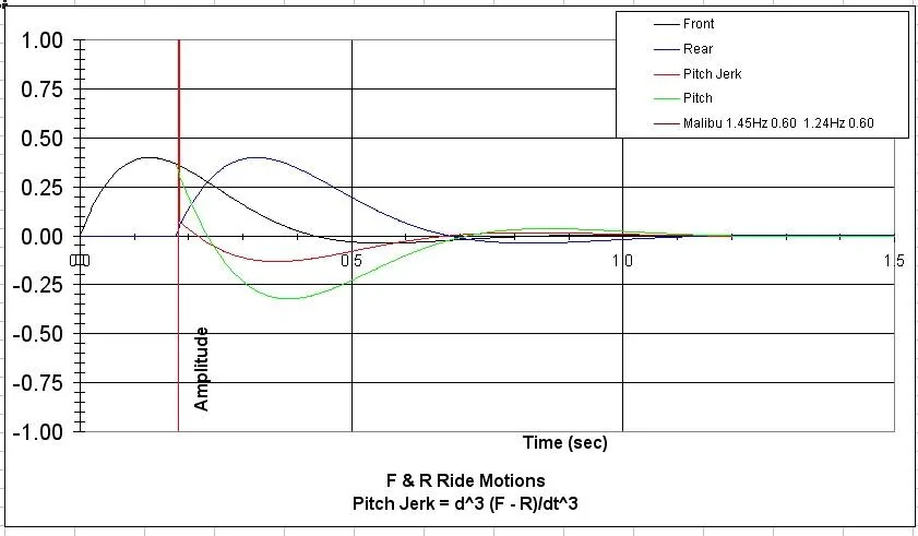

But let's take the above example and throw a lot more damping at it. It'll ride pretty firm, maybe even 'hard'. But the vibrations and the pitch/pitch jerk decay very rapidly. The first half-cycle or so is always a "bust"; not much you can do about it when the front is moving and the rear has no more than just gotten started.
