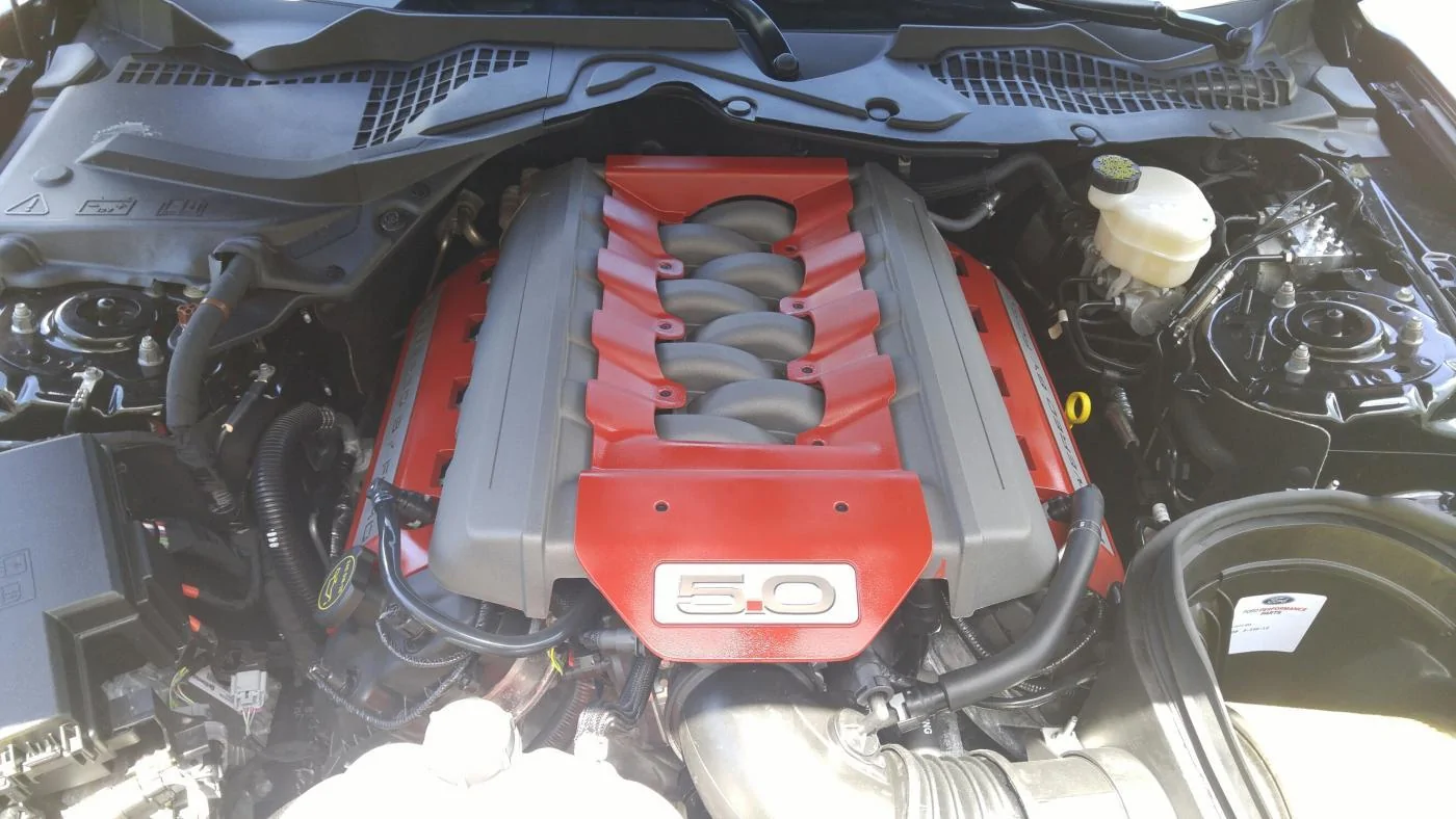

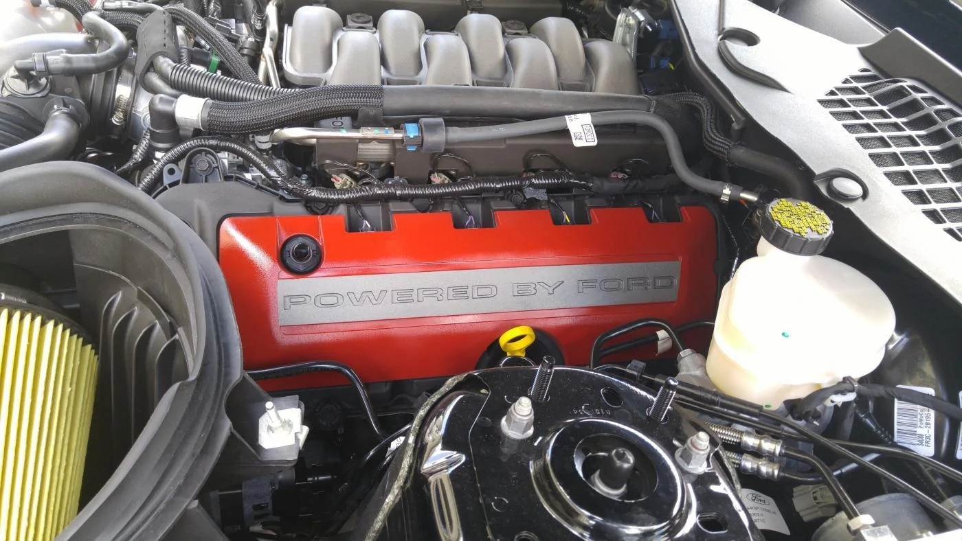

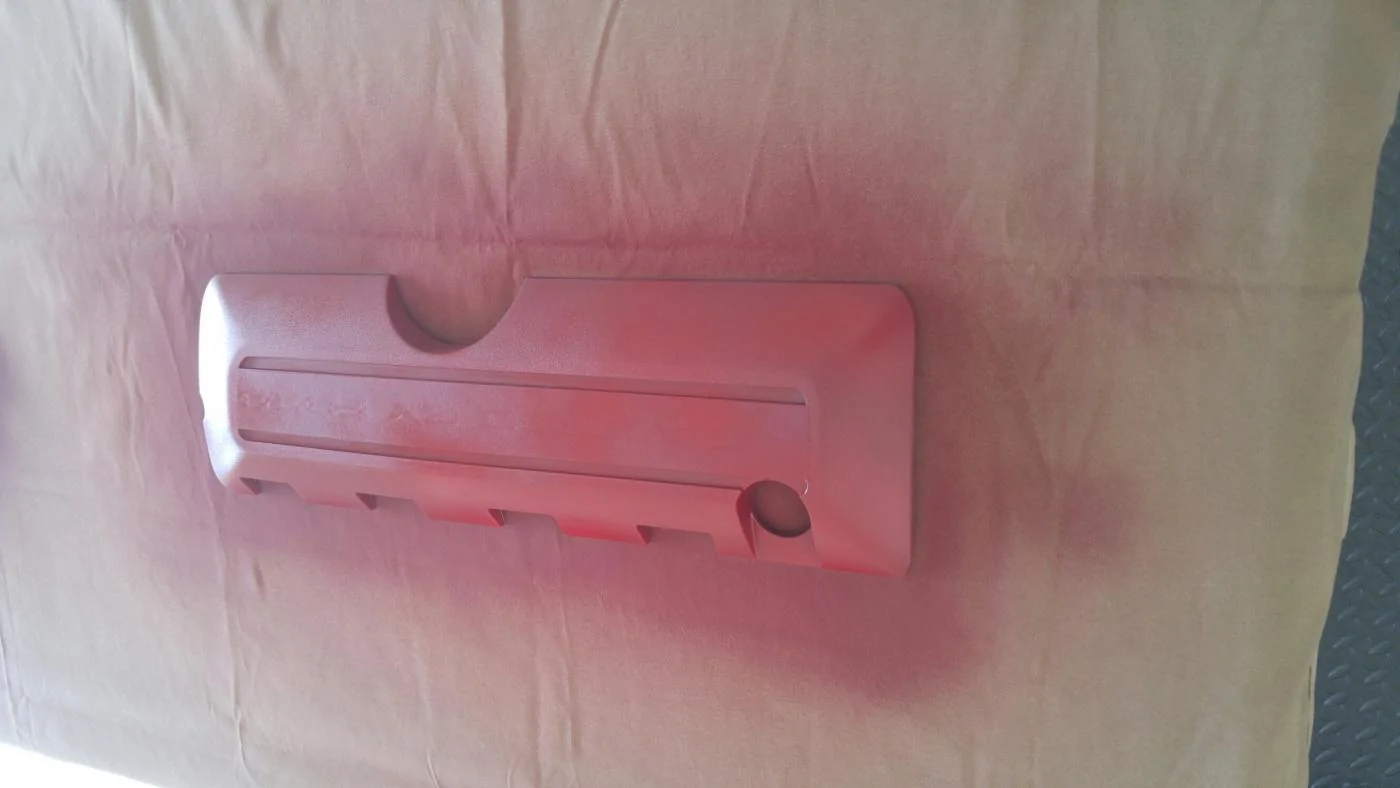

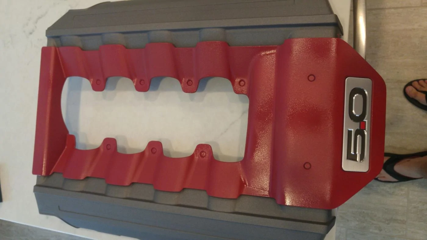

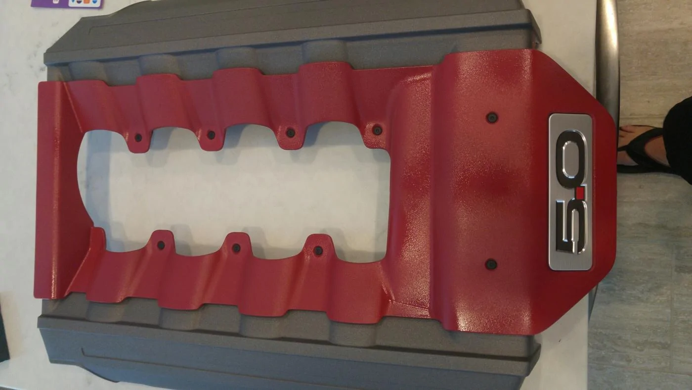

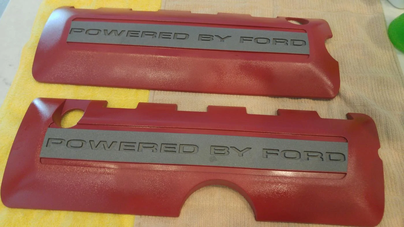

Paint process:
Remove injector overs from car

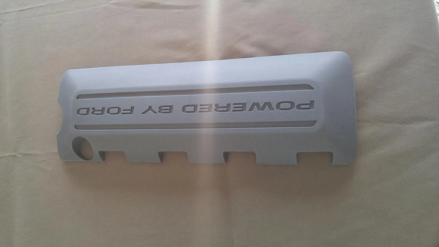

Wash with mild soap and water

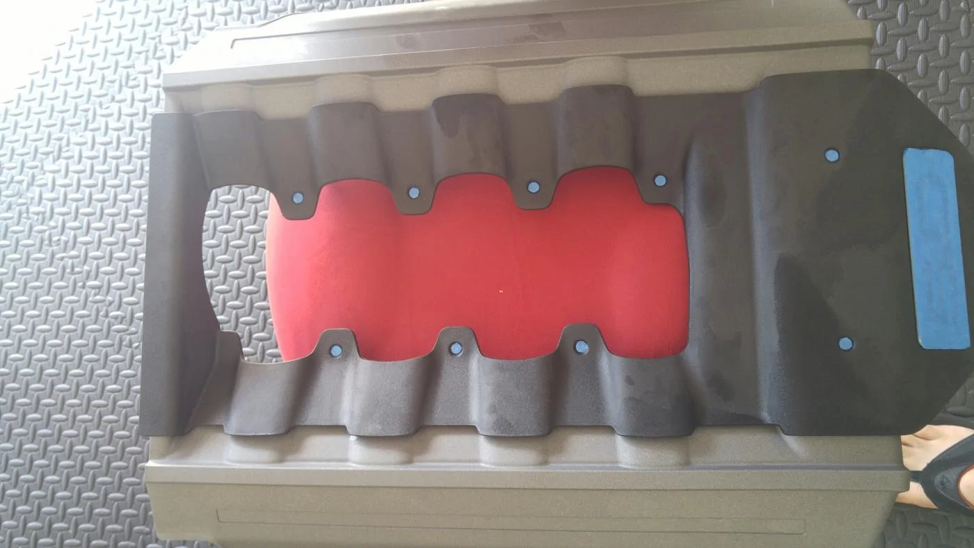

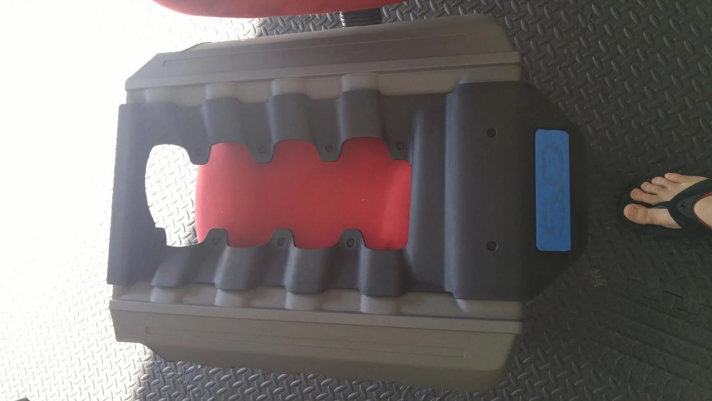

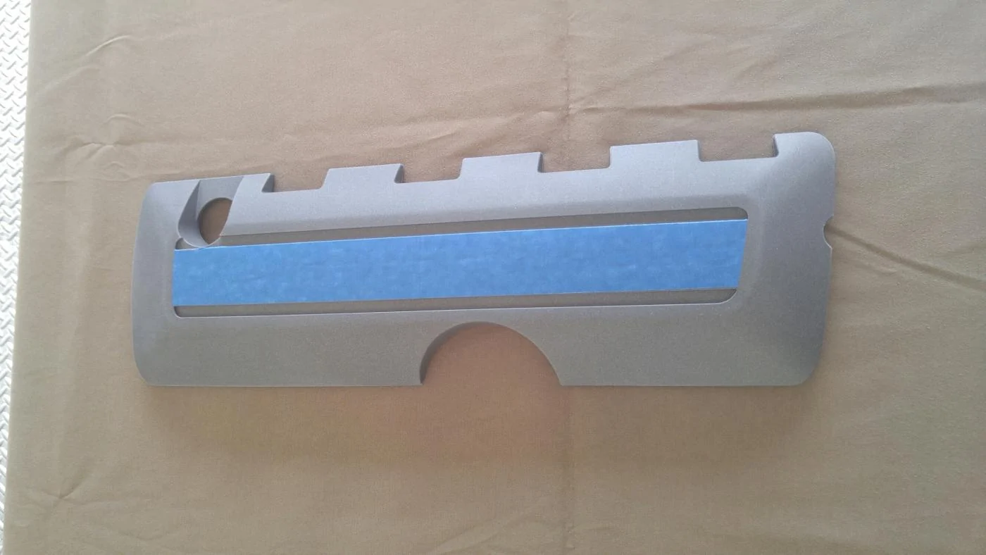

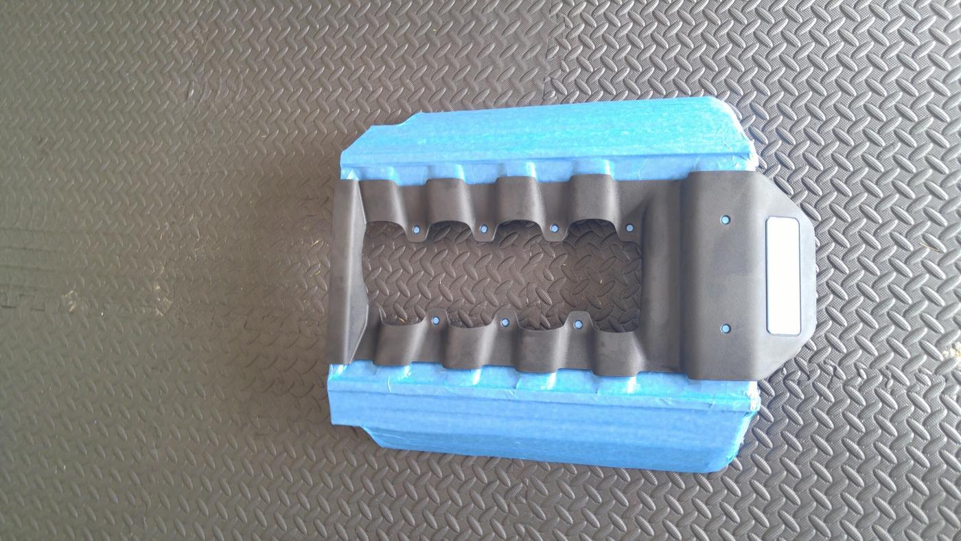

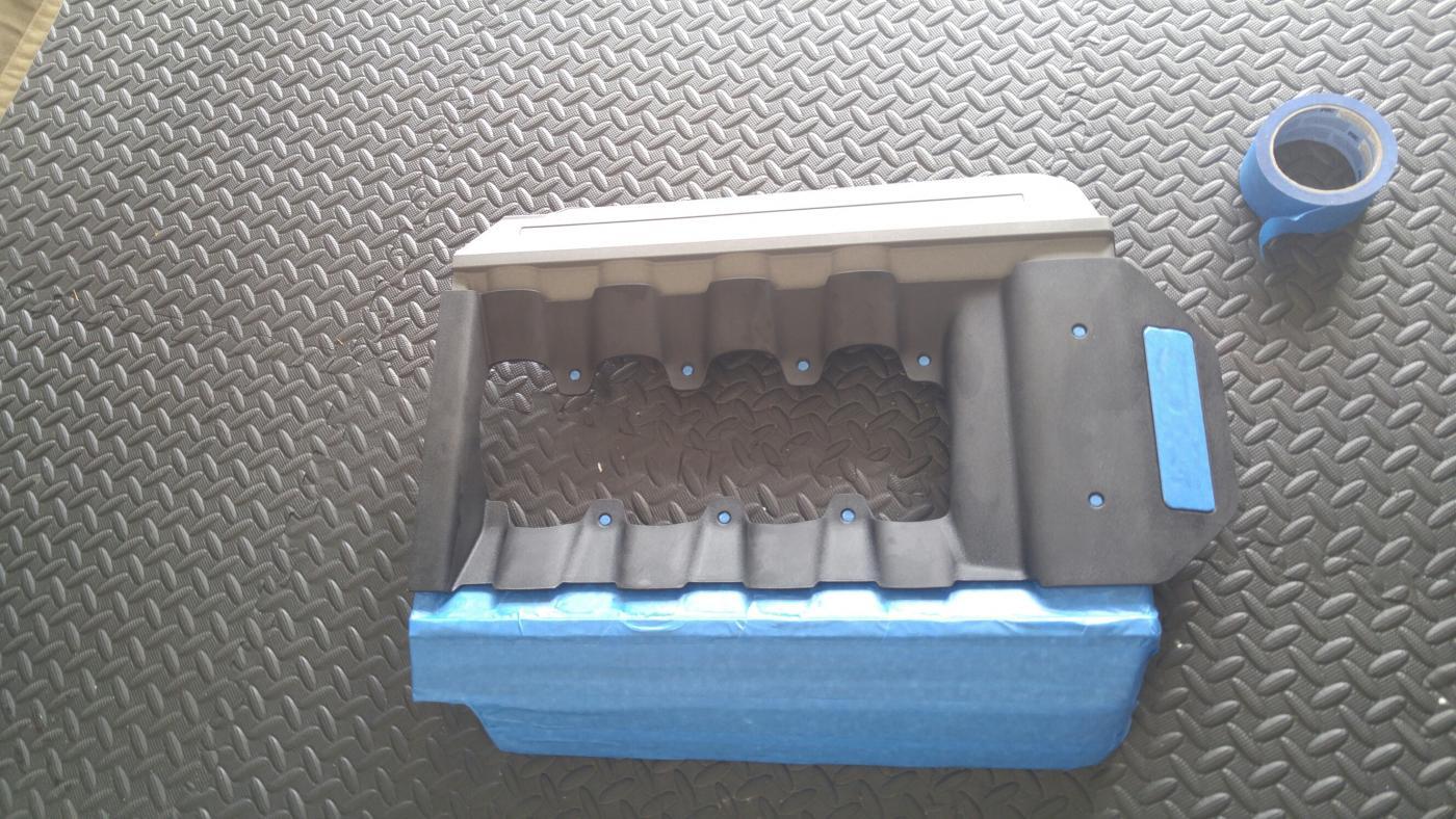

use 600 grit sand paper and lightly rough up all of the cover except the middle that is taped on figure 2
apply painters tape through middle of each cover
use sharp blade to cut the tape in line with rivets on each cover, ensure the 2 long recessed lines are not covered
make sure surface is dry before applying tape
apply Engine enamel of choice, 3 coats 10 minutes apart at 6-8 inches away light mist
allow to dry 30 min
apply 3 engine enamel clear coats 10 min apart, I used ultra high temp paint
allow 3 hours to dry
remove painters tape
reinstall cover to car
