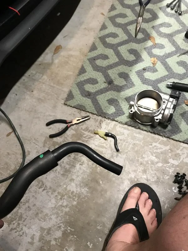

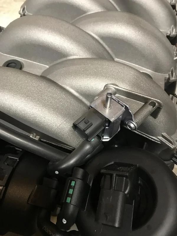

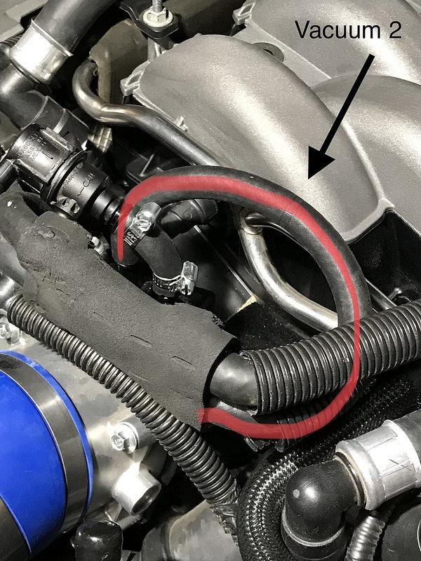

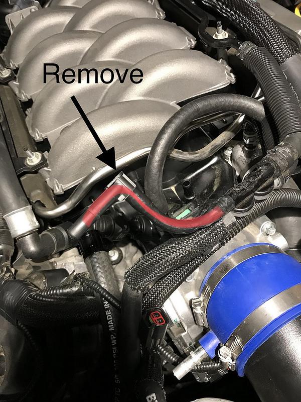

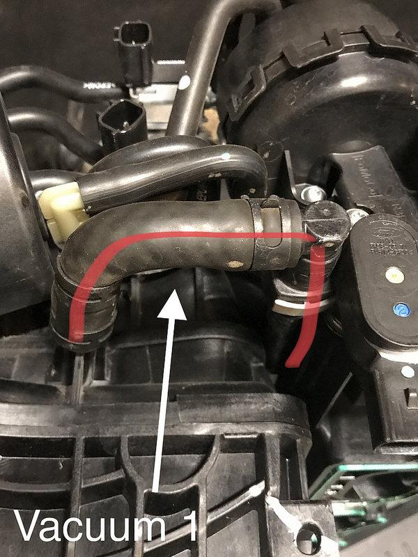

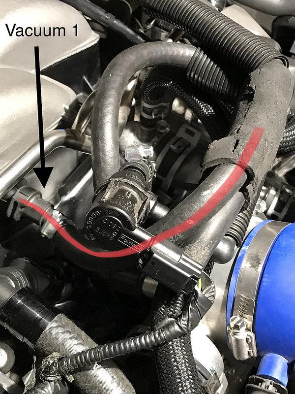

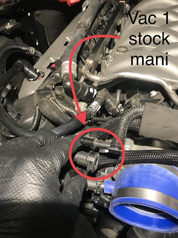

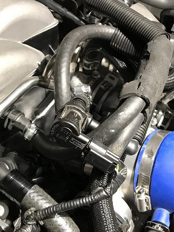

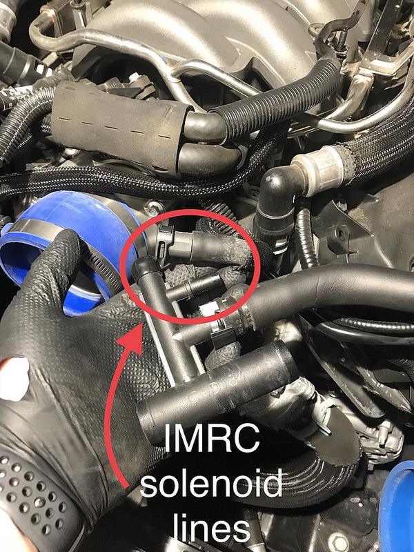

Decided to clean up the vacuum lines a bit. Here you can see I used the former IMRC vacuum port that goes through the intake manifold as the new spot for the brake booster vacuum source.

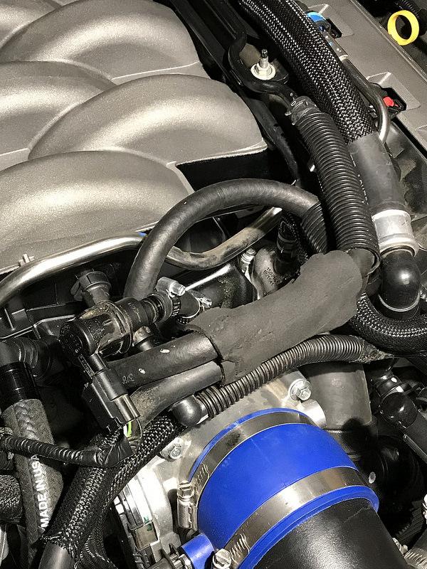

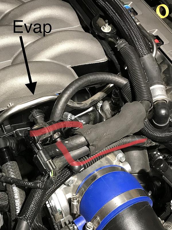

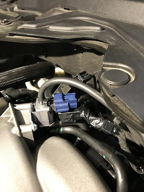

Also flipped the aspirator left to right to make the install cleaner.
