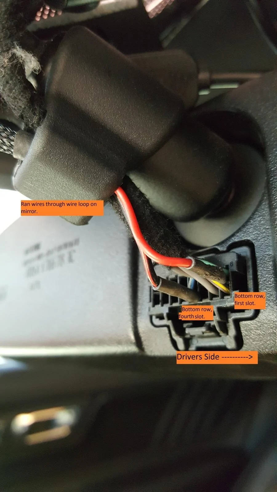

My dash cam got knocked away from the windshield mirror. The two power wires were pulled out of the mirror sockets. I cannot find the Forum discussions on using the mirror for dash cam power.
Which sockets on the mirror are used for ground and switched power leads?
