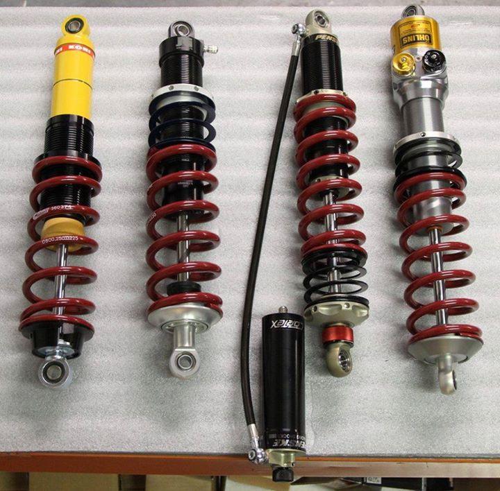

For all the 2015 Mustang early buyers out there: What would be your damper of choice for the rear IRS of the new 2015 Mustang if you took cost vs value into consideration? Prices are approximate and include springs, mounts, and applicable hardware for a pair of rear shocks. Naturally, matching front struts are available. The line up we are offering is:
For me, anything Linear and non-progressive. Those Ohlins look nice but one I'm definitely not looking to spend that kind of money unless i get more into tracking the stang, two they look progressive. Although they look a little different than most progressive setups i've seen. More of a dual spring set-up to achieve the same goal vs a real progressive spring. Then again I've been out of the coil-over/suspension market for a few years now.

By the very definition of coil over, McPherson struts with the coil spring over the strut body are considered coilovers. The aftermarket has co-opted the term to mean any adjustable spring perch utilizing a common 2.5", 2.25", or 60mm spring inner diameter. Filip is going to make strut bodies for the S550 with adjustable spring perches just like he did for the S197 chassis and the Fox/SN95 chassis.I don't think you can see a progressive spring with your eyes. The Ohlins dual spring isn't necessarily two different rates. The smaller helper spring is merely there to maintain preload during droop. KW setups usually have the same thing.

Spring location relative to the shock should have some consideration given. Pairing the two together ensures that they see the same amount of force which makes the damper better at doing it's job. Given how far out the damper is on the S550 it improves the spring motion ratio which reduces the necessary spring rate to accomplish the job. The expense is inboard wheel/tire room but from what I've heard the S550 has plenty of room out back for some rather large wheels and tires.
