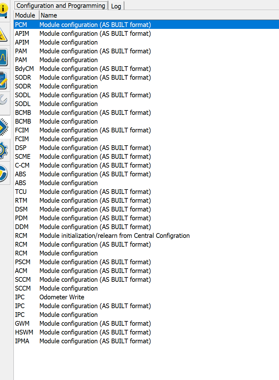

You'll absolutely get a DTC if you don't follow the instructions and do a PCM relearn after setting the size in the BCM.
Ive never done a PCM relearn, thats a setting on the forescan though correct? so if I change the value, then click PCM relearn, = no issues? if this is correct, im game later. I will get my value GPS though as ive done same thing for my motorcycles and their calibrator offset program devices. I make it like 99.9% accurate with the .01 % more so its like 69.5mph at 70mph cruise.
theres no consequences though from relearning PCM or anything dumb right? gimp/blow/boom.
I am pretty sure everything should be reversible regardless.
It's a procedure you run in FORscan, not a setting.

Resurrecting this. Using the one linked in the OP with the USB cable. Tried today again to relearn as I had to clear a code and saw it was still there from the first time edited over a year ago and couldn’t do a PCM relearn. Updated to the latest forscan, OBDLinkEX, still doesn’t give me the relearn option.

You've got the best adapter available IMO. It's possible the PCM relearn isn't available through FORscan on your model year yet. Anyone else with a 2021, feel free to chime in.

I have a 2023 GT and I performed the BCM edits like you said, but as with others I do not have the option for a relearn. It did seem to work tho, as my speedometer is dead nuts accurate now. The only DTC's I have are for my tpms since I haven't had a chance to get my new wheels learned.
