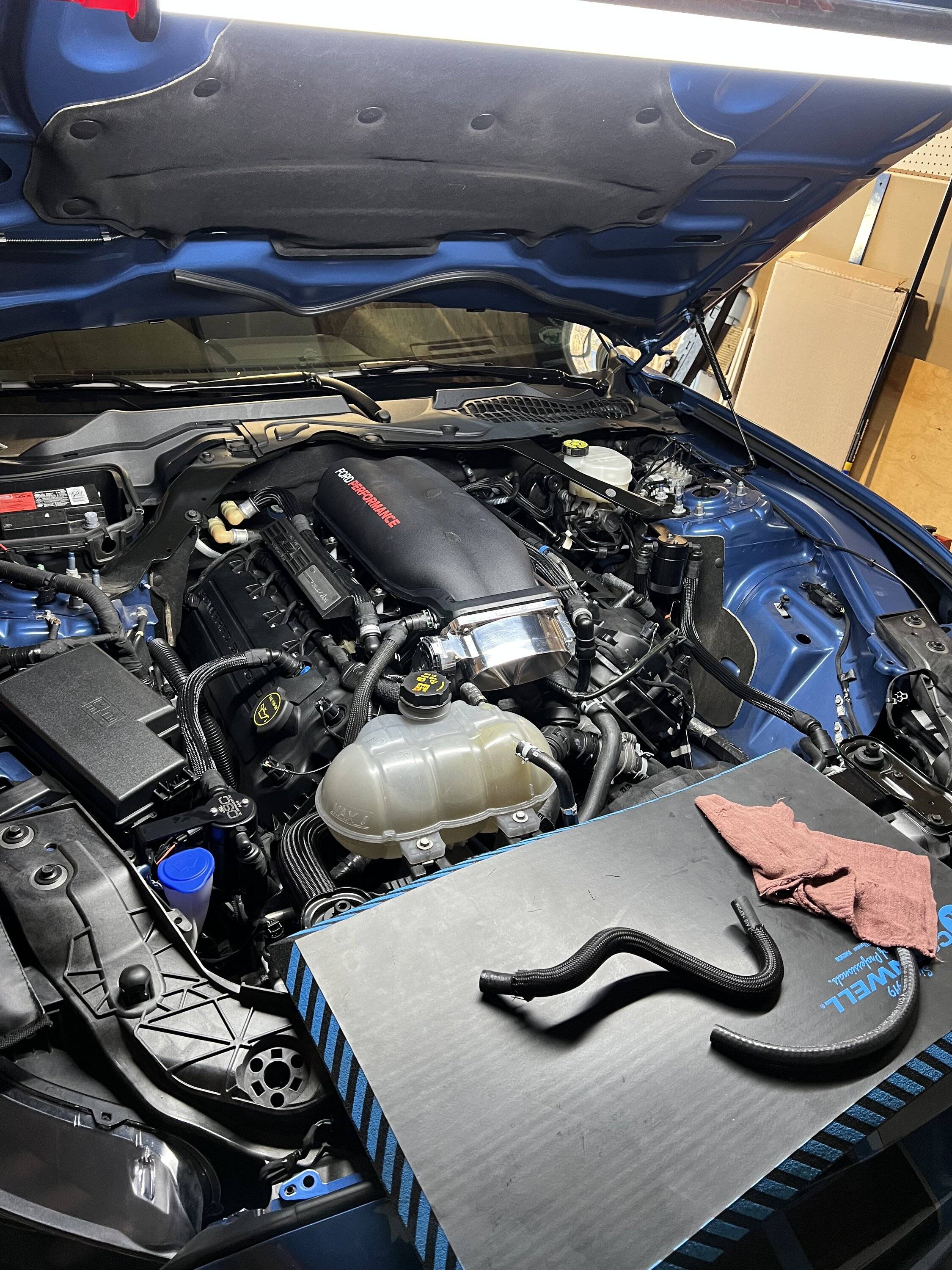

Well I put the Cobrajet setup on the dyno and it did not disappoint! 540whp/460TQ SAE. Shop temp was in the upper 70’s down here in southern Florida. Pull was in 5th gear 1:1.
Really great power for bolt on parts and tuning.
Mods are:
Lund E85R tune
unported Cobrajet intake manifold
VMP 137 Monoblade TB
PMAS CJ intake utilizing stock air box
Corsa Catless longtubes
Stock resonated cat back

I know this thread is older. But has anyone used a new gen 2 CJ intake on the GT350? Im hoping lowering the motor with the BMR brackets is enough to clear. If not, what else could we do other than trimming the hood? Thats a last resort thing for me.
Steed engine mounts lower it a lot. I did bmr k member and steeda lowering mounts and did not have to cut hood
Cool good to know, thanks! Wonder if I would clear without the K member. Although I kind of want the BMR K member anyways lol

I am in the process of doing that right now. Just waiting on cold air intake
how much did you lower it with the steeda mounts want to do this with my hellion 350 but dont want to lower the turbos anymore
i think it might with the bmr brackets and steeda mounts. i only did the k member because with the ehaders on, i couldnt get to the engine mounts without dropping the subframe and if im dropping im gonna replace it lol
i did the full 3/4 inch I believe. it uses spacers and i used none of them cuz i knew it was going to need all it could get.
that’s a good point… I didn’t think of that. I’ll have to check to see how much clearance these stainless works headers have with the steering shaft.
you might able to get to them with those headers cuz they route normal. I noticed with the kooks, they routed two runners in one direction and two in a different direction completely blocking access to starter and motor mounts. But a buddy got American racing and they routed together and everything was open
Cool good to know, thanks man. What bolt ons do you have? What TB? And is the CJ ported? Curious if you dyno what the power will be. Im hoping with full bolt ons on e85 to be right around 550whp.
