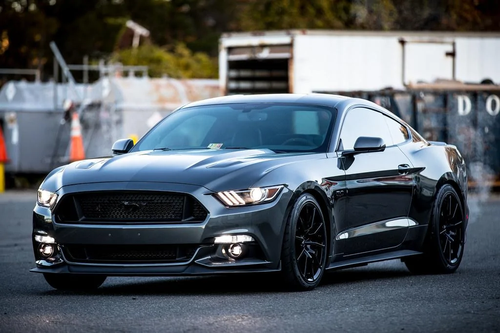

That's such a sweet stance. SOLD! I'm getting them.BMR Performance springs

SP082 Rears and SP089 Fronts will give you less than an inch.Which springs would offer less than an inch drop? I'm worried an inch might be too much for my 20" wheels. I'd like a .50 or .75 drop to go along with Ford Racing Track struts and shocks.
I have that combo and it dropped 0.75" in the front and 0.5" in the rear. Perfect height for daily driving.SP082 Rears and SP089 Fronts will give you less than an inch.
How would these springs handle on road courses assuming I pair it with the FR track suspension kit shocks/struts/sway bars? I feel like the 1" drop on the stock FR Track Springs are more than I want, so I'm leaning towards this BMR spring combo. .75 and .5 sound perfect for a daily driver/occasional track car.I have that combo and it dropped 0.75" in the front and 0.5" in the rear. Perfect height for daily driving.
I'm not really sure. I'm on PP shocks/struts with the BMR performance springs and everything feels great. I can't comment on the FR track pack since I have no experience with it.How would these springs handle on road courses assuming I pair it with the FR track suspension kit shocks/struts/sway bars? I feel like the 1" drop on the stock FR Track Springs are more than I want, so I'm leaning towards this BMR spring combo. .75 and .5 sound perfect for a daily driver/occasional track car.
The SP089 Front and SP082 Rears - work VERY well with the Ford Performance Track Components. :cheers:How would these springs handle on road courses assuming I pair it with the FR track suspension kit shocks/struts/sway bars? I feel like the 1" drop on the stock FR Track Springs are more than I want, so I'm leaning towards this BMR spring combo. .75 and .5 sound perfect for a daily driver/occasional track car.
Darn it. I went with the Handling Springs. What's their drop gonna be? I'm just looking for a better stance right now. Not slammed and not bottoming out.The SP089 Front and SP082 Rears - work VERY well with the Ford Performance Track Components. :cheers:
I think it 1.2 front and .5 rear. Should be fine from what I read. My buddys 13' is lowered 1.5in all around and looks sporty, not too low, and no rubbing. I like to have at least an inch clearance between the top of the tire and the fender, I think it looks better, it seems like anything around 1.2" or lower should offer that.Darn it. I went with the Handling Springs. What's their drop gonna be? I'm just looking for a better stance right now. Not slammed and not bottoming out.
