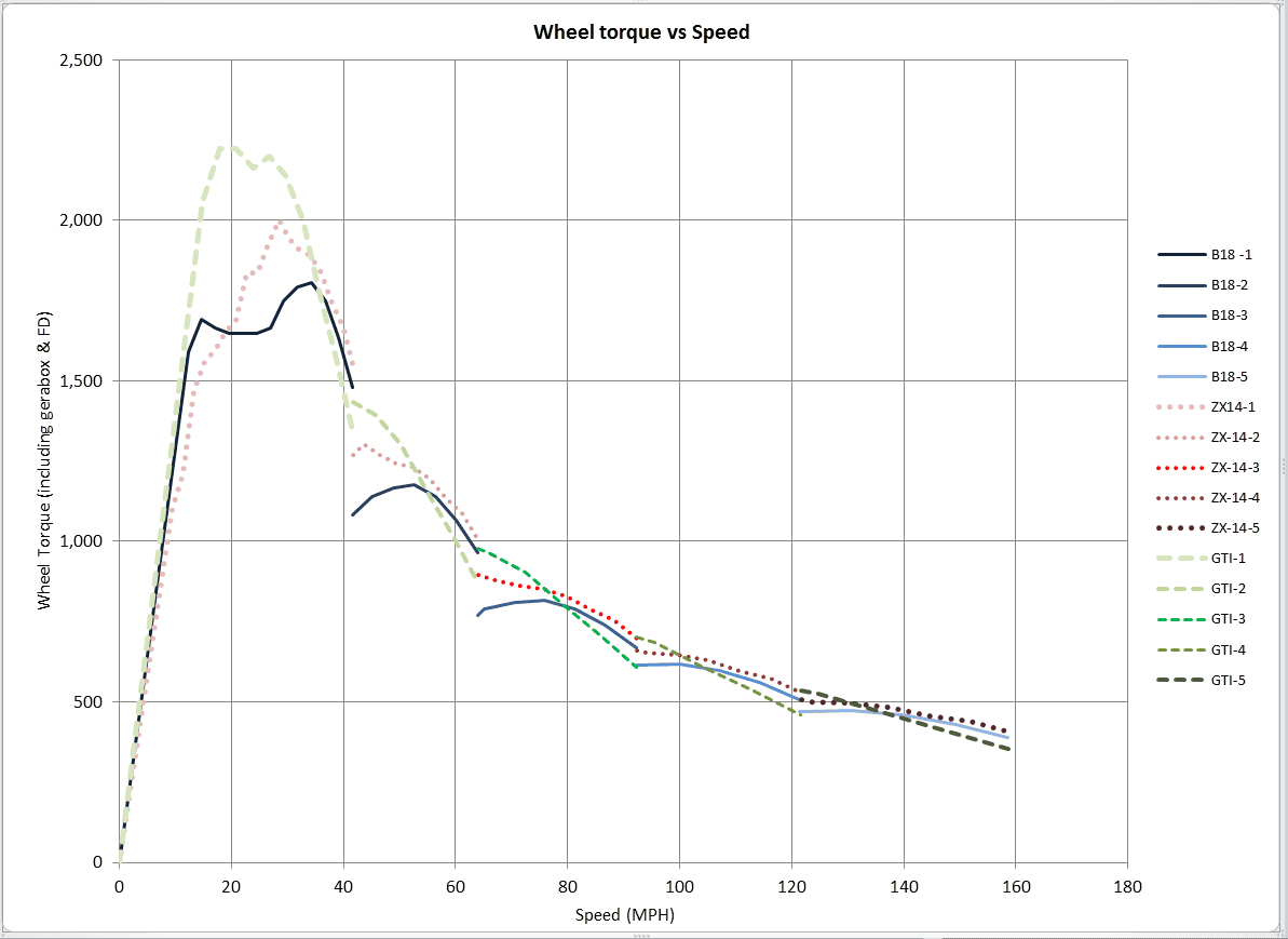

Not enough information. It all depends on the areas under the parts of the curve used for the run.So 182hp, 109 ft-lb vs 176hp, 127 ft-lb vs 179hp, 190 ft-lb. All geared to reach the same top speed. Which wins, which loses, and by how much? Any guesses on the enigines that that produced those numbers?
Sorry these were the closest match I could get for HP while tyring to get significant differences in torque using real data. Charts to follow.
