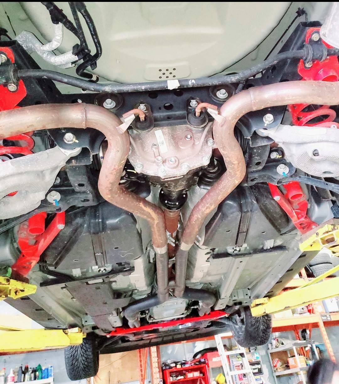

Was that the Cradle lock out 2 kit?
You shouldn't have any squeak coming from that.
I think it's because the bushings weren't clocked. Clocking can make a hell of a difference.
I have a few BMR Suspensionpieces as well as a new Pumpkin with 3:55 from 3:15.
You can see in the pic. I've had no problems with any of it. Cradle lock out makes a big difference if you've got the money I'd try it with clocking afterward. Any body that knows there shit should be able to do it. All info is on Mustang6G.
Is your suspension even from side to side?
Does one tire stick out further?

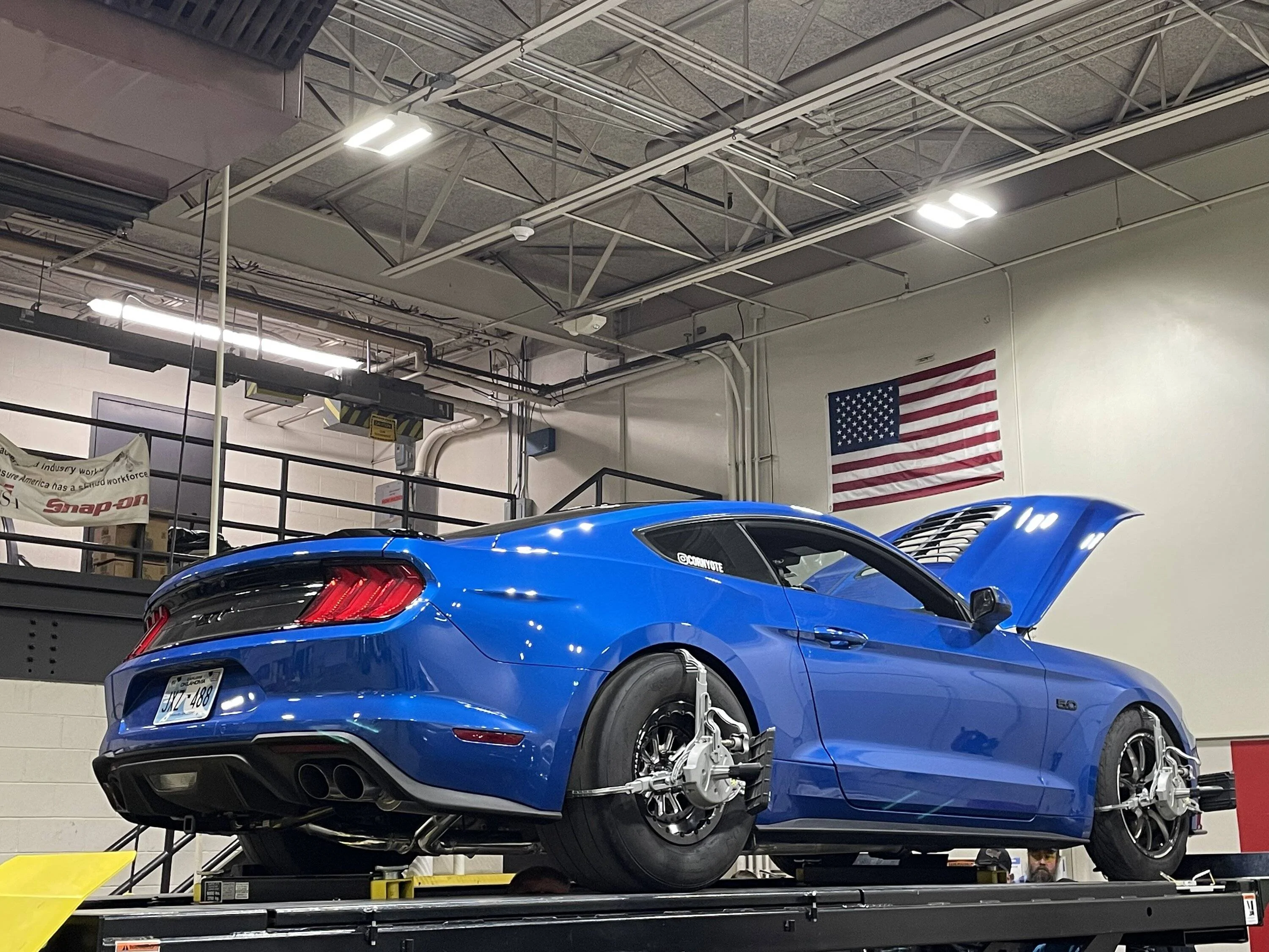

I use the local vocational school. They don’t usually get to see something with an outside the norm alignment and they let me make adjustments myself while they all help out and learn something new. It’s a win/win!
