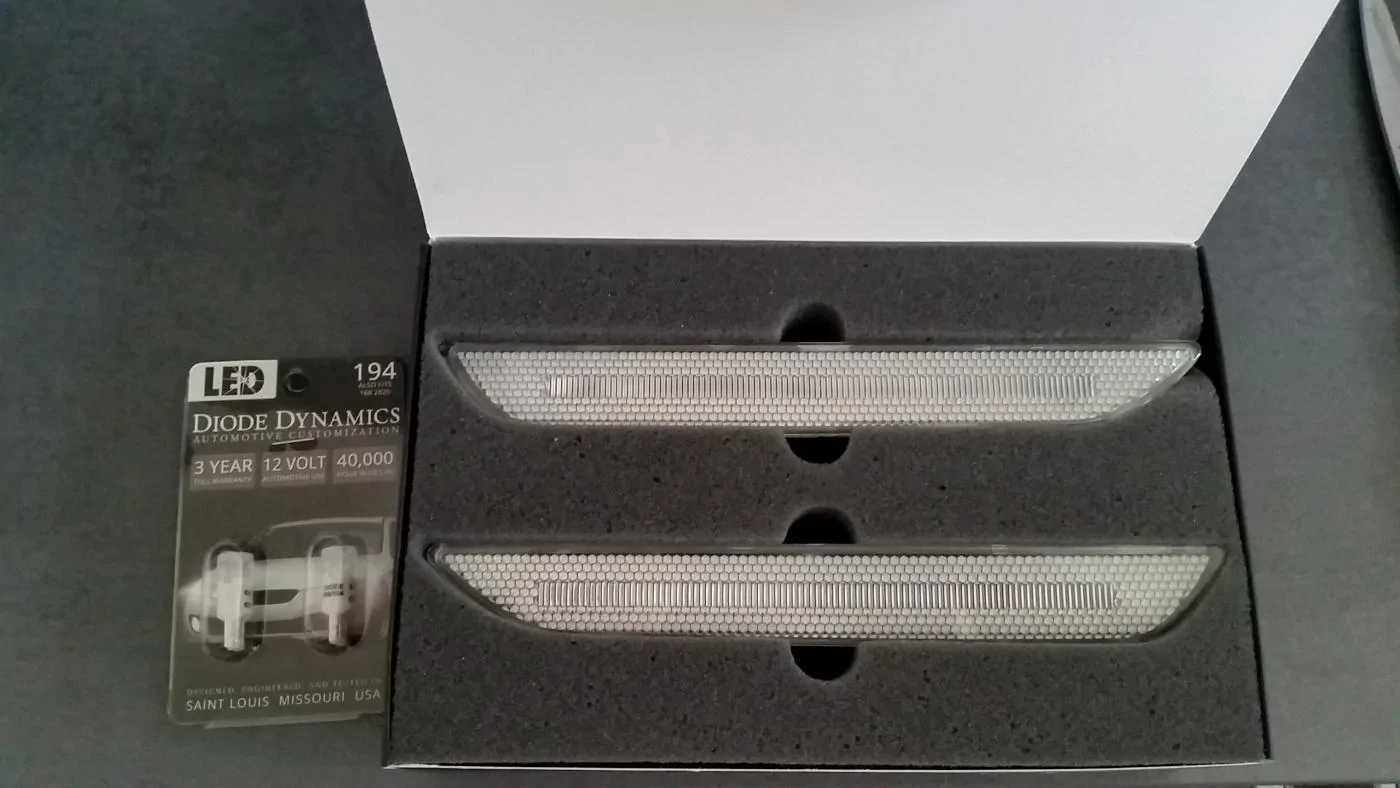

Are these the plug & play switchbacks by DD? I would like to install them withouth to much fuzz of wiring madness..Next update is done. Most of the wiring for the tribars is done too, just have to see when my DD Kit v2 arrives and when I can send in my headlights
The plug & play switchbacks from DD won't work on our cars. We need to play with the wires to have them work.Are these the plug & play switchbacks by DD? I would like to install them withouth to much fuzz of wiring madness..
Okay thanks, I guess Ill wait some more, maybe DD wil show up with a EU version in the near future...The plug & play switchbacks from DD won't work on our cars. We need to play with the wires to have them work.
And for that, you need the kit from US (like papinist's car) or the kit from China (like on my car).
Don't think so ... To work, a switchback needs a 3 wire socket (one for turn, one for white and one for ground). Our socket on the mustang is a 2 wire socket (one for turn and one for ground) ...Okay thanks, I guess Ill wait some more, maybe DD wil show up with a EU version in the near future...
So, nothing can be really plug & play in this case for us ...
Ok I will look into it, I do have a tendency to easily screw things up though... even simple thingsExactly as John said.
But trust me, it's really easy, you have to connect only 1 spare wire to parking light that is next to the turning light
I still would gamble on those, as the EU regulation say's it's not mandatory to have side-markers on cars less than 6M, but usually if you have them they need to be amber... but I would like to have the smoked's damn rules!I installed the switchback from US that papinist used in his car too. Worked great, you just have to re-wire one parking light, the rest is plug & play
