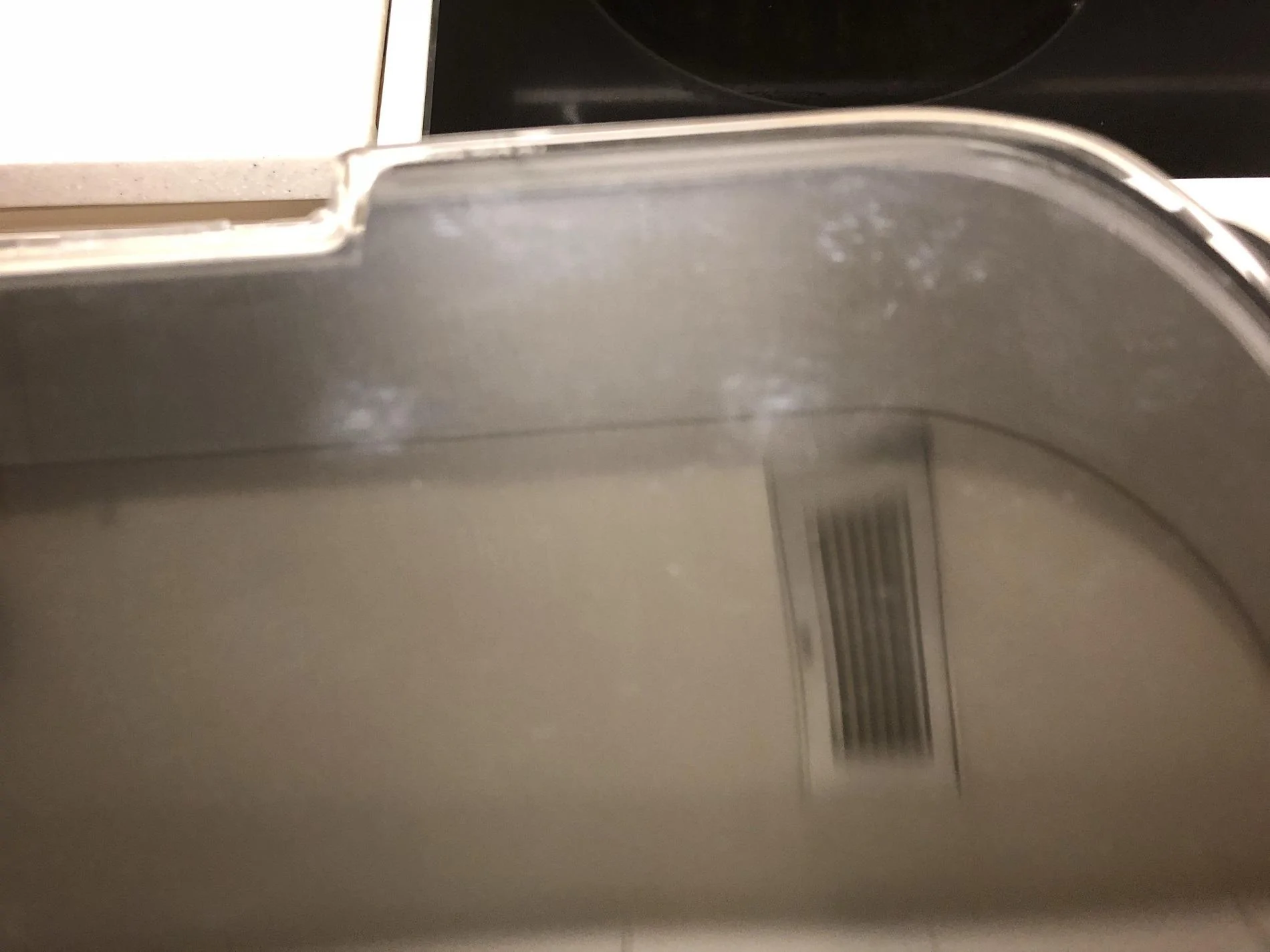

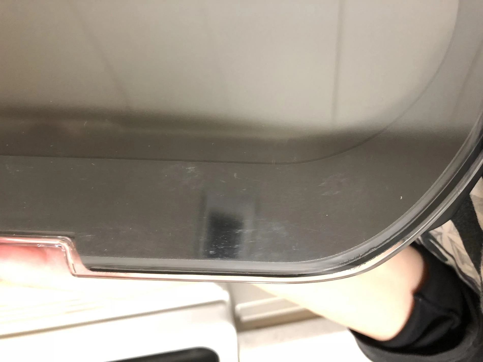

[MENTION=20657]db252[/MENTION] My parts just arrived today (except no SCCM). Dumb question for you - do you remove the plastic cover that comes with the cluster? Mine arrived a little beat up am trying to decide if I need to return for a new one... Tried to discern from your photos but hard to tell if you still have it on after your install.

Your referring to the cover the comes with the cluster ‘housing’, correct? If so, I used the one that was attached to the new housing. If yours is a little bashed up, which it should obviously be perfect being new, you can remove your older plastic piece and replace it with the one you just got if it looks better. The fabric piece is permanent attached though. Just take your time pushing the plastic locks out.

Yeah the plastic cover to protect the monitor is scratched up. Thanks man appreciate it gah - I don't want to wait but think I gotta send this one back and wait for tasca to send over a new one

The cluster display?!? If that is scratched for sure get a new one. I had no screen protector on mine at all but at least my screen was perfect. Did you look at the screen itself? It may be ok and just the condition of the plastic. If it’s truly scratched in any way you won’t be happy so you know what to do if so. That really sucks man and I hope you get that taken care of quickly.

Yeah [MENTION=33326]DallasEl[/MENTION] that doesn’t look right at all. Here is mine when it arrived and it had no flaws. You should get that swapped out. You payed very good money for a new part.
