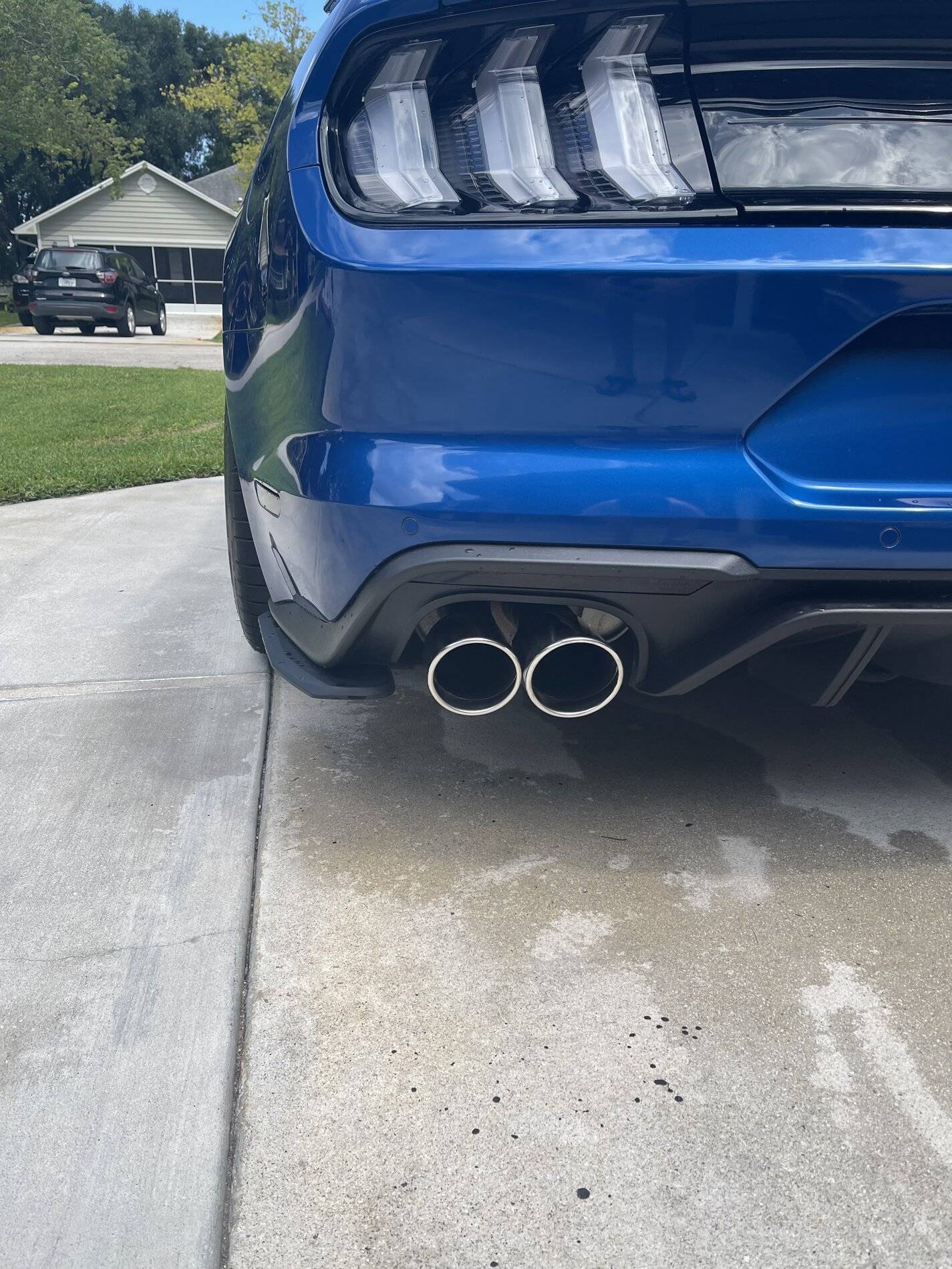

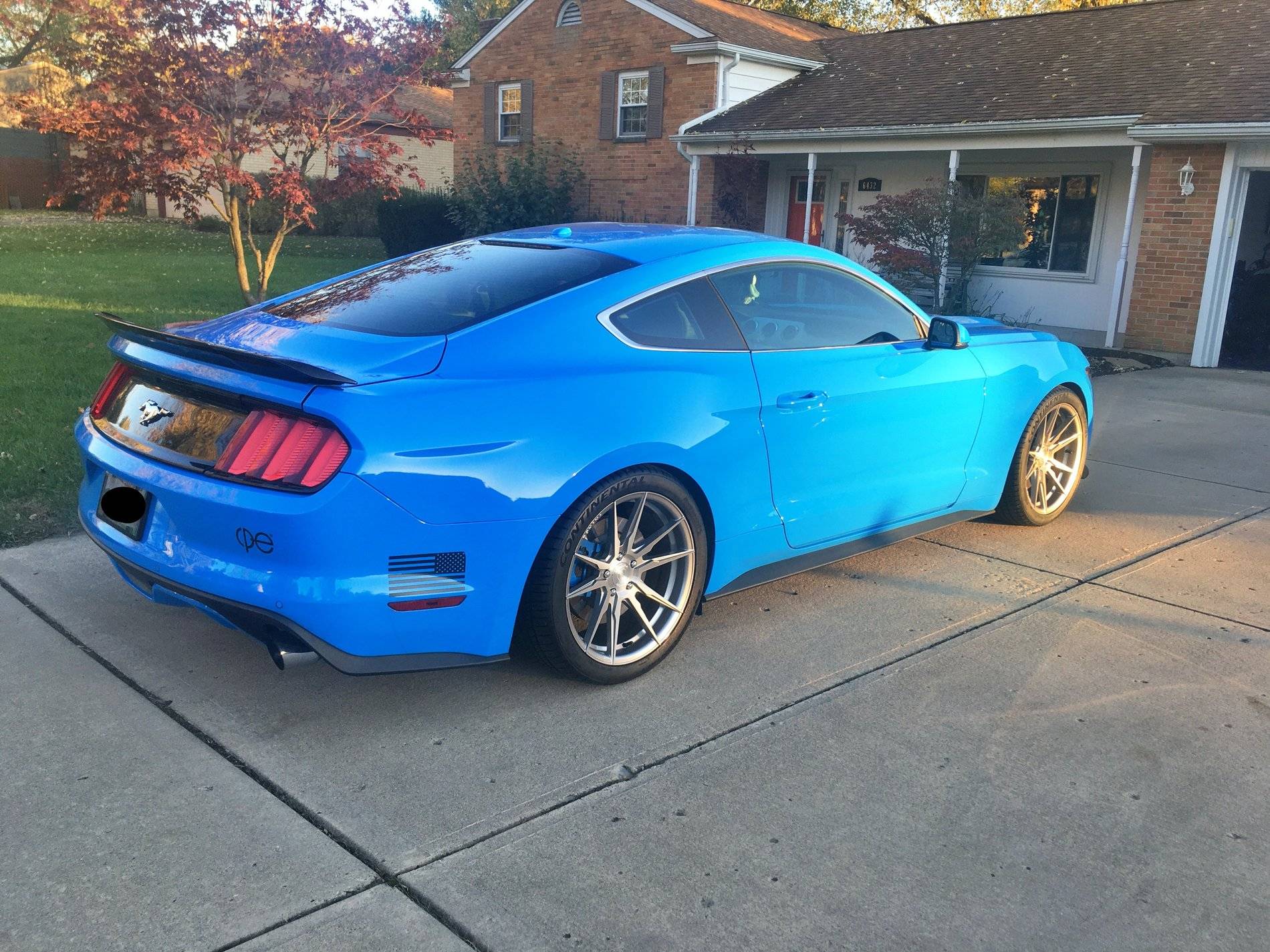

back before my switch to silver wheels. forgot how pretty the chrome tips look when they are clean on inside. Lol
and now

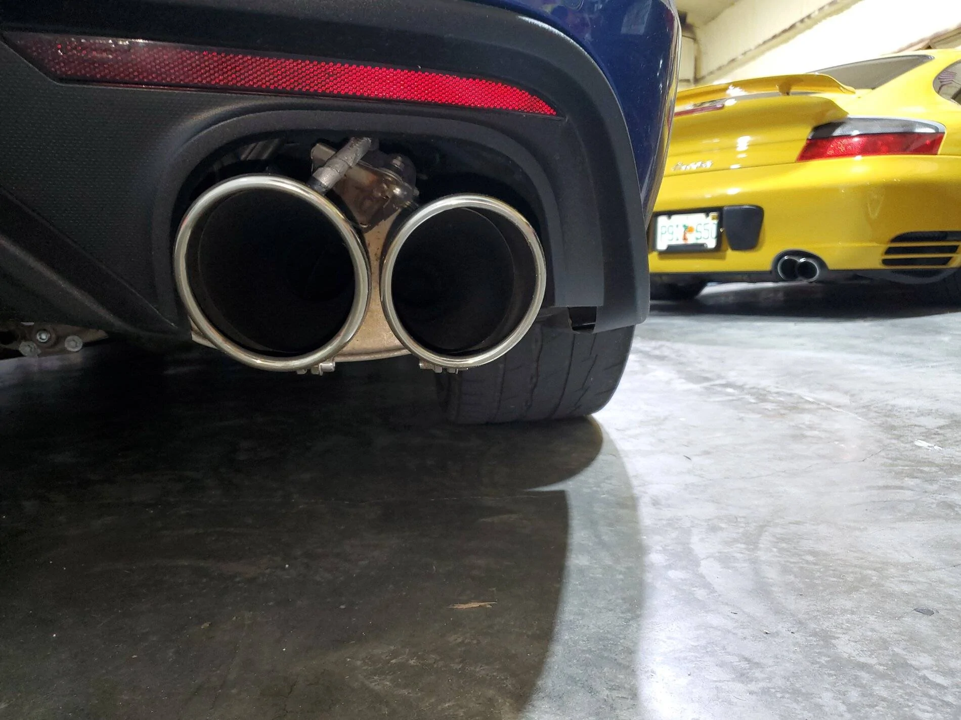

Do the clamps have to be on the bottom or can they be rotated to the top so they can’t be seen as easily?
You can cut the clamps off with a dremel and weld them on like I did.
It will also allow the tips to sit an inch further into the valance and be flush like the stock ones.

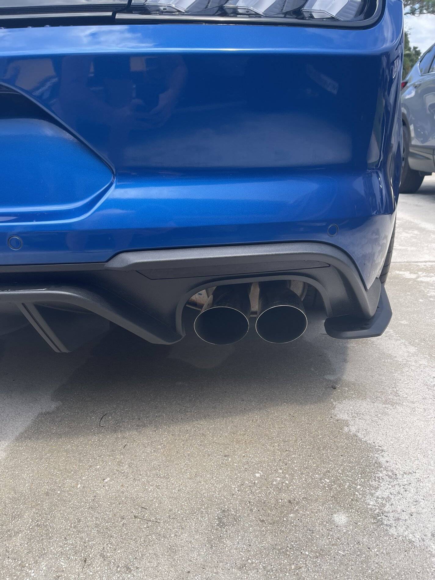

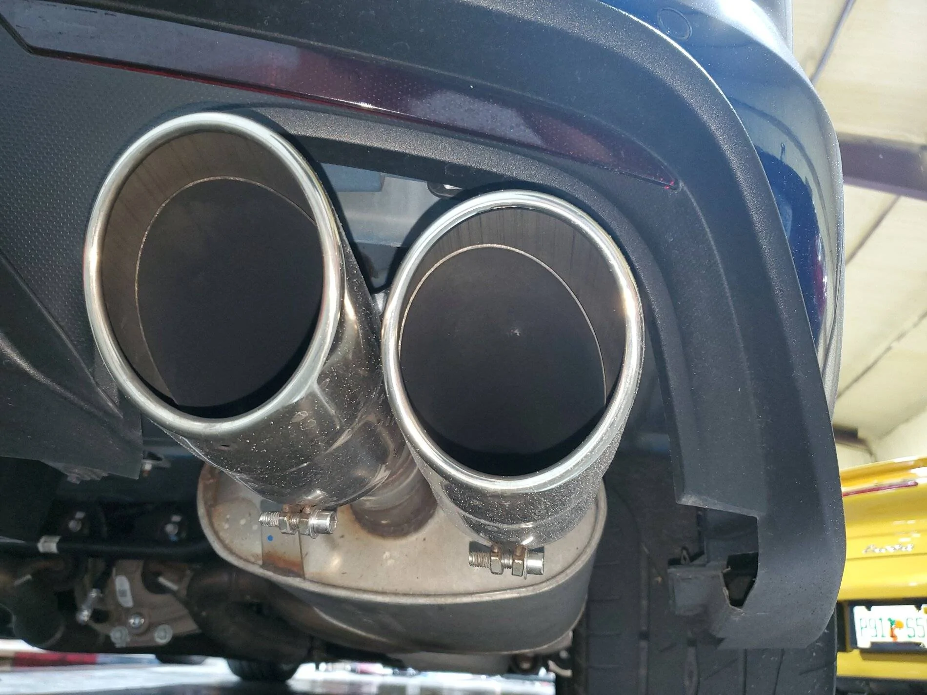

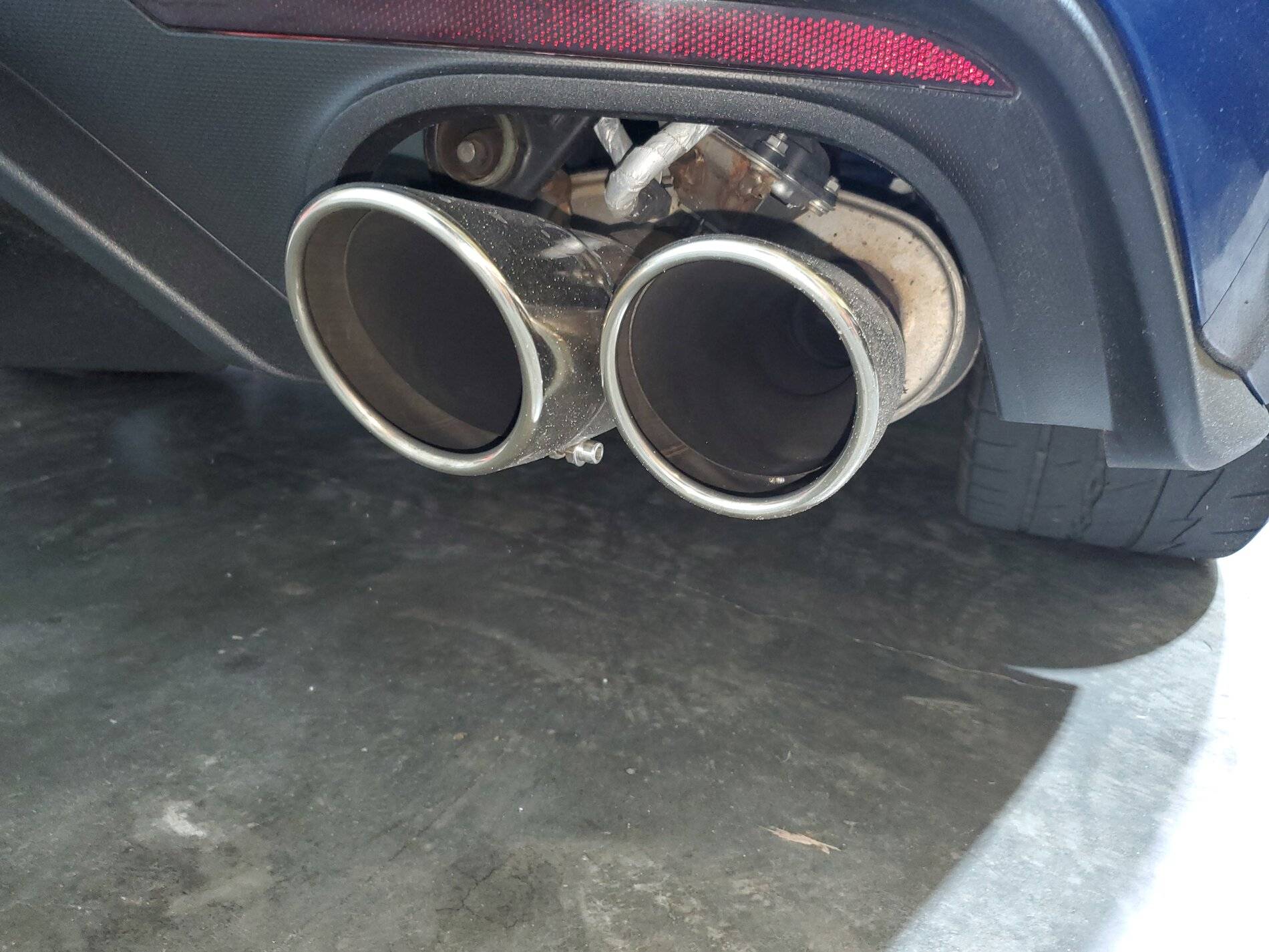

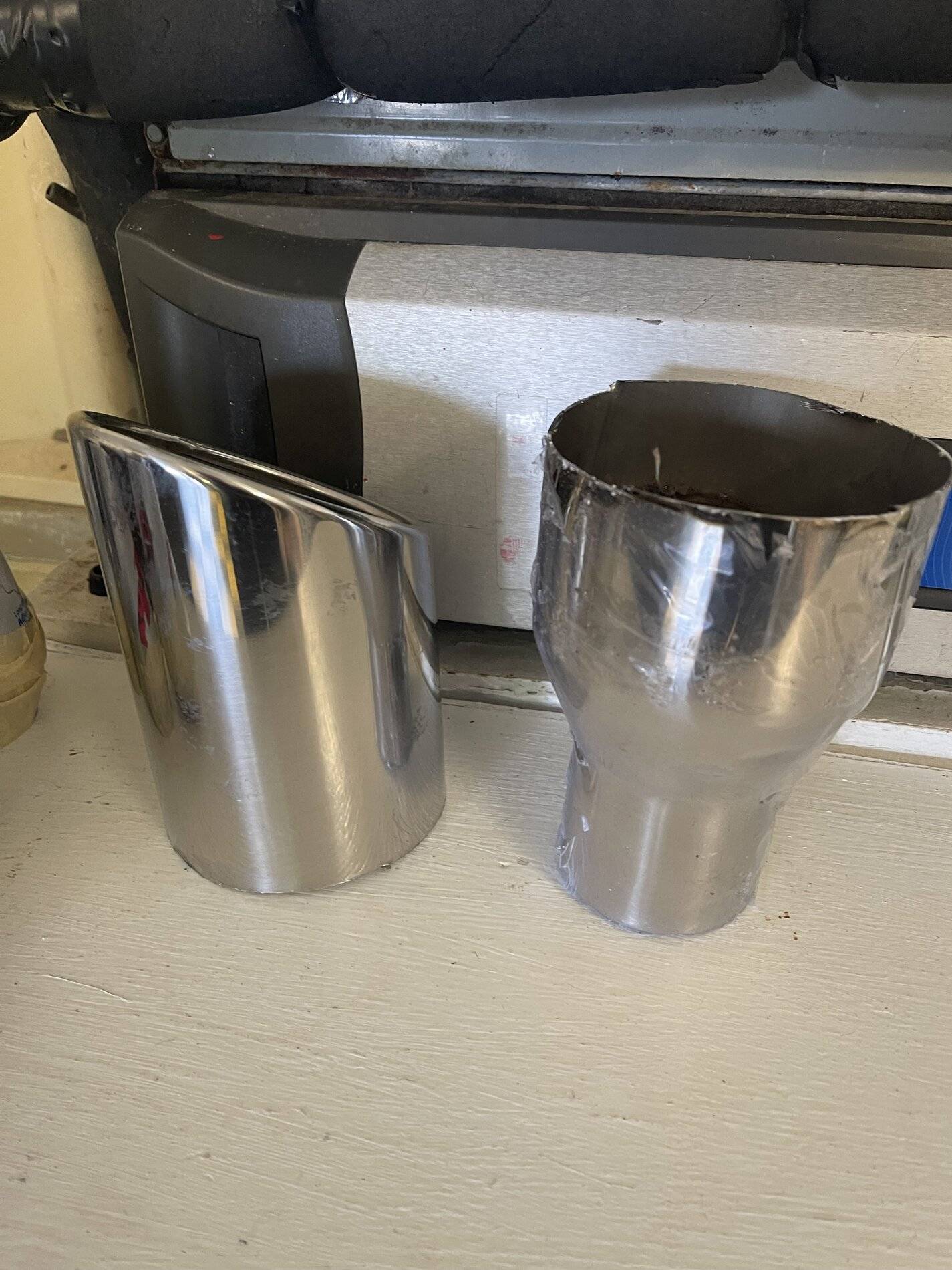

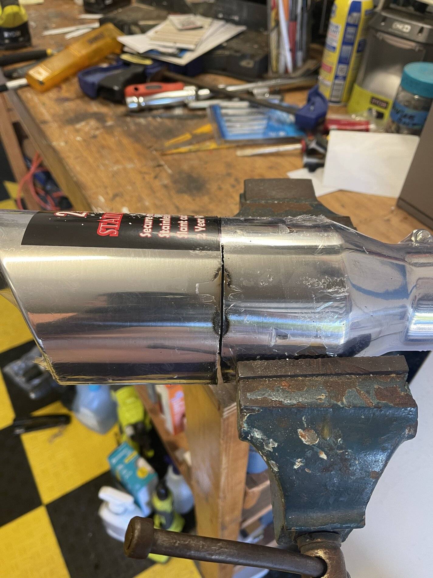

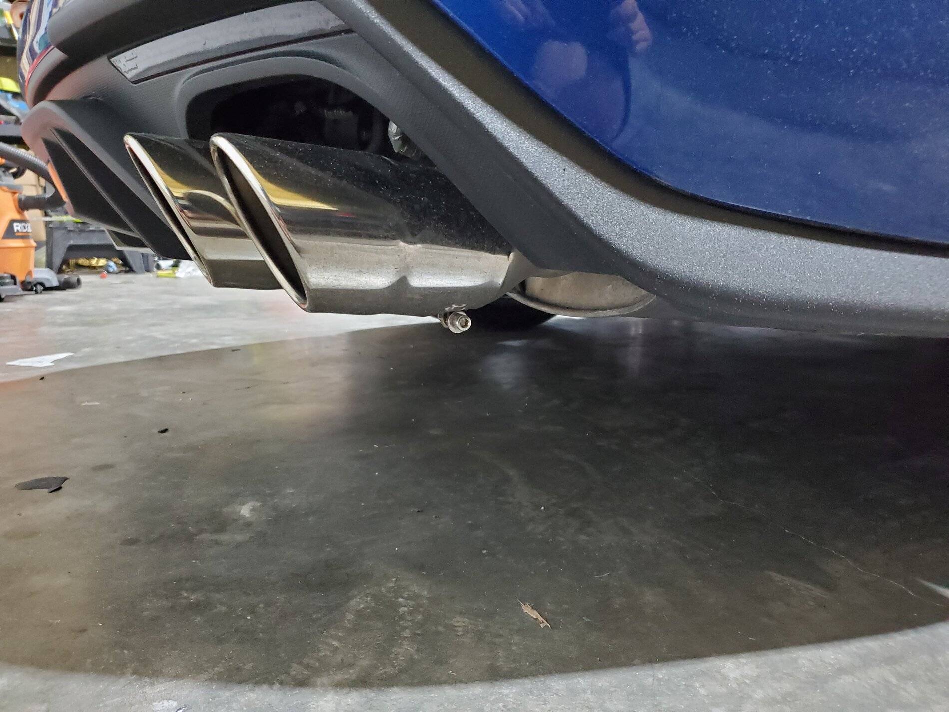

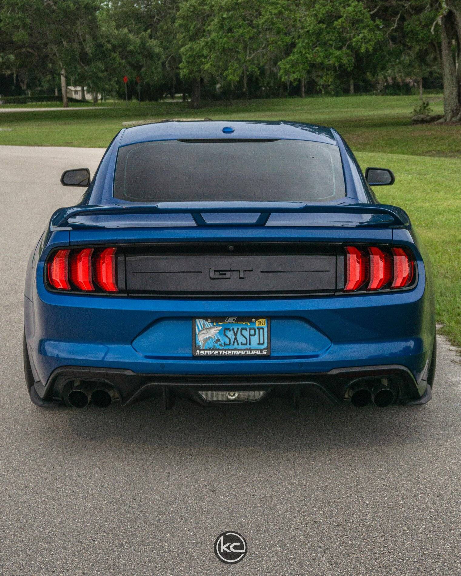

Cut the tips today. Struggled with my first few blades. They were cheap Milwaukee metal blades. I ended up going to home depot and buying a diablo carbide blade on my saw zaw. came out pretty good, measurements aren't exact but the new tips are double rolled and push in far enough where the edge of the new tip hits the existing tip making them aligned perfectly.
Jukehz
Mar 12, 2021
Vero Beach FL
www.kylescaptures.com
Kyle
2018 GT Premium PP1

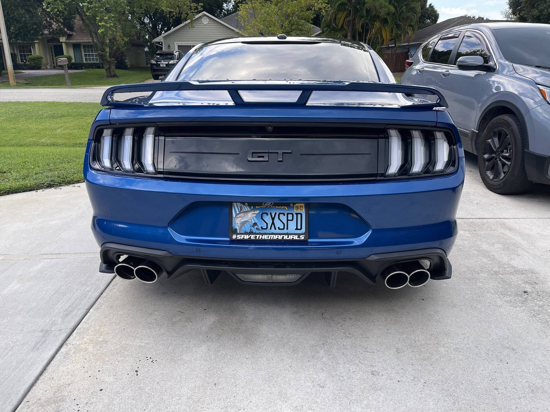

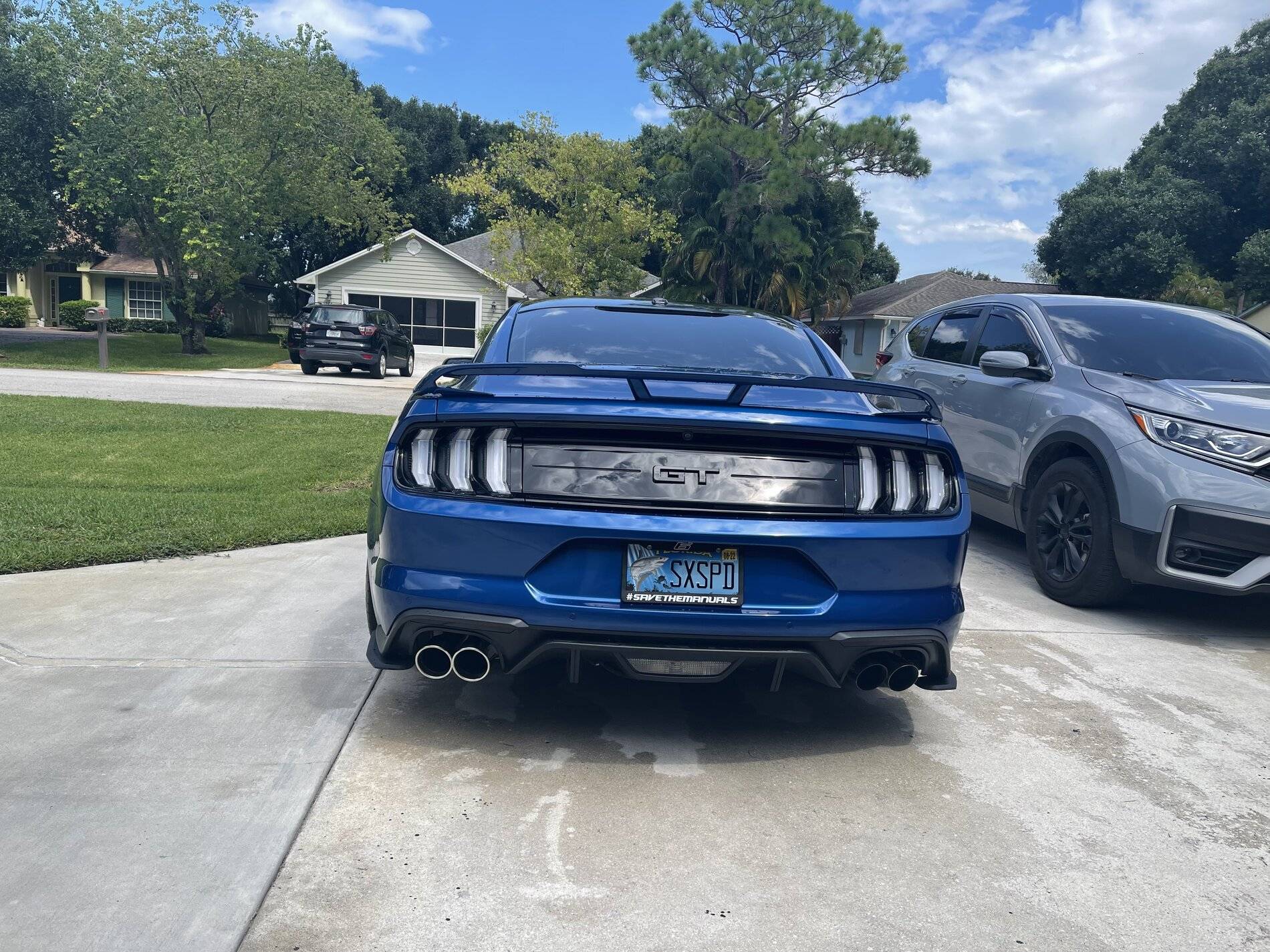

Had it welded last night by a buddy. Looks great, so much better than the thin stock tips. I painted the weld marks that came through the inside of the exhaust, just gave it a touch of satin black. Im sure the carbon will cover it soon anyways. All in I spent $68 on 4 tips, $20 on new saw zaw blades & $50 for the welding. Total $138
