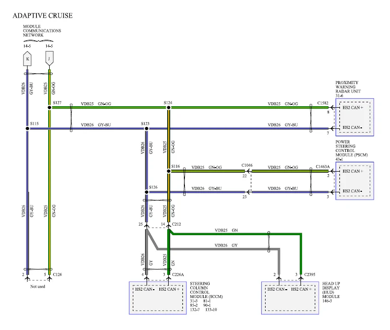

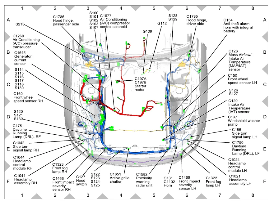

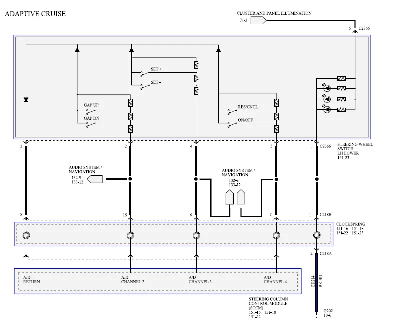

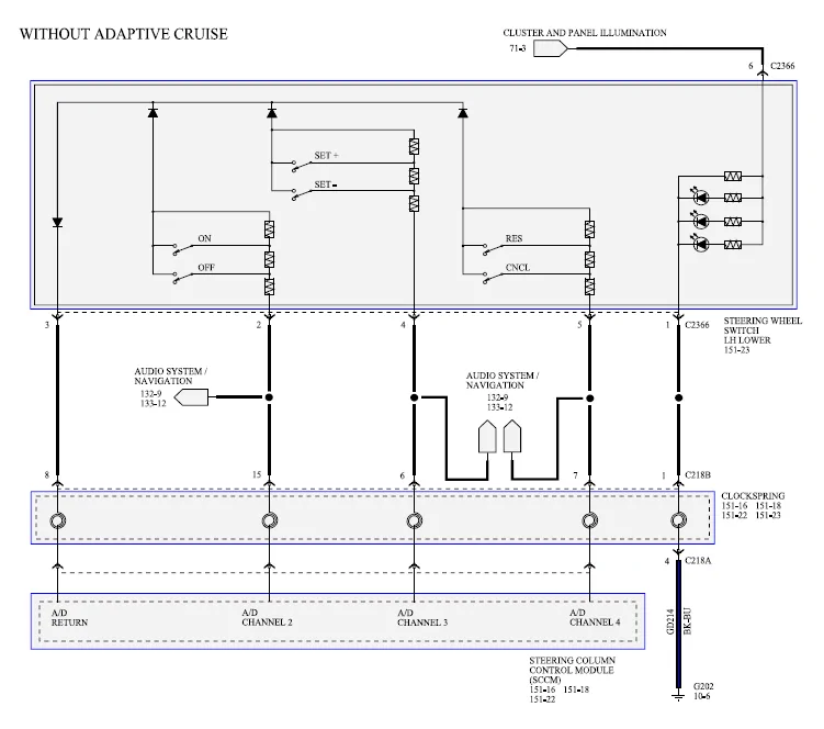

Update (09/25/2017): Just found out that our car have ACC (Adaptive Cruise Control) option available. Anyone who has it can chime in? I'm looking for the parts # and the As-Built Data to enable it. After that I will be look into controlling the steering wheel.

Update: (10/02/2017): As I speak right now, I found someone that is making a custom board for me to control the steering wheel. It's on test right now I'm looking at 2 options. Making my own kit and hack the can bus signal with another person. The reason why I'm looking at making my own kit is because I want to make it universal for other cars as well
