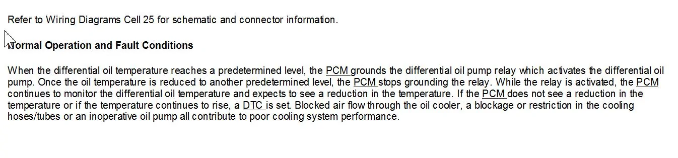

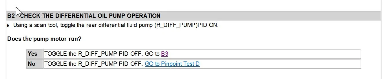

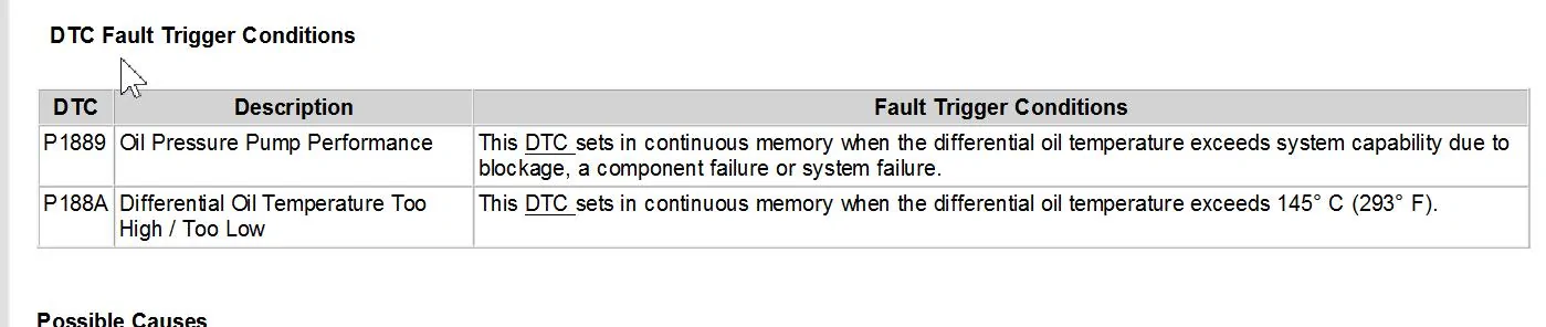

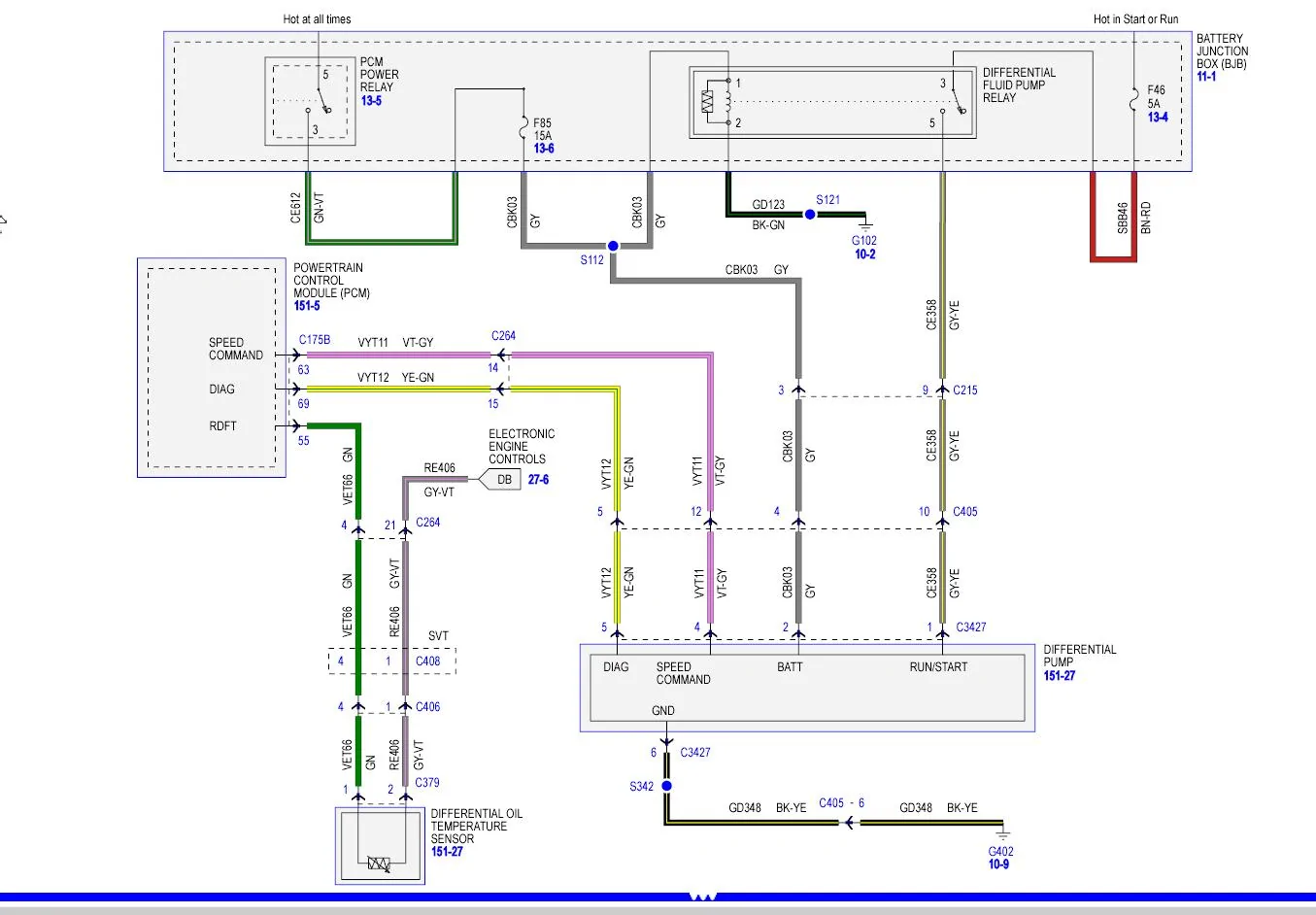

What temps do see with normal driving? Does anybody know the temp the pump comes on? Can you monitor with forscan the pcm signal that turns on the pump relay. Or can you force it on with forscan.
Great info [MENTION=28002]cking[/MENTION]. Forum members have been trying to figure out where the diff pump info might be accesses on forscan with no luck yet.
