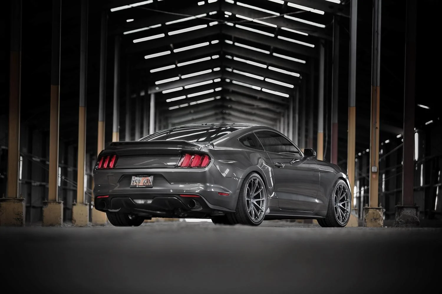

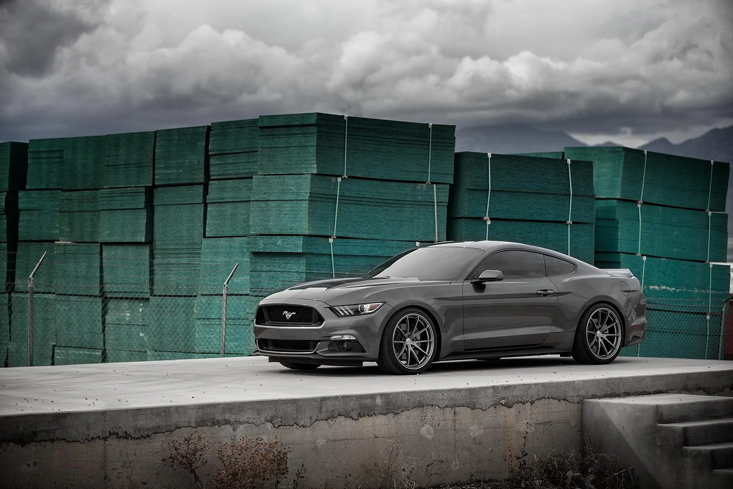

19x11 +50 all around. Fronts use a 20mm spacer. 305/30/19 Hankook RS3v2
That looks great!
How is the ride with the wide tires on front and 30 series profile? I know most people use a 35 series profile so was just curious.
Does it tramline an appreciable amount?
Thanks

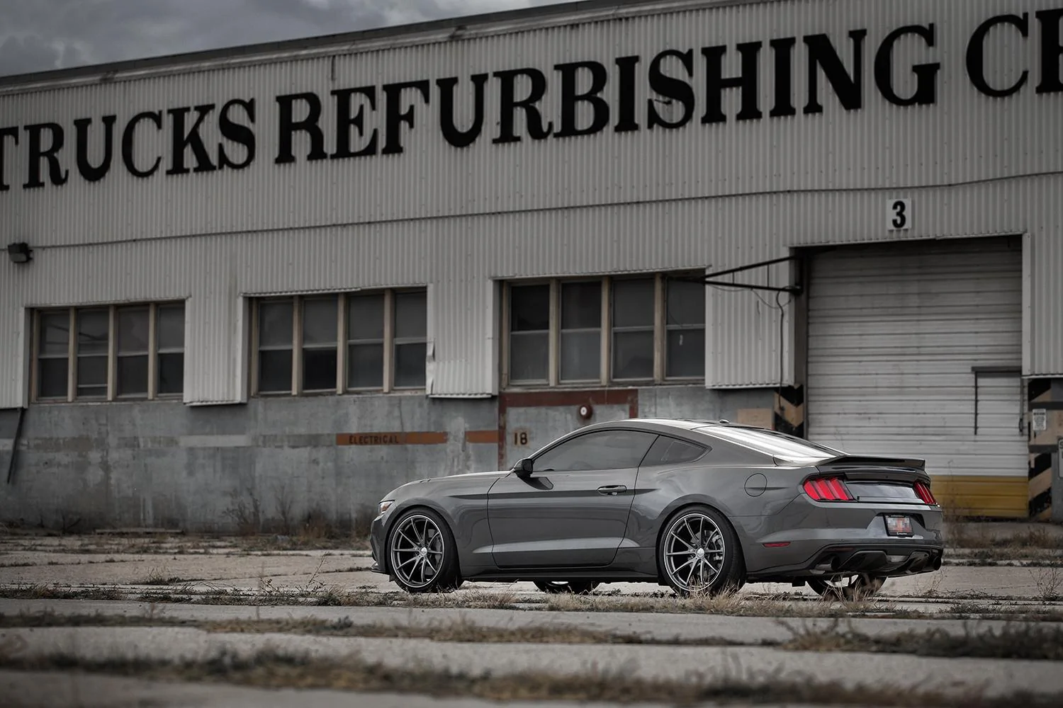

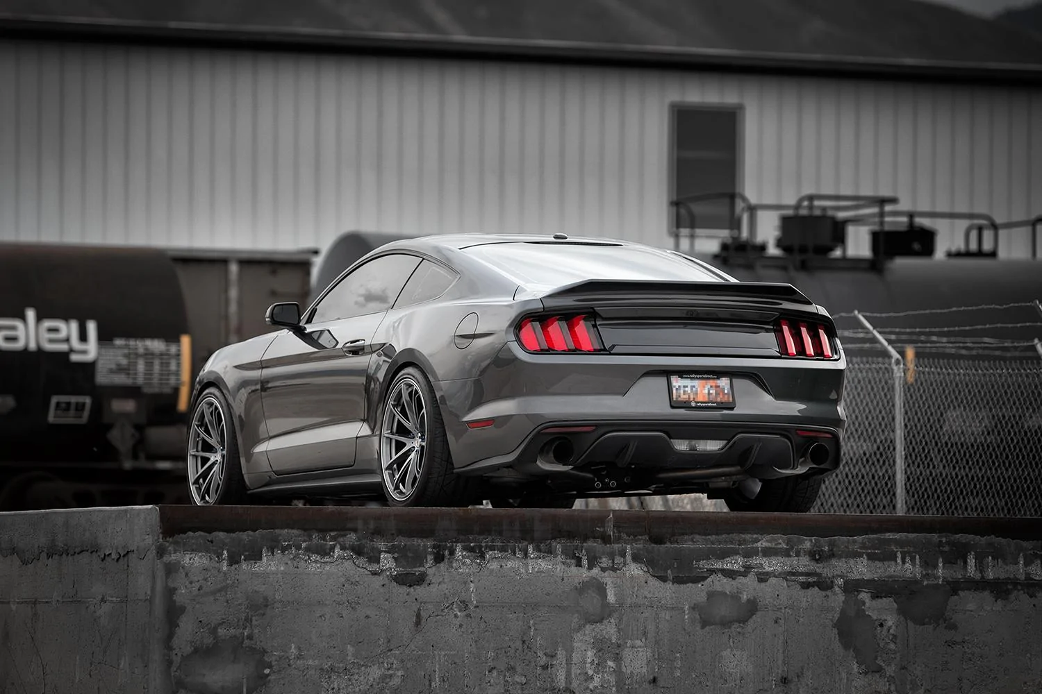

im 19x9.5 275/35 tire 35 offset i might get a 5mm spacer to see if it makes a diff.. pics for ref
This looks perfect as is. I'm picking up these wheels on Saturday (though in the dark stainless finish).

What does the +50 mean? Also was it a straight fit with only the spacer upfront or did you need other parts and specific alignment specs to not rub?
Paul pretty much answered all your questions. As far as alignment is concerned, even the stock amount of camber would work fine with the 20mm spacers. I'm currently sitting at -2.0*, so not too much more than stock.
Find the 19x11 square setup thread that killspray started. There are more details in there and eventually we are going to get around to getting more measurements with different combinations of front end setups.

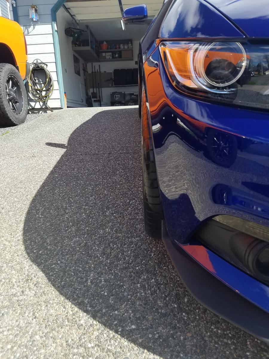

Finally got my wheels on. 13-14 GT500 reps from AM. 19x10 squared with 5mm spacer on all corners. Got the wheels on BF for a little over $400:headbang: Wrapped in 275/40/19 Bridgestone S04 PP. Just need to lower her now!
