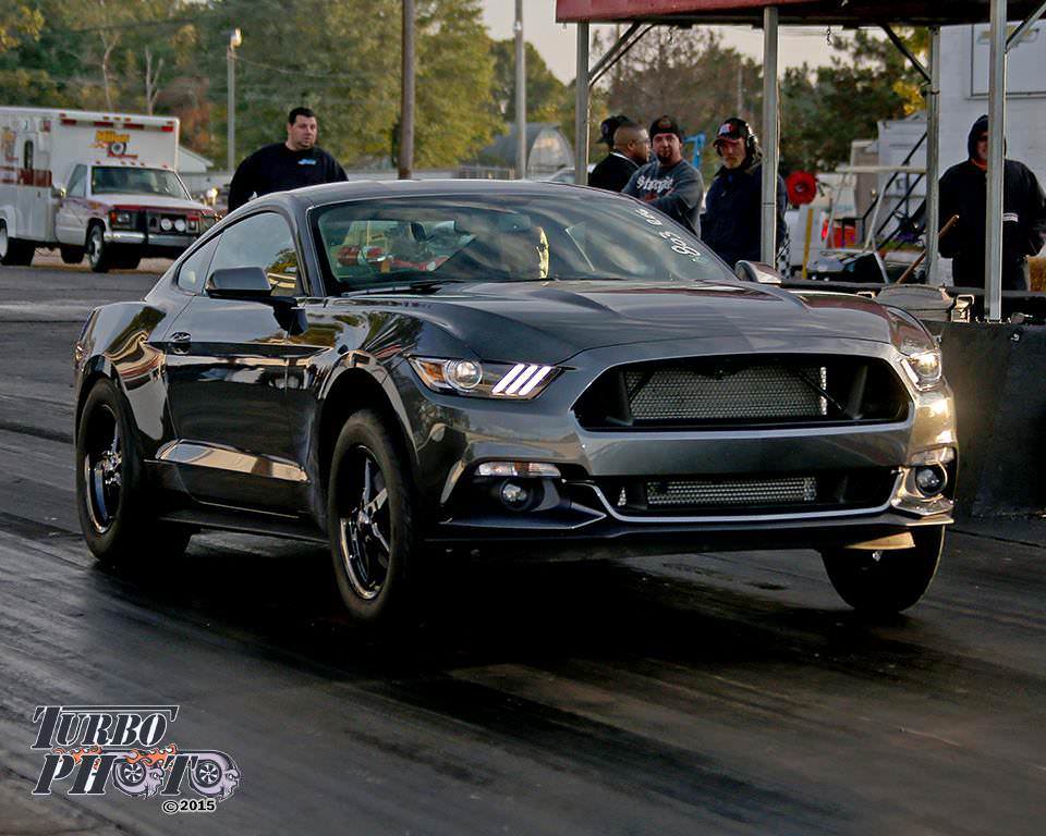

First post since the big change. As most of you know I no longer work for MAPerformance and have made the jump to tune full time to better assist my customers. What I have for you is an update on sb1racing's car. I have posted this before when I worked for MAPerformance but since then he has gone even faster with very little changes, and there is a TON of room left on the table.
The goal here is to set the fastest stock turbo Ecoboost Mustang record with very minor changes, and of course keeping it full weight and stock motor.
2015 Ecoboost Mustang Automatic
Modifications:
Custom E30 tune by Tune+
ATM Intercooler
BMR Suspension Differential Kit
Mickey Thompson ET Street's on Race Stars
MAPerformance Mid-pipe
Stock Intake
Stock Downpipe
Stock Converter
Stock Motor
Stock Springs
Stock Turbo
60' - 1.565
1/8 ET - 7.501
1/8 MPH - 90.60
1/4 ET - 11.83
1/4 MPH - 113.33
There is still some room on the table, there was a few lean spots and throttle closures and it was running lower boost in 1st/2nd then 3rd/4th. Will make some changes and hit the track again next week and hope to knock out some 11.60's.
