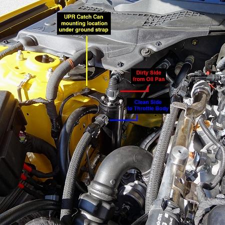

  • Loosen the ground strap with a 8mm socket and install the catch can on top where the two output ports are parallel with the length of the car.
  • Route the dirty side hose around the foam area near the passenger cabin and behind the cables. Slide the tube into the dirty side connector(green tip) and push in the tab until you hear a click. Verify and tug on it slightly to make sure it is secure. Finish routing the tube by feeding it behind the coolant tubes and connect the grey clip connector onto the top of the catch can.
  • Remove the rubber connection on the stock intake tube, take off the clamps, and replace with the included UPR connection towards the end of the tube. Place the clamps in the same position on the new connection. Imagine the intake tube in the car and place the connection where the nozzle is roughly at a 45 degree angle facing towards the passenger side. Slightly tighten the clamp onto the intake tube.
  • Place the airbox/intake tube assembly back in and connect the turbo connection/other tube, pipes, and sensor removed earlier.
  • Connect the shortest included hose to the nozzle on the intake connection and the port closest to the rear of the vehicle on the catch can. Make sure the right direction by blowing. Air should travel into the engine. Tighten the clamps on the intake connection piece and make sure it is secure on both sides.
  • Connect the clean side hose to the engine port (green side) and clip in. Verify by giving it a tug. Route the hose in front of the intake tube and under the coolant hose. On the passenger side, route the hose around the cables and connect the grey connector to the port closest to the front of the catch can. Check that the hose isn’t touch the fans on the radiator.

Here's a tip based on my experience. Mount the ground strap so that it is making contact with the bolt head or you can lose ground. That is a bad thing. You'll lose power steering (drives like a 10 ton truck) and several other systems. The ground strap needs to make contact with the bolt head due to the paint on the inner fender well which doesn't ground well. It cost me $90 and a trip to a Ford dealer while on vacation to find this out. :doh:

This one does NOT form a good ground, and the black wire underneath the mount is a ground strap. If this strap is NOT grounded properly, it can affect your power (electric) steering, rendering it useless.
Dealership diagnosed the problem, and since UPR catch can is aftermarket, not covered under warranty - GRRRRR!!!
You have to mount the ground strap ABOVE the bracket, against the bolt (not underneath the bracket).
