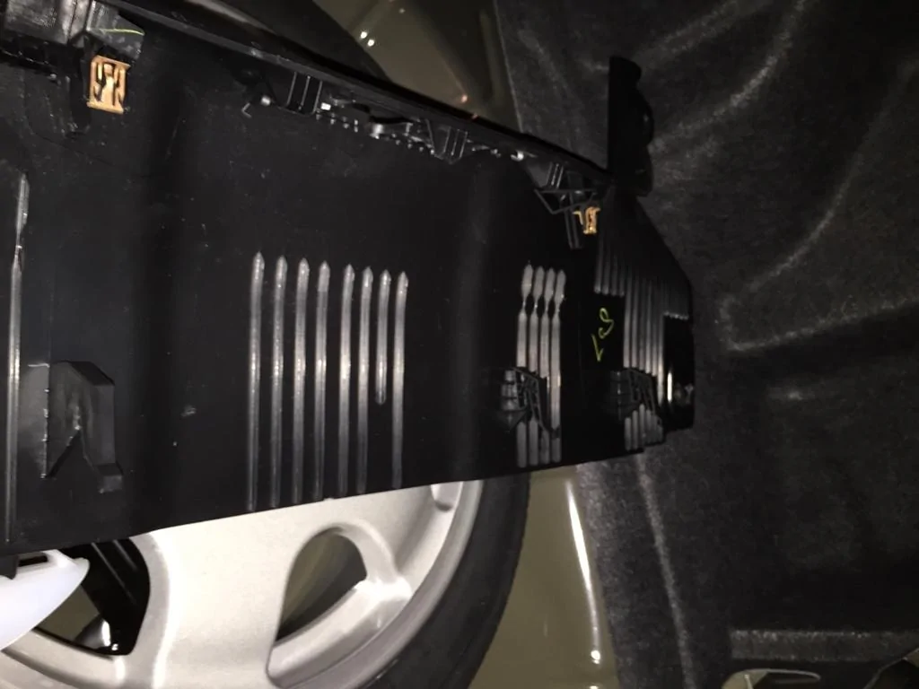

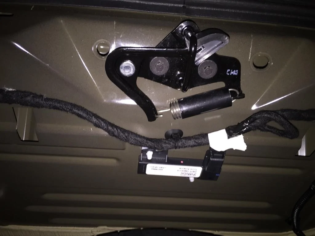

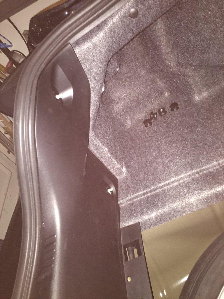

I did same thing to the hood, because I needed to slam it pretty hard to make it close (1ft drop wasn't enough). Now it's closing pretty good for Ford.My trunk lid was very hard to close. I'm sure the dealer could fix it easily, But I have time so I adjusted it myself: as follows -- Open the trunk lid - remove the spare tire cover - remove the 4 thumb fasteners that hold the cover for the tail lights and trunk latch ( bolted to the body ) == carefully remove this cover because it also has several clips that help keep it in place -- loosen the two bolts holding the trunk latch to the body --- adjust the latch, cinch up the bolts --- carefully close the trunk lid --- I did this several times until I had the latch in the perfect spot and the trunk closed easily. I also told the sales manager at the dealership so he could help future customers with this problem.
