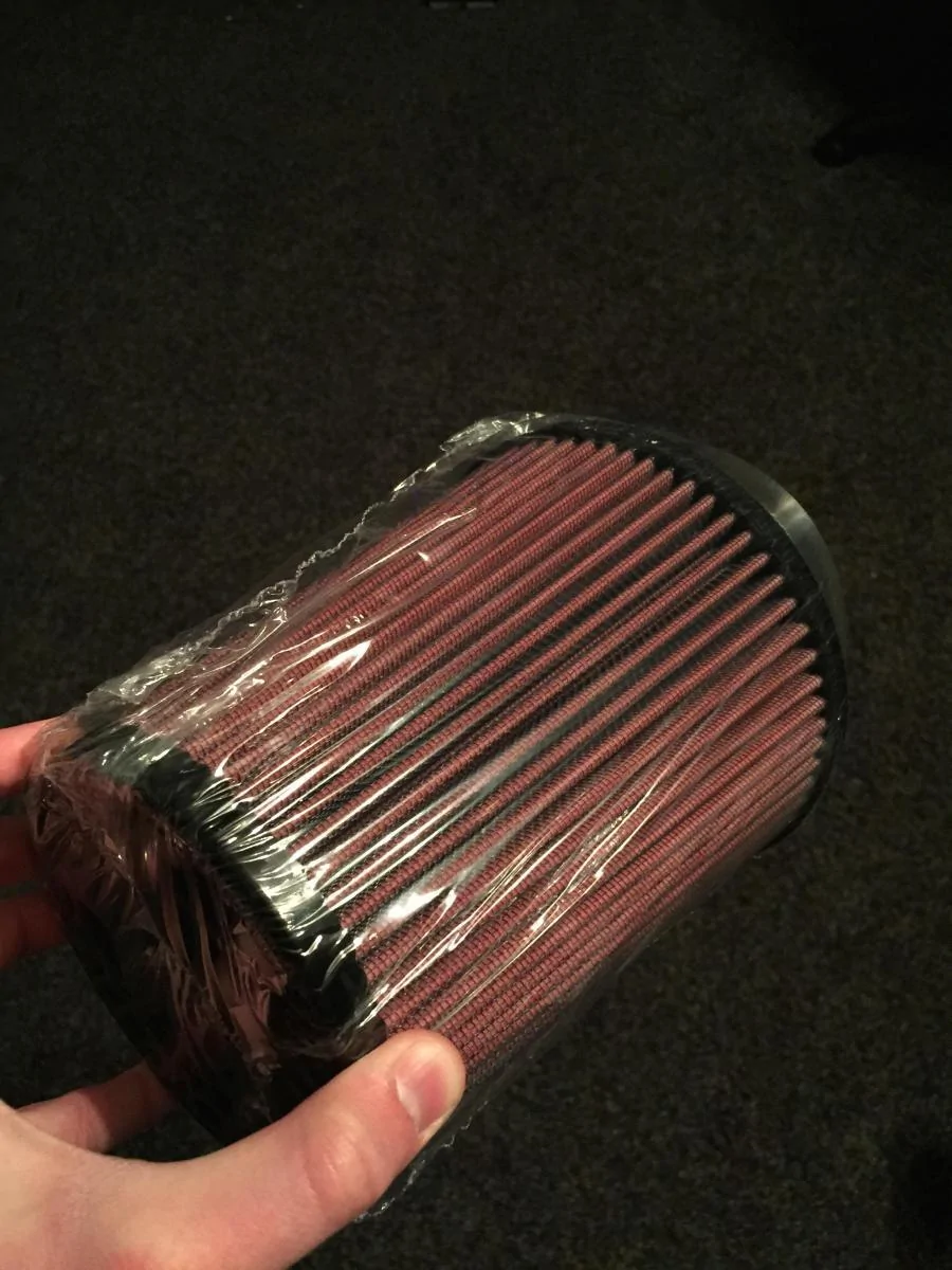

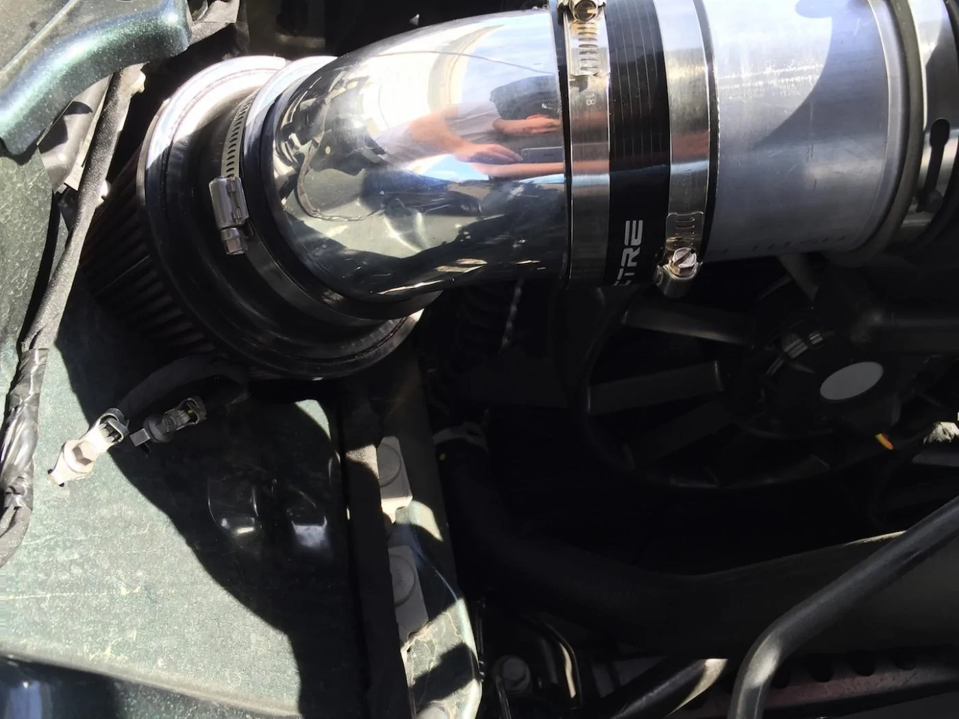

Now that it has been all but confirmed that our 6 uses MAP, I feel confident enough to attempt a custom CAI. Today I bought an Airaid Cone filter (700-456). This is the same filter used on their 11-14 CAI. I will be reusing the stock ABS plastic plenum tube with the PCV connections. The stock diameter at its thickest point measures about 3.8" so I will be moving up to 4" from there to the filter. During testing I moved the filter to 4 different locations using the adapters/couplers that I had available to me. Pictures of each location are below. I recorded inlet air temps to determine which location would be the best to proceed with. An interesting thing to note, the IAT sensor was NOT in the stock airbox... It must be incorporated in the throttle body or the MAP sensor itself. Because of this IAT's read by the computer will be higher then actual IAT's at the filter.

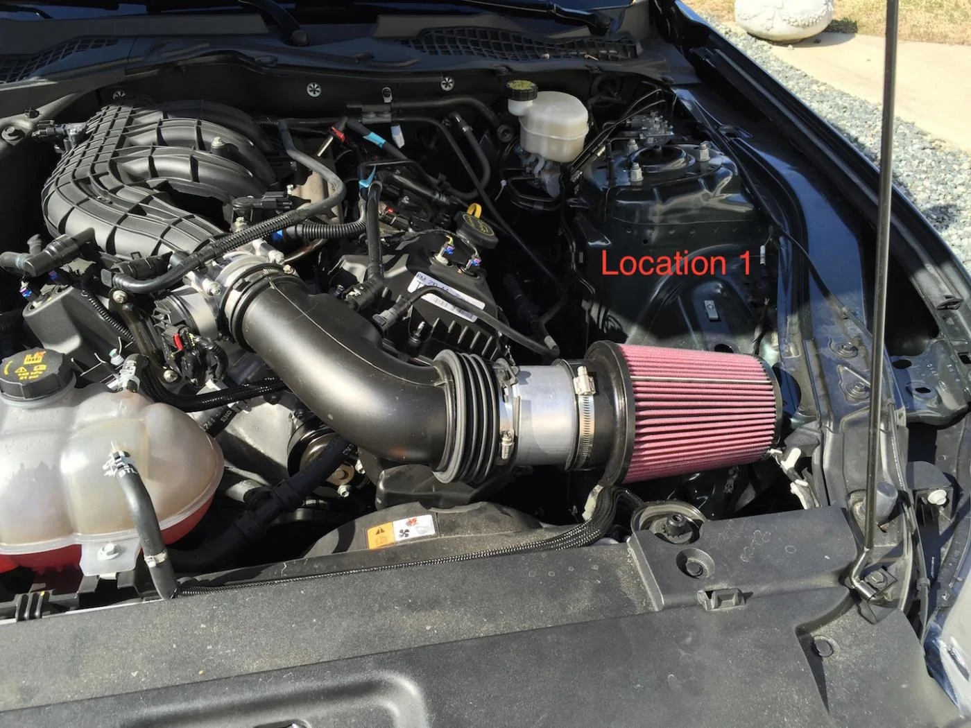

Location 1
IAT while at idle: 108 degrees
IAT while moving 50mph: 97-99 degrees
Custom heat shield did reduce IAT's to around 93-95 degrees while moving.

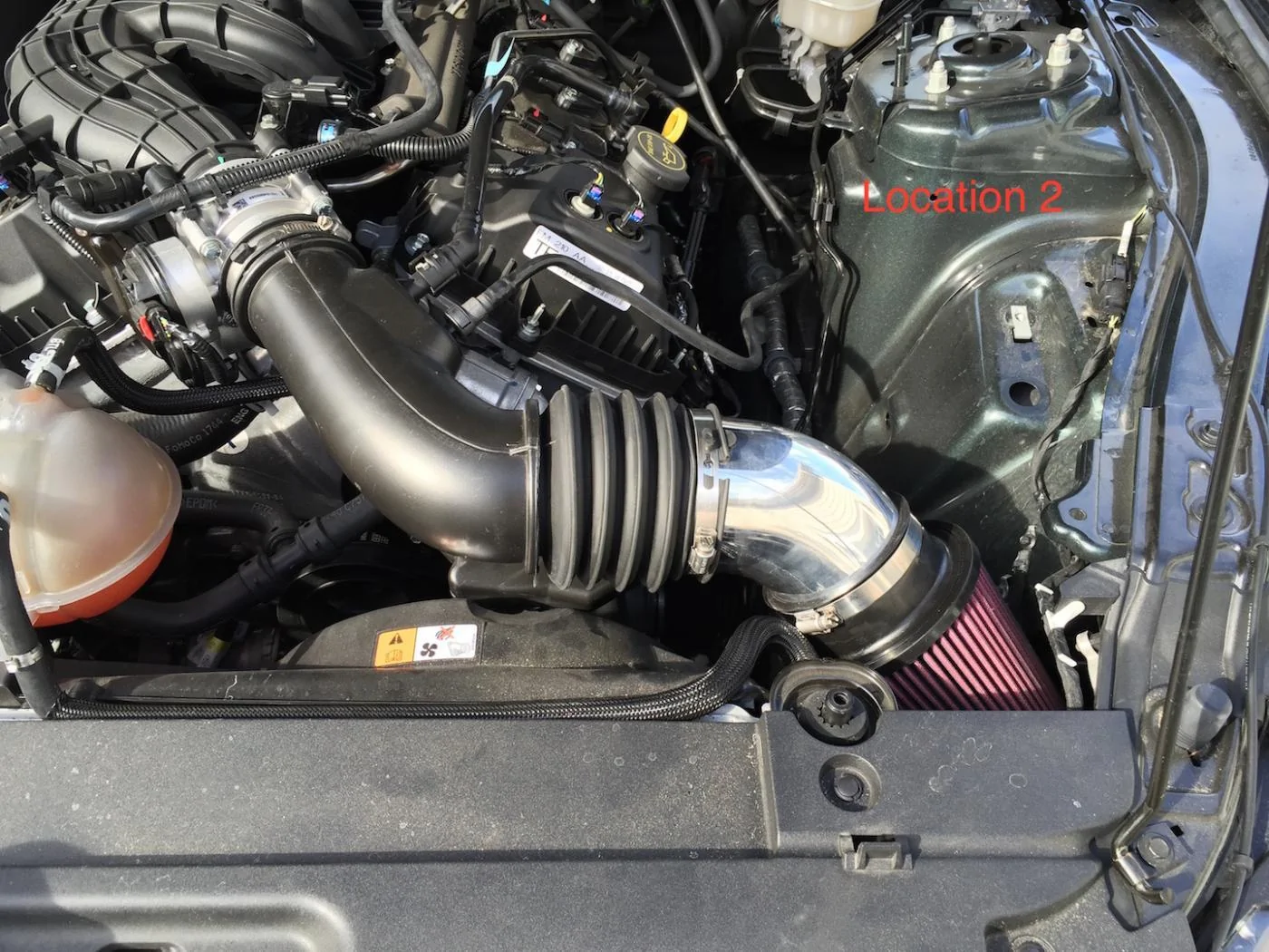

Location 2
IAT while at idle: 106 degrees
IAT while moving 50mph: 95-97 degrees

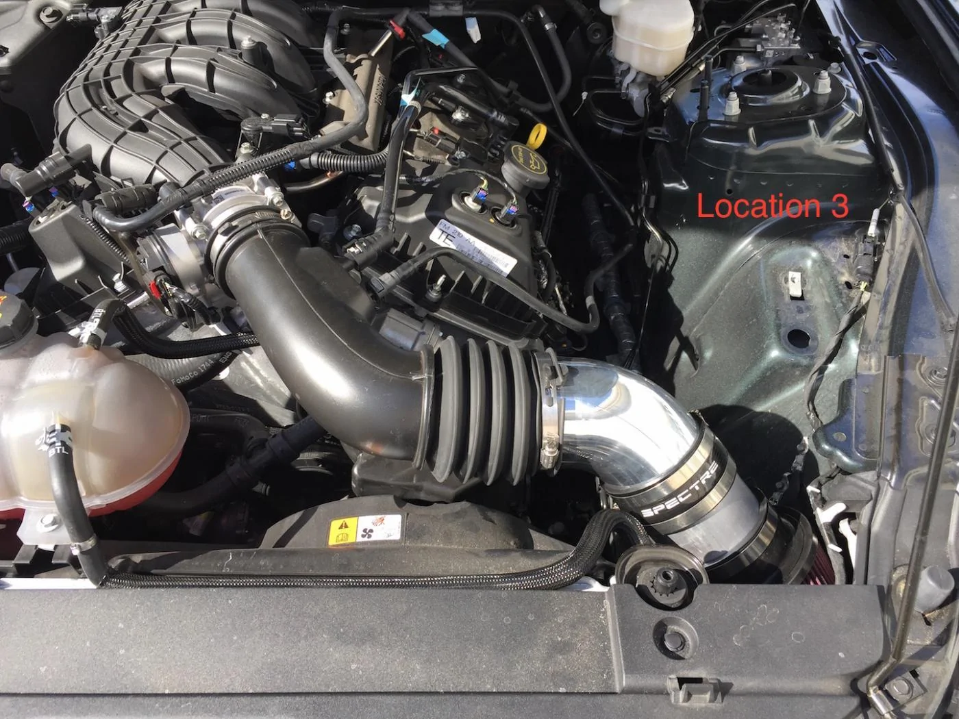

Location 3
IAT while at idle: 105-107 degrees
IAT while moving 50mph: 93-96 degrees

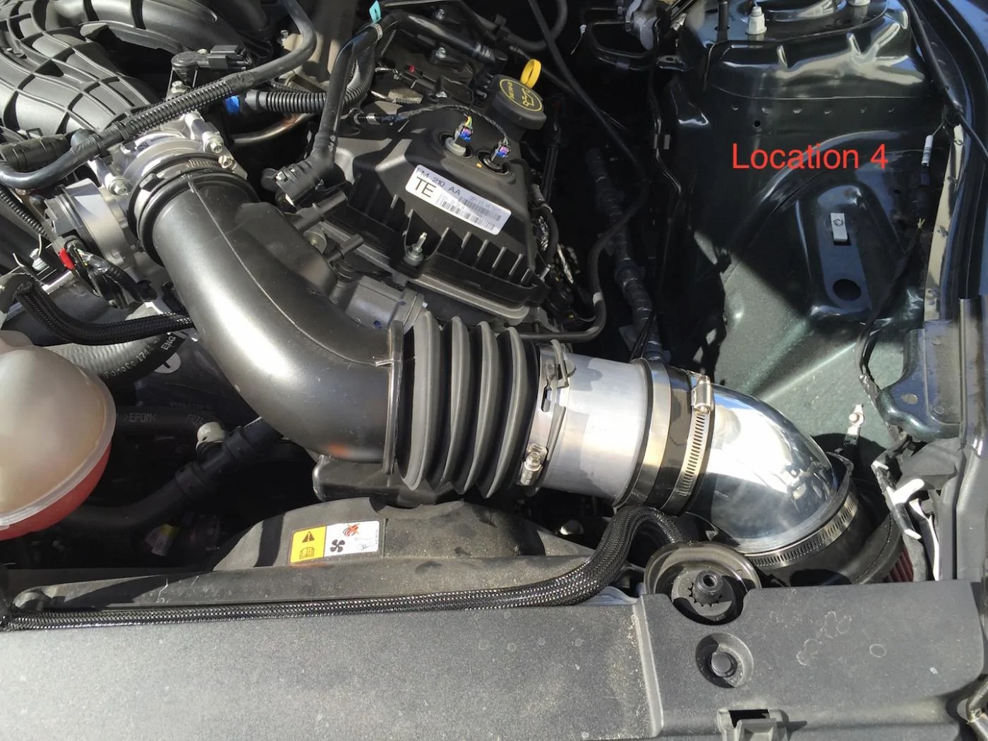

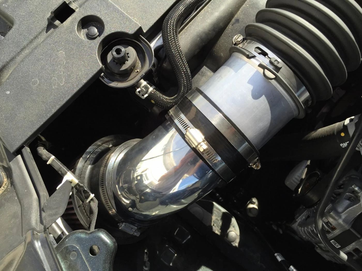

Location 4
IAT while at idle: 104-106 degrees
IAT while moving 50mph: 87-92 degrees
So it looks like location 4 is the winner. Power increase was noticeable but not amazing by any means. Most of the gain felt like it was in low to mid range power. Next step is to buy tubing to create my final CAI!
