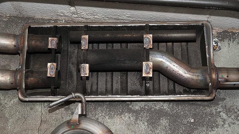

Inquiring minds want to know.. What is in the Suitcase under the car! Well it is actually a Resonator and now in part 2 of the mini series Inside the Stock EB Exhaust we find out what is packed in that Suitcase... for Science!
overall view. Inlet is on the right.. outlet is on the left.

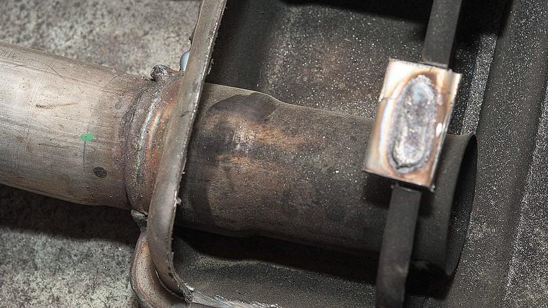

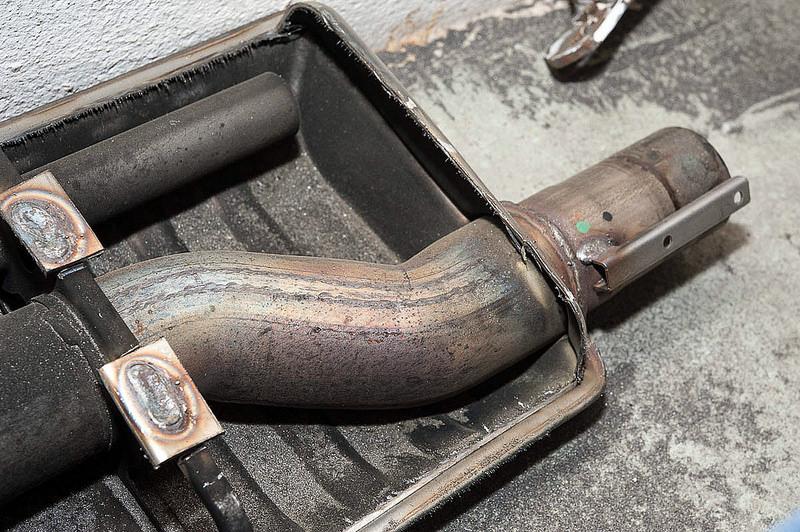

we start at the inlet which is surprisingly decent and steps up to 2.5" ID which is larger than the stock inlet pipe.

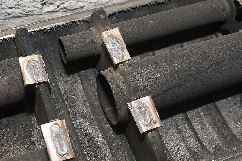

The single 2.5" offset bent inlet pipe ends and there is also a small diameter pipe next to it that part of the resonator but not a direct exhaust path (exhaust is not required to travel down that tiny pipe to exit.)

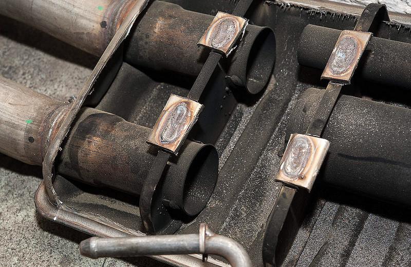

It then goes into 2 small diameter pipes to exit the resonator. They are 1.875" and step up to 2" as they exit and step up again after the exit.
