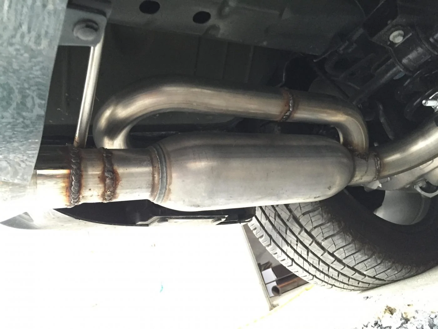

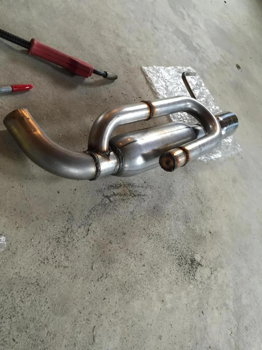

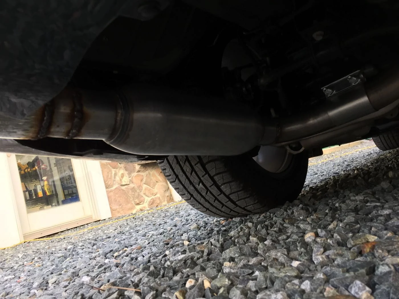

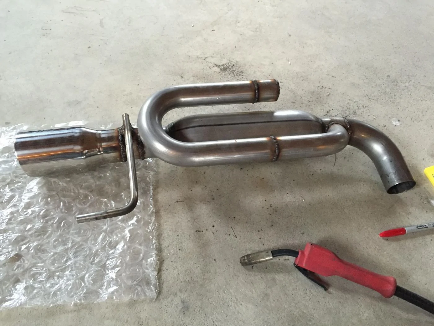

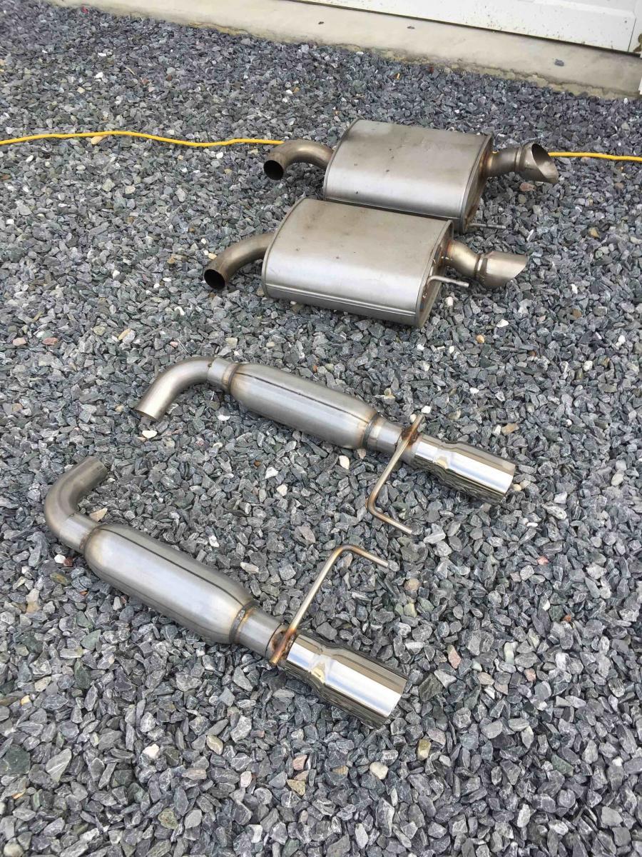

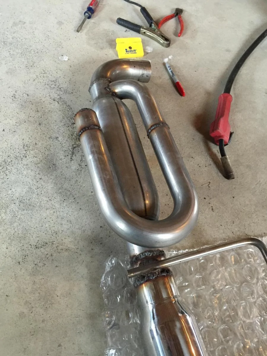

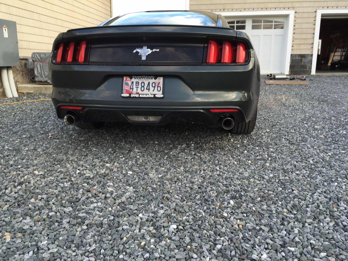

For the sake of not creating another new thread I am updating this one with my new exhaust. The details of my exhaust are below. There was a sizable amount of drone at 2k which I have since solved without effecting back pressure or changing mufflers. I created a resonator tube between the muffler and the exhaust tip that tuned to the right length created a sound wave to cancel out my 2k drone. It's called a 1/4 wave resonator tube or a Helmholtz resonator. Using a few equations from physics II and some assumptions on the speed of sound at operating temp I determined the length of tubing needed for each muffler. As you can see in the pictures below I managed to fit 33" of tubing within the stock muffler location. A bill of materials is attached below as well. Completed my system cost $355.98.
