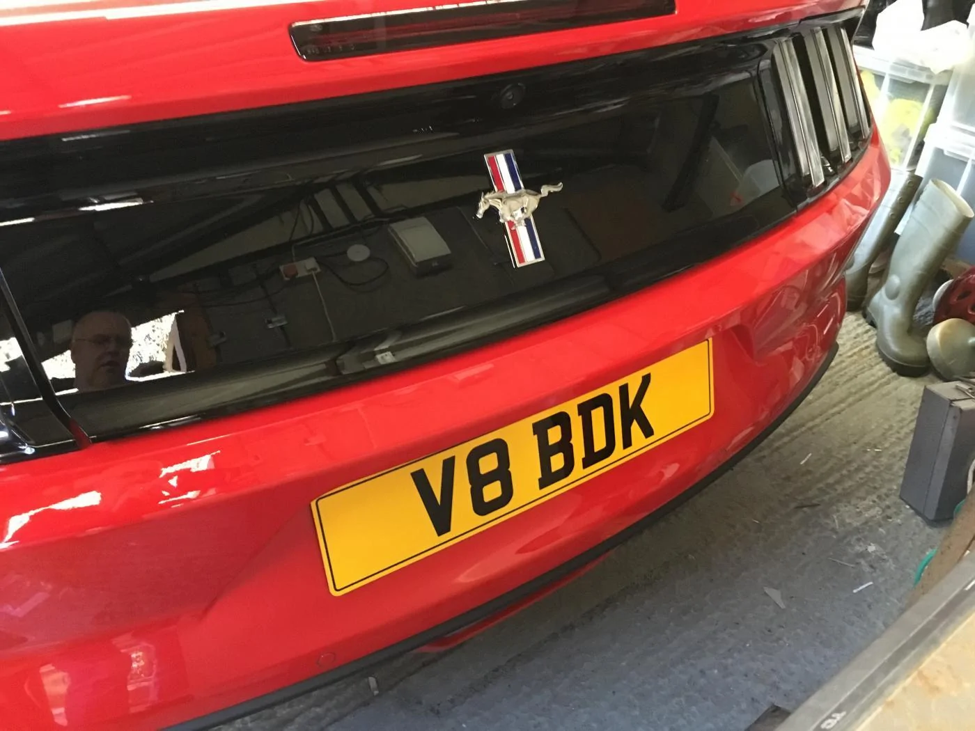

Just took delivery of the tri bar pony deck lid from Nemises.
Great service again, extreamly well packed and not a blemish on it.
Also got the matt black rear pony as I couldn't make my mind up what would look better so that gives me an option to swop it out :thumbsup:
Here's a question... the rear decklid is curved... is the black pony emblem you have therefore slightly curved as well?
Reason for asking is I've got a pony rear decklid to fit, but the black pony I have coming down to swap over onto it is the slightly larger one used for the front grille.
I know, being larger, that it covers the holes, but I don't know whether the curvature is going to cause an issue?

They're screwed in, pony is flat. :headbang: . They'll be fine if it's just 3m tape, think slowhand 3m'd his on :)

So far, so good. I think my emblem (a Pony Pack fender emblem) has more curve than the lid. I drilled for the pins and used the oem tape supplied on the emblem. Deck lid is a plain Ford Racing lid, which seems to be discontinued.

As Manders said, the rear is slightly smaller than the front, even though the decklid is slightly curved the badges themselves look straight.I would say your front one should fit as long as the pins are the same configuration but you could aways trim them off and just use the 3m tape.

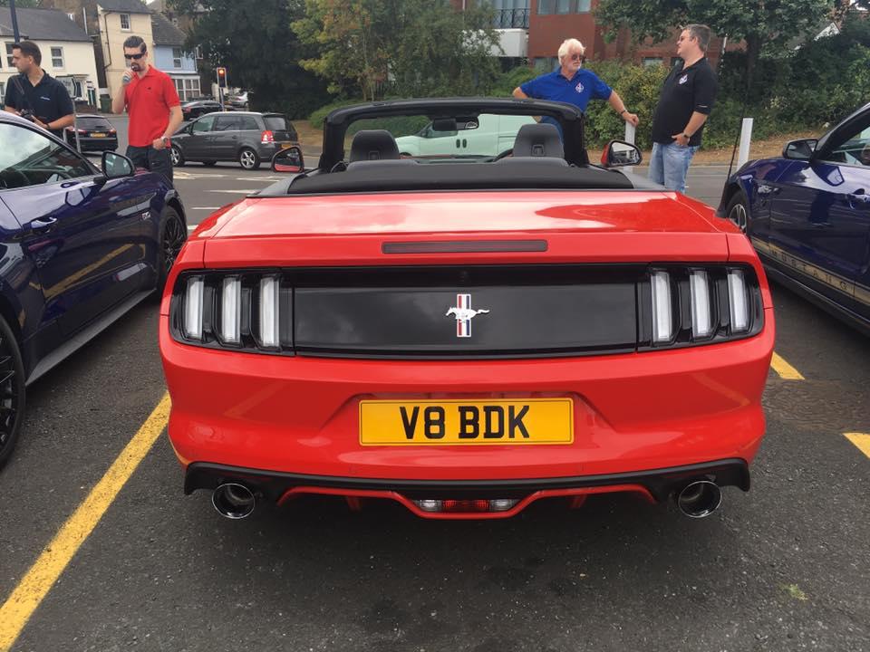

I bought a blank decklid and a black GT to go on it. Decided to remove the studs but don't think this was the best option as before long the edges of the flat emblem started to lift from the curved lid panel.

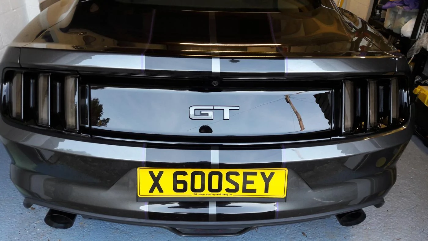

I like the GT badge, but rather than chrome look or Gloss black I noticed that CJPP did some body coloured ones and that got me thinking. SO got the GT with a decklid from Modurstang when I was there and had it sprayed Magnetic. I REALLY like it, but then I am biased.
