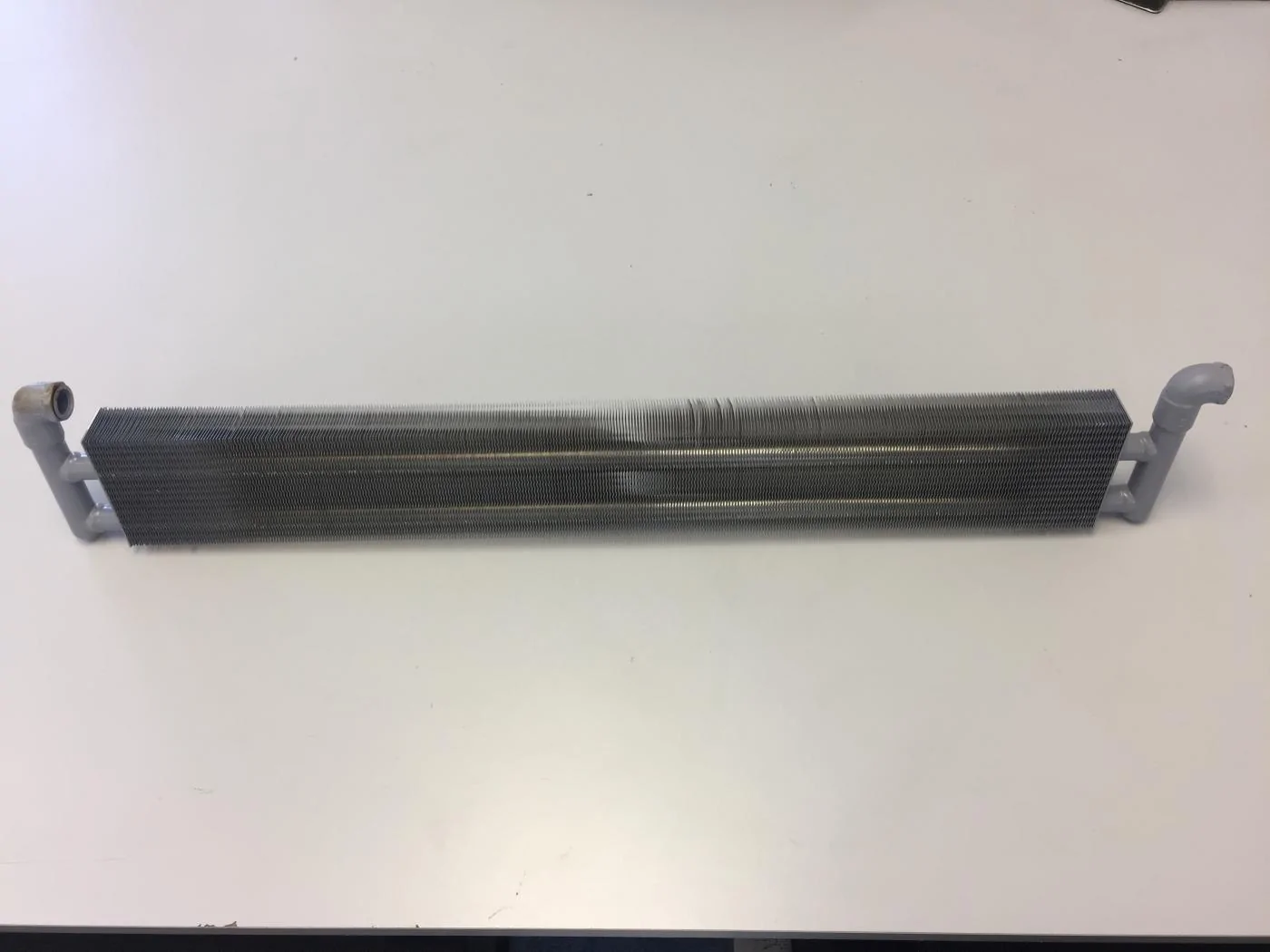

Steeda's solution to high oil temps after 15 laps, fits in the lower section of the front fascia. We used this style of cooler in the Cobra R Days.
Kept oil temps down in the 6 hour endurance races.
Am I seeing that you will be selling an oil cooler........... :eyebulge:
After it passes our track testing. This is one version we will be testing at Homestead in two weeks. keep everyone posted. The previous smaller cooler did not work well at all.
If you start selling your own oil cooler, would there be a way to install this without removing the front fascia? And possibly make it an easy enough install that wrenches won't get launched across the garage in conjunction with loud, horribly abrasive language?
