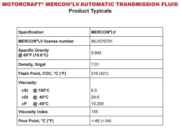

The Shelby is running Auto Transmission Fluid in the Tremec. For most applications it's fine. But it's not an automatic transmission is it? It has gears that spin around.
They market it with "Motorcraft® MERCON® LV is manufactured with high-viscosity index"
but then you look at the spec sheet and see that at 100C it's a 6 (rough numbers) a 5W20 at 100C is about an 8. ATF's are designed for what amounts to a hydraulic system. They do not offer the resistance to shear found in a manual transmission with gears spinning around.
Honestly I just haven't gotten around to writing instructions for the Shelby's yet. The non-Track Packs are easy, same as our Mustang Kits. I would honestly try a quality transmission fluid made for manuals. We of course recommend BG Syncro Shift.
