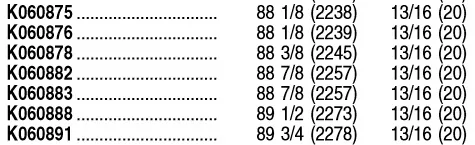

What I'm not clear on is does 88.8 mean the K060888, which is 89.5", or the K060883, which is 88.8" long. I'm wondering if Whipple thinks that the last 3 numbers in the part number represent the length, which is slightly off.89.1”.
Also, you can run 88.8, 88.6, 88.5, 88.4, 88.3 and 88.2 all work.
3.625What pulley do you have are you running?
They sent me a k060891 and I've run it with the 3.75 and 3.625 and works fine. I also have the double bearing idler on without any issuesWhat is the gates part number for the shorter belt that Whipple is sending? I've got conflicting information and no replacement belt yet. I'm just going to try and find one from a local auto parts store today and swap it. I can't take the noise any longer.
Whipple tells me...
