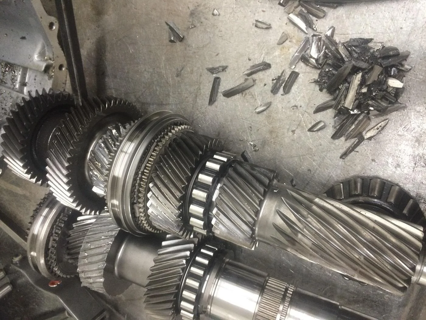

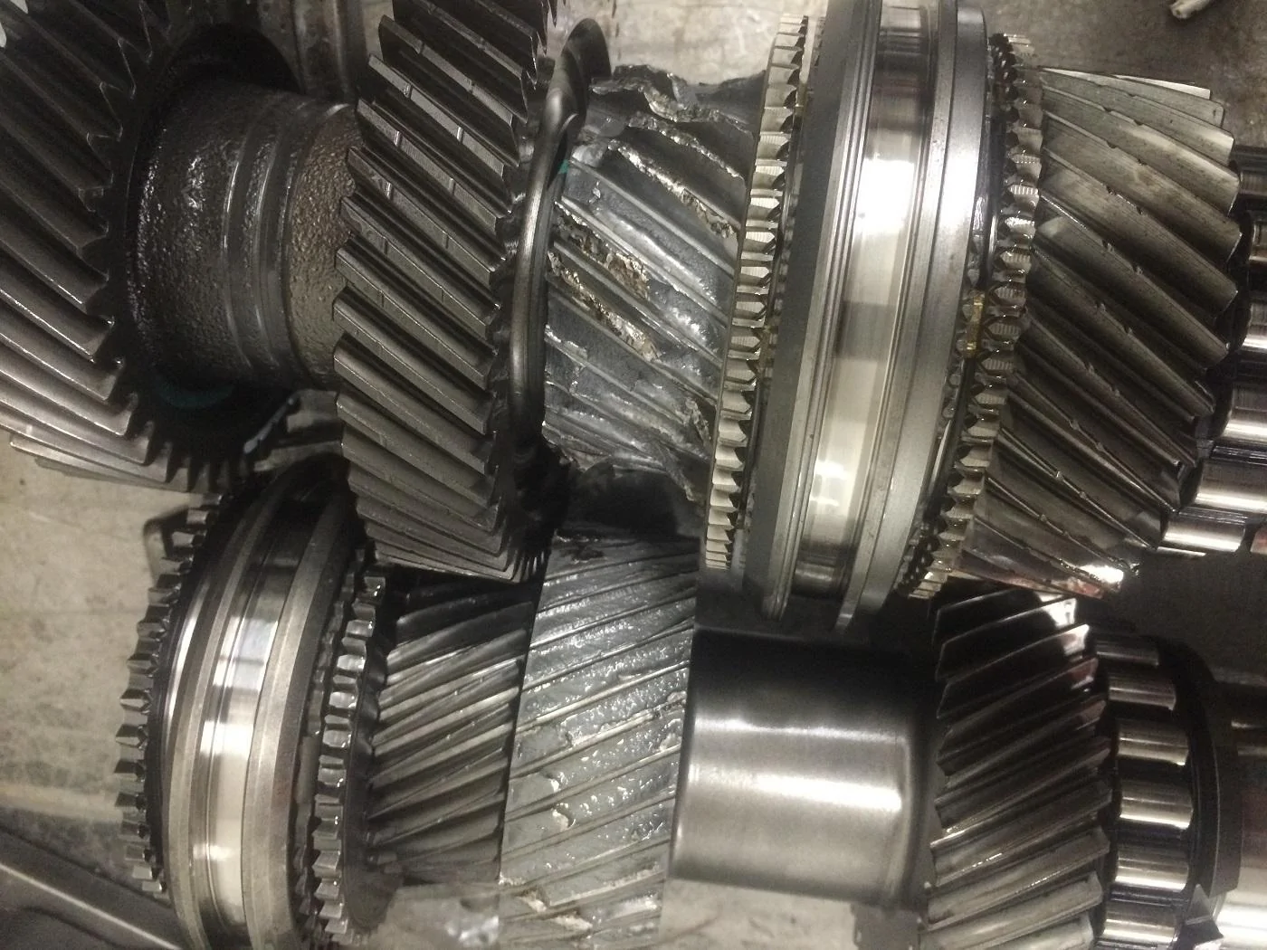

Unfortunately my buddy broke his transmission on 3rd gear :brokenheart:
He's thinking about sending to to Ben Calimer to get it rebuild. How has it been holding up so far? For those of you that sent it to him.
If not 2nd option is get the Magnum XL but that's more money.
The coyote is pushing 785 RWHP on whipple and e85. He may add more power down the road.
