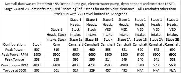

More interesting dyno results.
100HP gain with mild head work (stock valves and springs) and cam.
190HP gain with intake, mild head work (stock valves and springs) and upgraded CAM.
According to his post, these results should be able to be improved upon as well.
