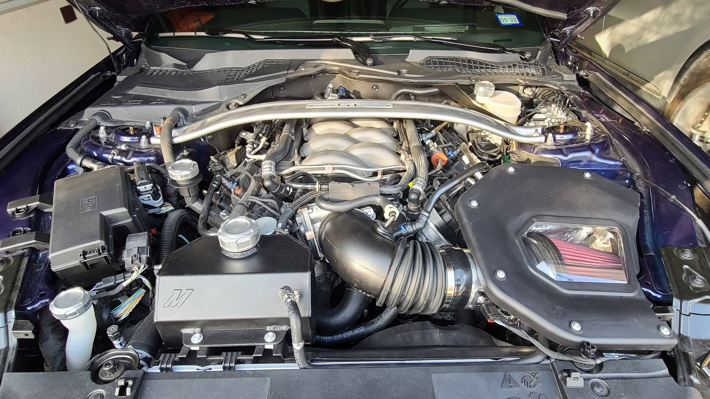

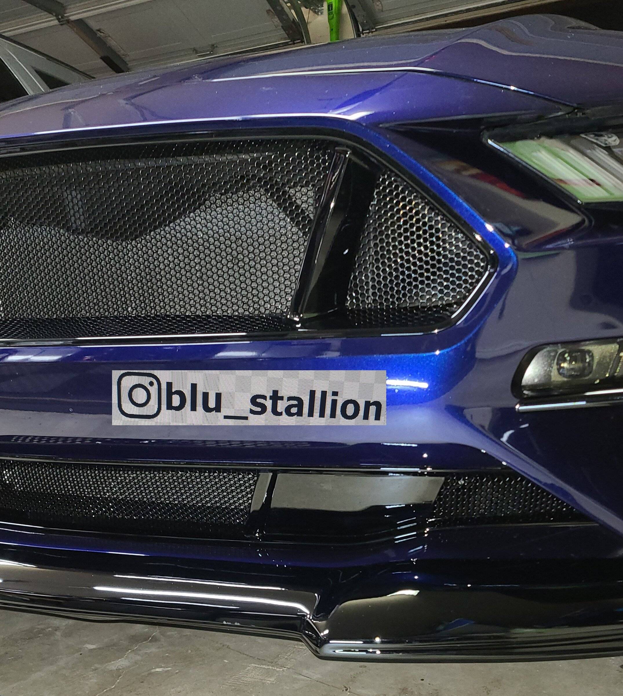

I went with the Roush. The closed box design seemed like a no-brainer for me for keeping hot air out. I also lined the inside and outside of the box with heat shield tape. But the best thing I did was change my grill to one with more of an open design to let more cool air into the air box. My IAT's are consistently only 3-6 degrees above ambiant as long as the car is not just idiling.
