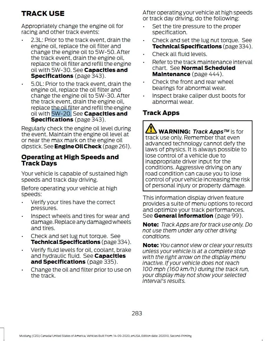

Less pressure as well. Pressure is King.As I've said in the past, 5W20's only real disadvantage is that it will shear down faster at high temps
Pressure is resistance to flow...Less pressure as well. Pressure is King.
That's generally how it works.Pressure is resistance to flow...
