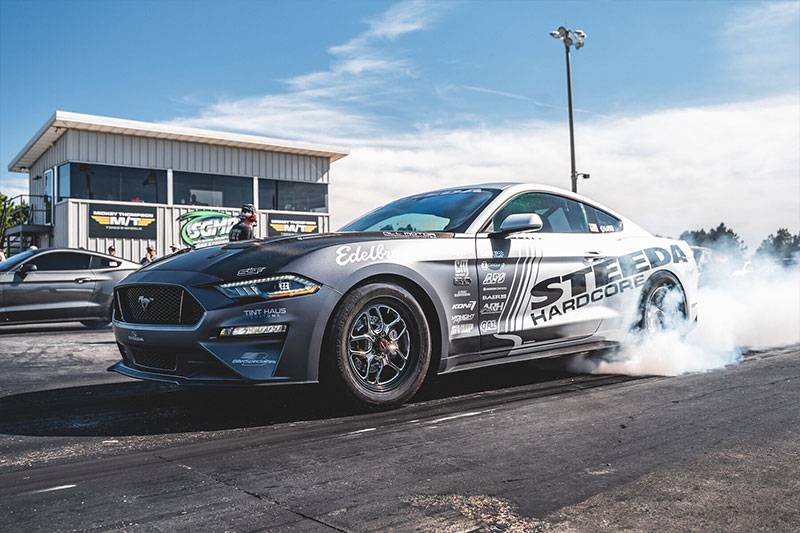

Over the weekend, we had a tremendous amount of success with our Steeda components, not only on our class winner - the Steeda Bullet but many of the other enthusiasts at Mod Nationals were running Steeda too - with similar results!
https://www.steeda.com/2021-mod-nat...104148585&mc_cid=cb51e4a101&mc_eid=07c1f44c27
Silver Bullet
The newly Edelbrock-supercharged Silver Bullet made its first major debut outside of video online running true street class against many other incredibly fast cars. In order to prove that this was still a street car, the Silver Bullet completed a 30-mile drive before running three consecutive passes and averaging an incredible time of 8.77 seconds in the quarter-mile. This brought home the overall win in the class with the lowest average time. This run, on the base tune, set our best time yet at 8.69 seconds down the strip.

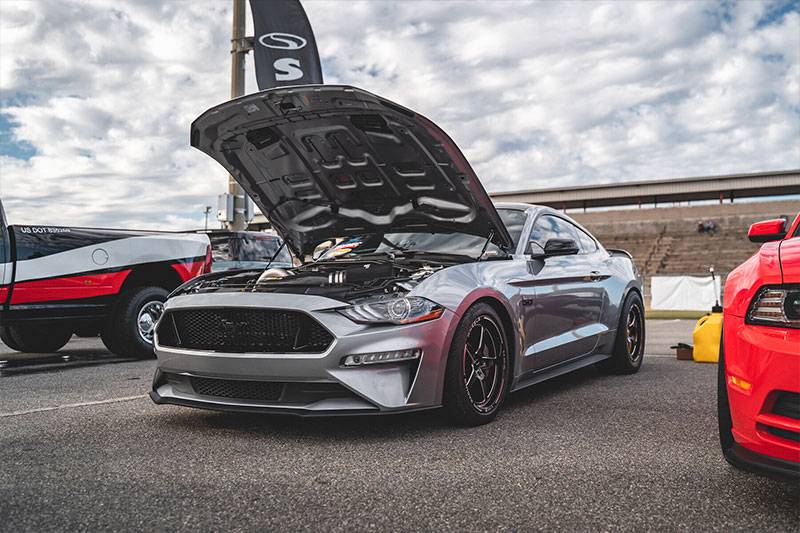

Leticia Hughes Racing
Many other vehicles that were racing were running Steeda parts as well, including the winner of the Grocery Getter class. Leticia Hughes won her class with a time of 10.31 at a speed of nearly 132 miles per hour. Her car has been setting high-speed runs consistently and continues to improve with each run. Running parts from both Steeda and Suncoast Performance, Hughes’ car has stayed in the high-9s and low-10s range every time.

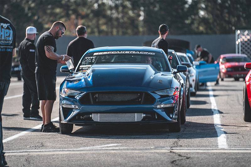

Beefcake Racing
Terry Reeves from Beefcake Racing ran a personal best for his 60-foot acceleration with his full-weight 4,000lbs car. Running the Steeda Stop The Hop Ultimate Drag kit paired with his performance upgrades, Reeves got his 60-foot to 1.27 seconds. This insane time would not have been possible without our kit, according to Reeves.

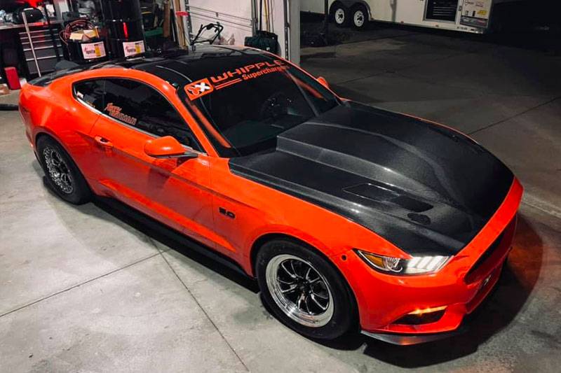

Road Cone Terry
Terry Eshman (AKA Road Cone Terry) had been building his car for months to set it up as the fastest it has ever been. He went on to run a personal best in the 7-second range at 7.9 seconds at 178 miles per hour in his 2015 Whipple-supercharged Mustang GT using Steeda suspension. With this setup, his drag car was able to push harder than it had ever run before and was still being driven afterward.

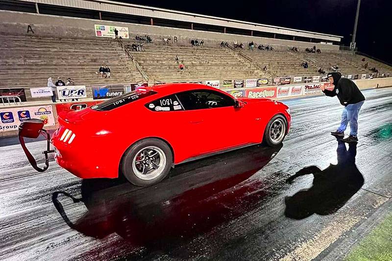

Cory's Twin Turbo S550 Mustang
Driver Cory Graley also set a new personal best with his S550 Mustang GT. Running Steeda parts on his car, Graley ran his car hard in every heat. Although he hit a few snags, such as issues with his boost controller and steering rack issues, and more, his twin-turbocharged stock motor pulled the car all the way to an 8.60 at 158 miles per hour which won him his class.
