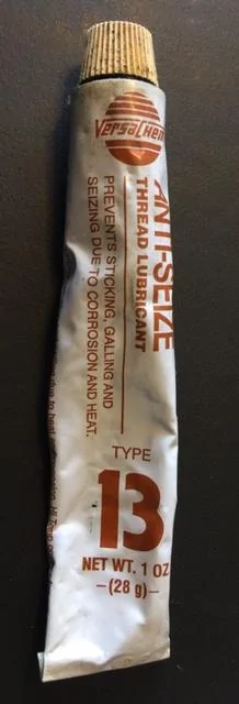

I've spent quite a while trying to clean up the hubs and the adapters so they can go back on. after a hard lesson, now I know to use Aluminum Anti-Seize Lubricant on them before installing. If you put wheel adapters on and didn't use anti-seize on them, I encourage you to give it a look.
