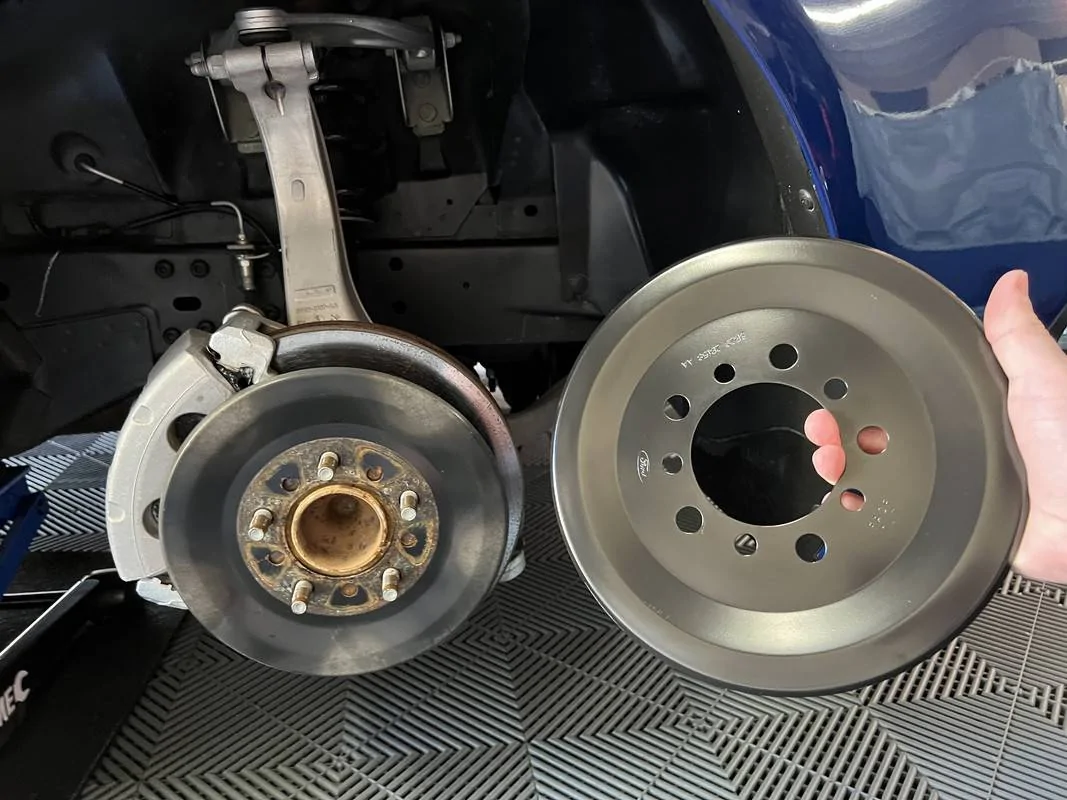

Finally, the replacement dust shields arrived at the dealer today.
What do think, should I ceramic coat these too?

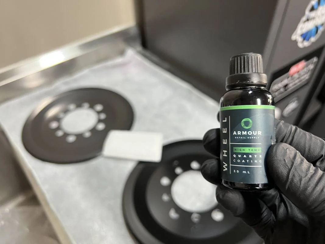

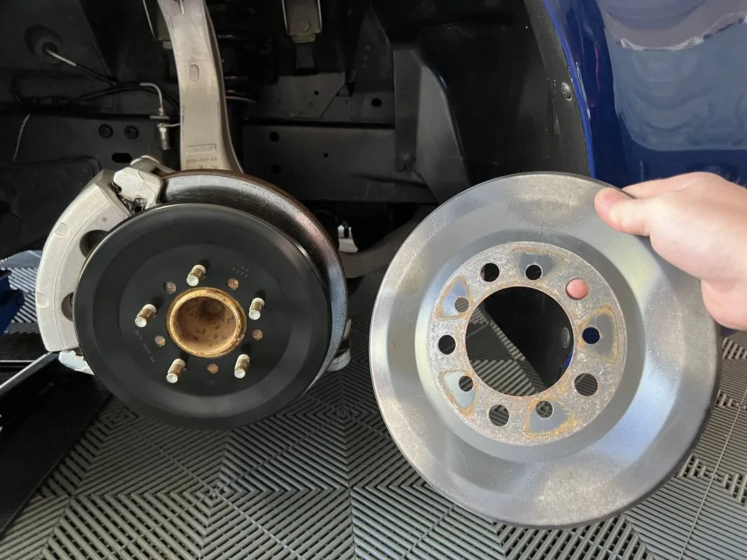

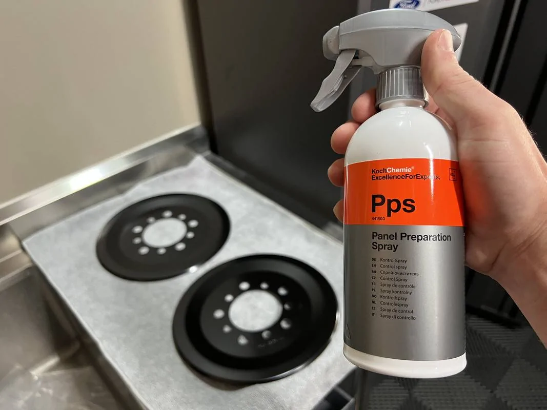

As a mere formality, naturally the new dust shields were coated! I even considered hitting them with polish, but these are not clear coated so the ice would have been thin.
First, a wipe down with KCx PPS, followed by a final wipe over with IPA (these were stored in sealed plastic but they had an oily smell to them, so I wanted to be through here.)
Next, the coating, applied front and back. Because these are effectively matte black, every smudge ends up looking like a high-spot.
After curing for 15 hours, I applied a coat of Carpro Reload.
New vs Old............
Naturally, I could have painted the hub too, but even I have a limit.

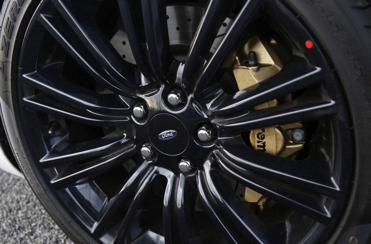

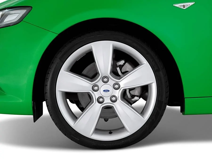

Ideally, I would love to replace those brakes with Brembo's. The standard brake system on XR6's is pretty overwhelmed, you really only get one or two big hits out of them before they start to shudder. The conversion itself is seemingly easy, all you need is the parts used on FPV models and the FGX XR8's, all are simple bolt on's.
But..................Brembo's brakes don't fit behind those wheels. I love the design of those wheels, so I'm not prepared to sacrifice them for a set of brakes that would show their worth only occasionally.
I did have someone tell me that Brembo's do in fact fit behind those wheels, but I think he had his wires crossed. Having a set fitted to the XR8, I guess I could easily find out myself.
If they did fit, I would actually buy the XR8 a new set of Brembo's with the 6-piston caliper front / 4 piston rears, then put the 4 / 1 piston setup on the XR6. Not a cheap exercise though.

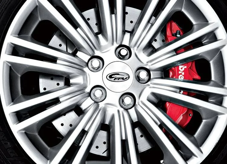

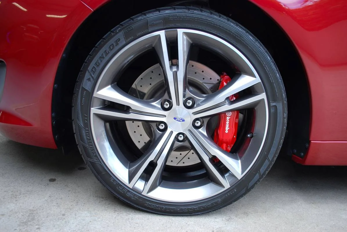

There you go, I thought all XR8s had the 6/4 comb. The 6/4 set up was once the big brake bargain of the century. I bought a near new set on ebay once for 3.5k including discs with the intention of fitting them to a GTR, sadly the price of caliper adapters made it uneconomical and folks were then waking up to that fact that a set of Evo Brembos could be made to fit for half the price.
Not that I think it's not worth doing, rather I like the wheels more than I would want a decent braking setup. At the end of the day, it's basically a semi-glorified taxi, so expecting it to have race car brakes is probably unrealistic.
The other option would be to change the caliper and disk to the slightly larger XR6 Turbo system, which has a larger twin-piston PBR caliper and 322mm disks vs 298mm. They are a straight swap. However, I feel the difference wouldn't be all that noticeable, and I'd still left with the basic aluminum caliper rather than the lovely Brembo red.
The FGX XR8 only got the 4- piston Brembo /1-piston PBR setup from the FPV GT, Pursuit and F6.
On FGX, only the XR6 Turbo Sprint and XR8 Sprint models got the 6/4 setup, painted gold rather than red.
Otherwise, only FPV GT-P, GT-F, GTE and F6E got the 6/4 system as standard, was optional on GT, Pursuit and F6. If you optioned the 6/4 setup on the Super Pursuit, you only got the 6-piston front calipers and not the 4-piston rear because of problems with pad knock off due of the leaf sprung axle.

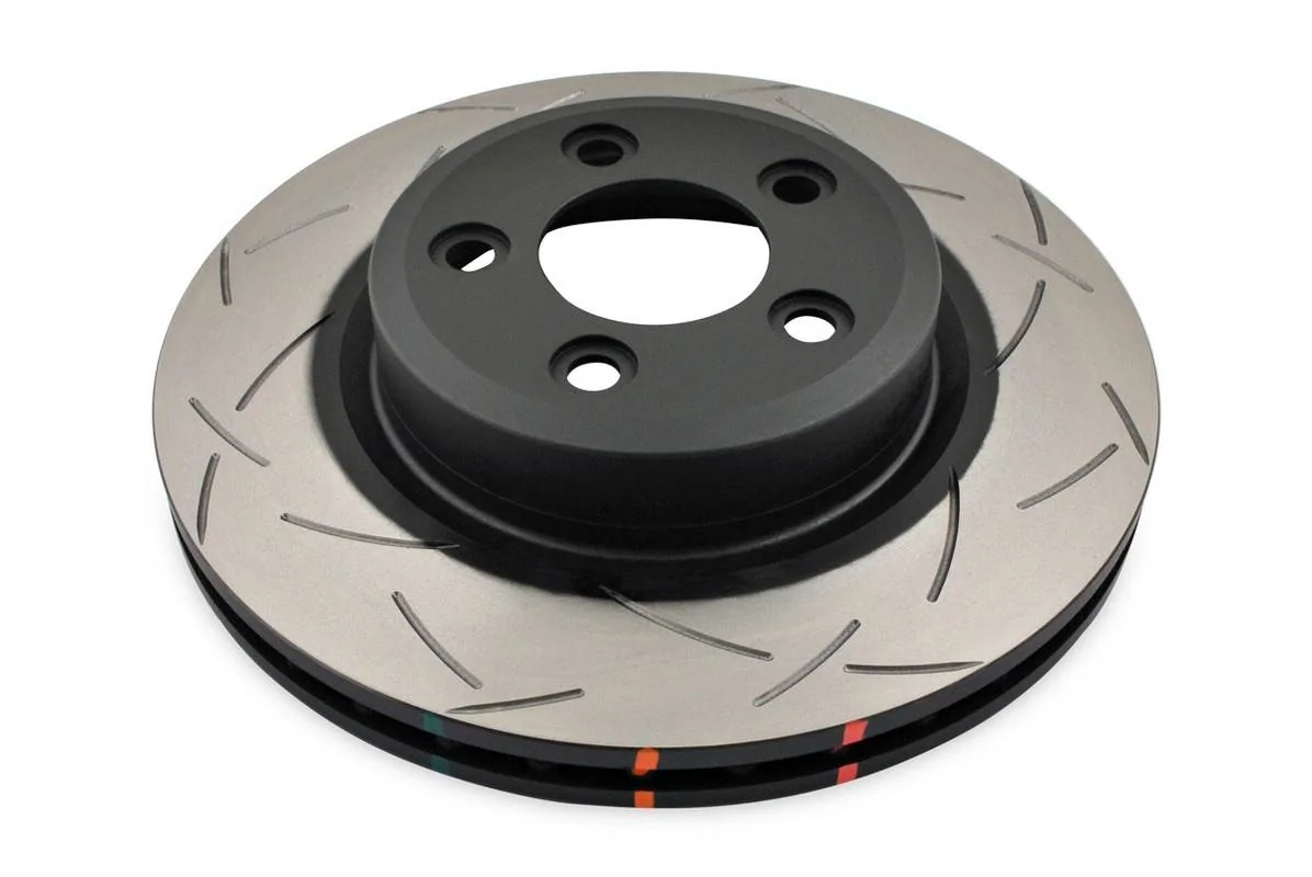

Well, I'm getting deeper and deeper down the brake upgrade rabbit hole! :facepalm: :giggle:
The basic Falcon brake setup on my naturally aspirated XR6 has a PBR twin piston caliper and 298mm x 28mm ventilated disk on the front................
...........and a single piston PBR caliper with a 303mm x 16mm solid disk on the rear.
For the XR6 Turbo and 5.4 XR8, Ford changed the front rotor to a 322mm x 28mm ventilated disk. The front caliper and entire rear setup remains the same.
So, the easiest brake upgrade for my XR6 would be to change the caliper support bracket to the high-series item, which would then allow for the use of a larger 322mm disk.
Rotor wise, I would then replace all four corners with DBA T3 slotted items, 322 x 28 on the front, 303 x 16 on the rear. Then change to Project Mu NS-EP pads all round, which are apparently low dust/noise street performance items.
So, I'm hoping the higher quality rotors all round (larger on the front) with upgraded pads and a fluid change will get the brakes to a standard I'll be happy with. I also have the option of changing the brake lines to braided stainless steel for an additional $298, but I might see what pads and rotors delivers before doing that.

I've installed those DBA rotors for my Mustang and I'm very impressed there is almost no brake dust! Breaking quality is also very impressive.
