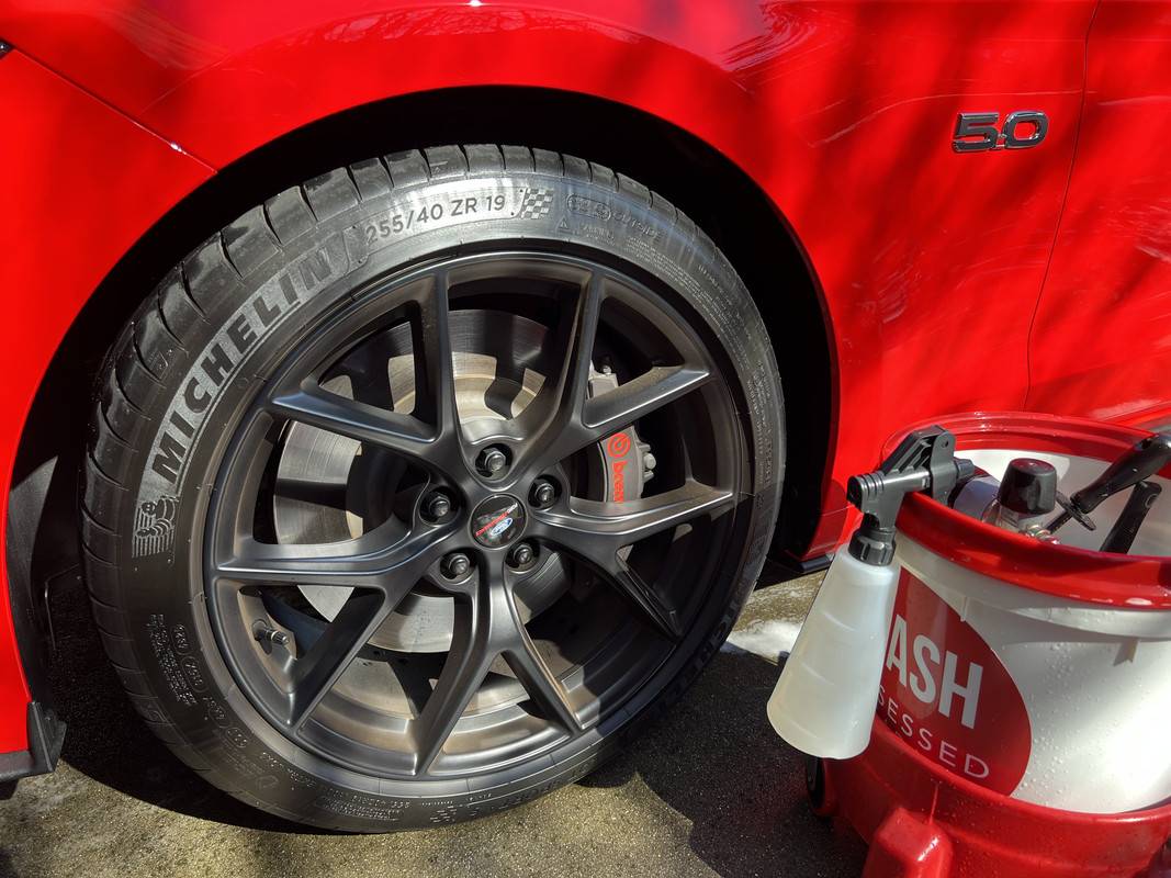

See, it does get kinda dirty sometimes................

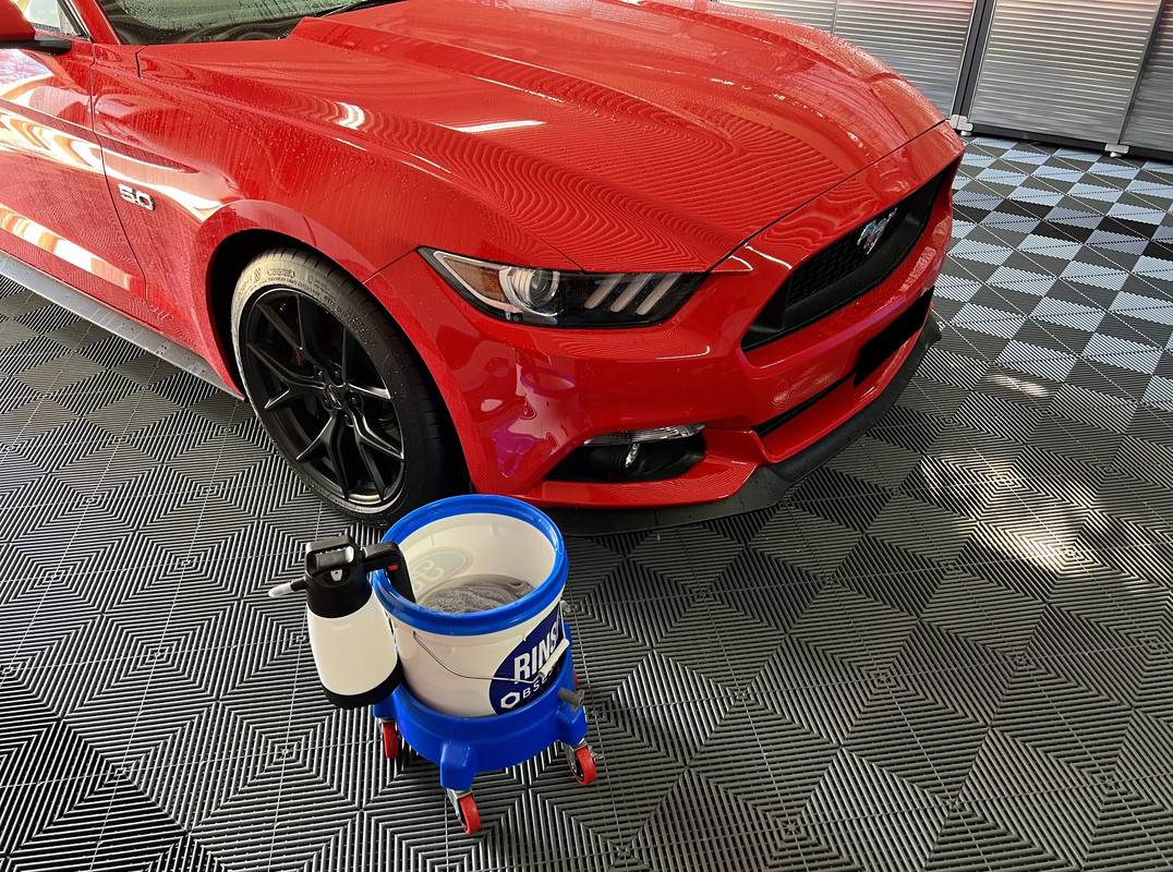

The Mustang has been the errand car over the last two weeks. I tend to have the one car uncovered and driven while the others are clean and covered. I then rotate them around like this.

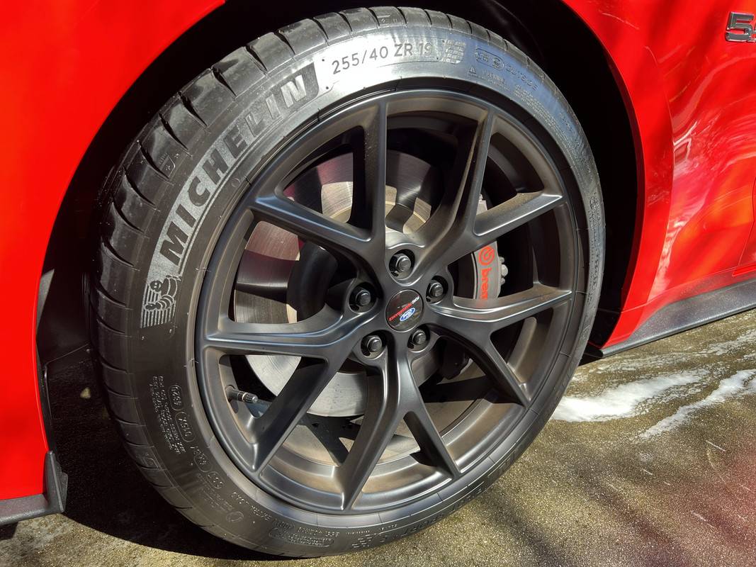

For the wheels, I did them OG style, as in the bucket is the carrier of tools and actually has no water or soap in it. The wheel is then rinsed and foamed with Brake Buster and the tools rinsed with the pressure washer as you go. For cleanish wheels like mine, this method works very well and saves on cleanup afterwards.
I then gave the car a quick rinse down before moving into the garage for a rinse-less wash with Absolute instead of a foamed contact wash with soap.

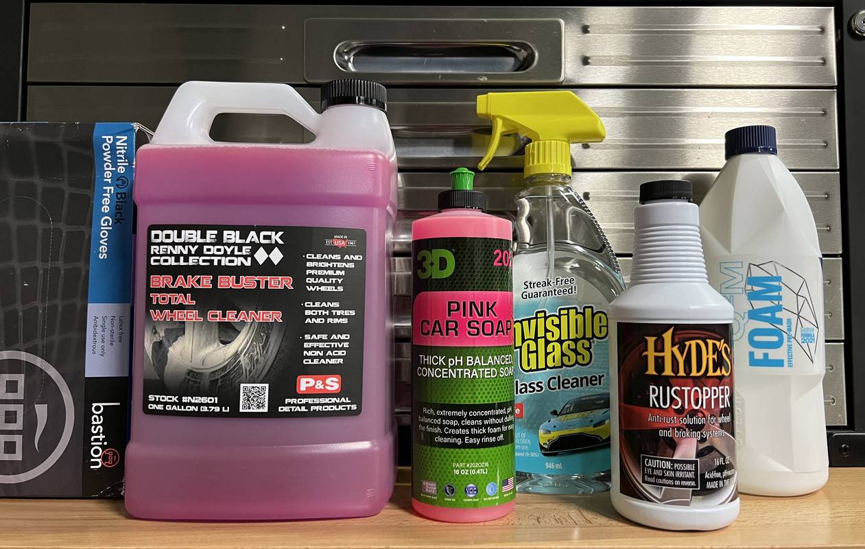

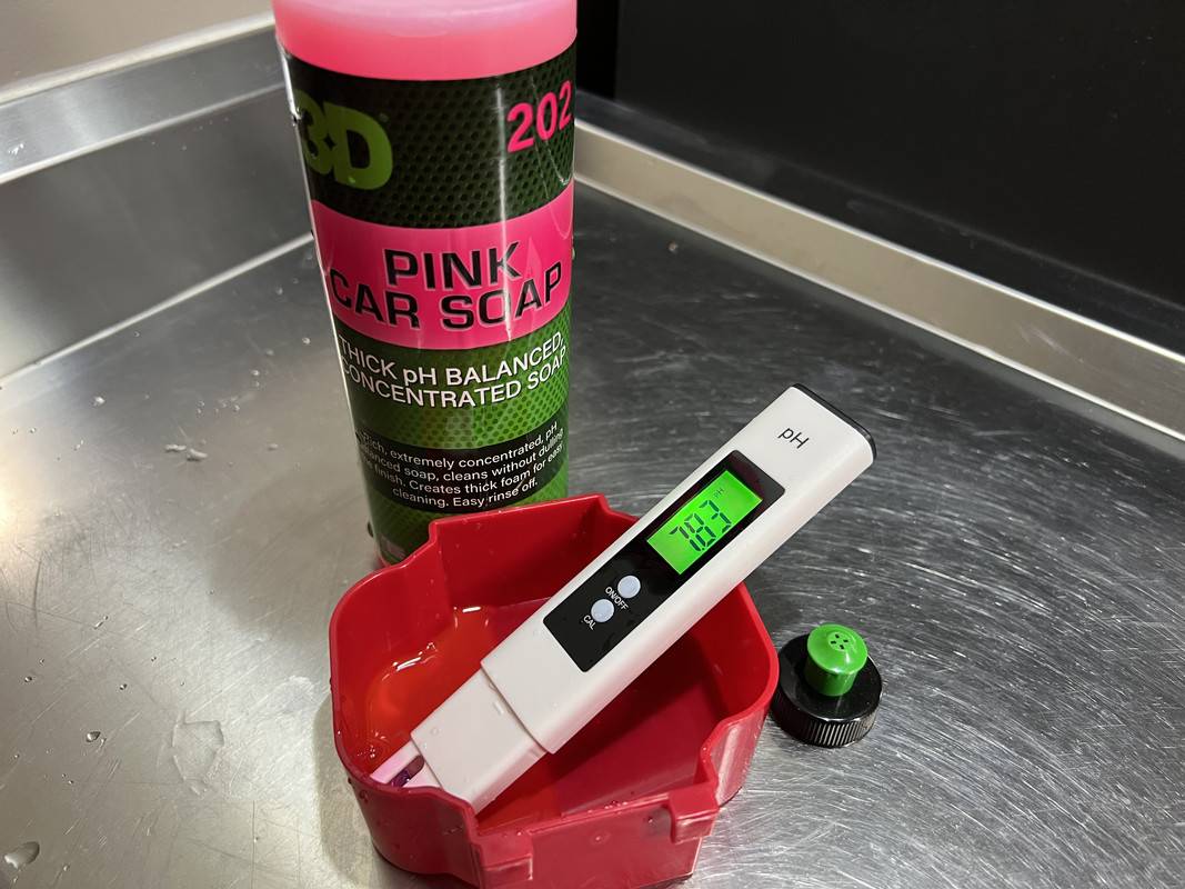

Latest Detailing Shed order................
Two new to me products, Gyeon Q2M Foam and 3D Pink Car Soap.
Gyeon Q2M Snow Foam 1L/4L (detailingshed.com.au)
3D Pink Car Soap (473ml/3.78L/20L) (detailingshed.com.au)
3D is new to Detailing Shed, a US brand aimed at professional detailers. Pink Car Soap is very well priced for what you get, a gallon is just under $44, and is pH "balanced". The consistency is ultra thick, not an ideal thing in my book, and I'm really interested to see how it foams. A quick pH test reveals it being just above neutral, hence the "balanced" term, reading at 7.8.

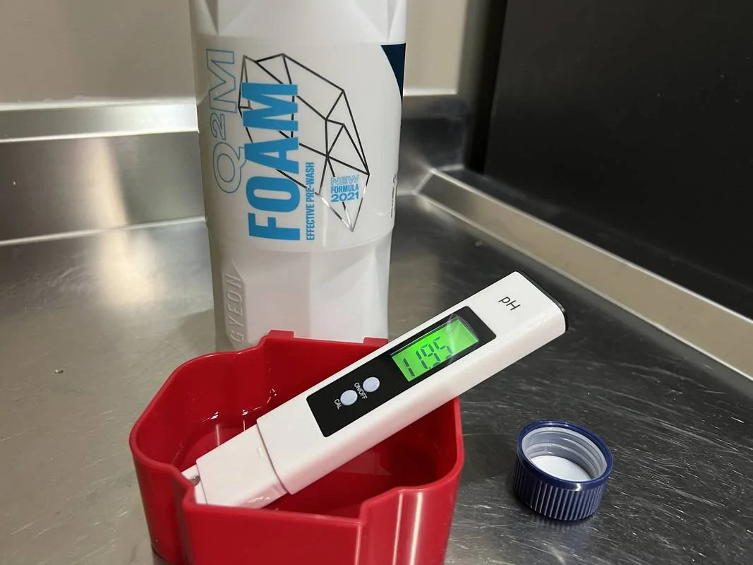

Gyeon Q2M Foam is one that I have heard a lot of good things about. Interestingly, Gyeon do not list a pH level for this product, be that on their own website or its distributors.
Q²M FOAM - Gyeon

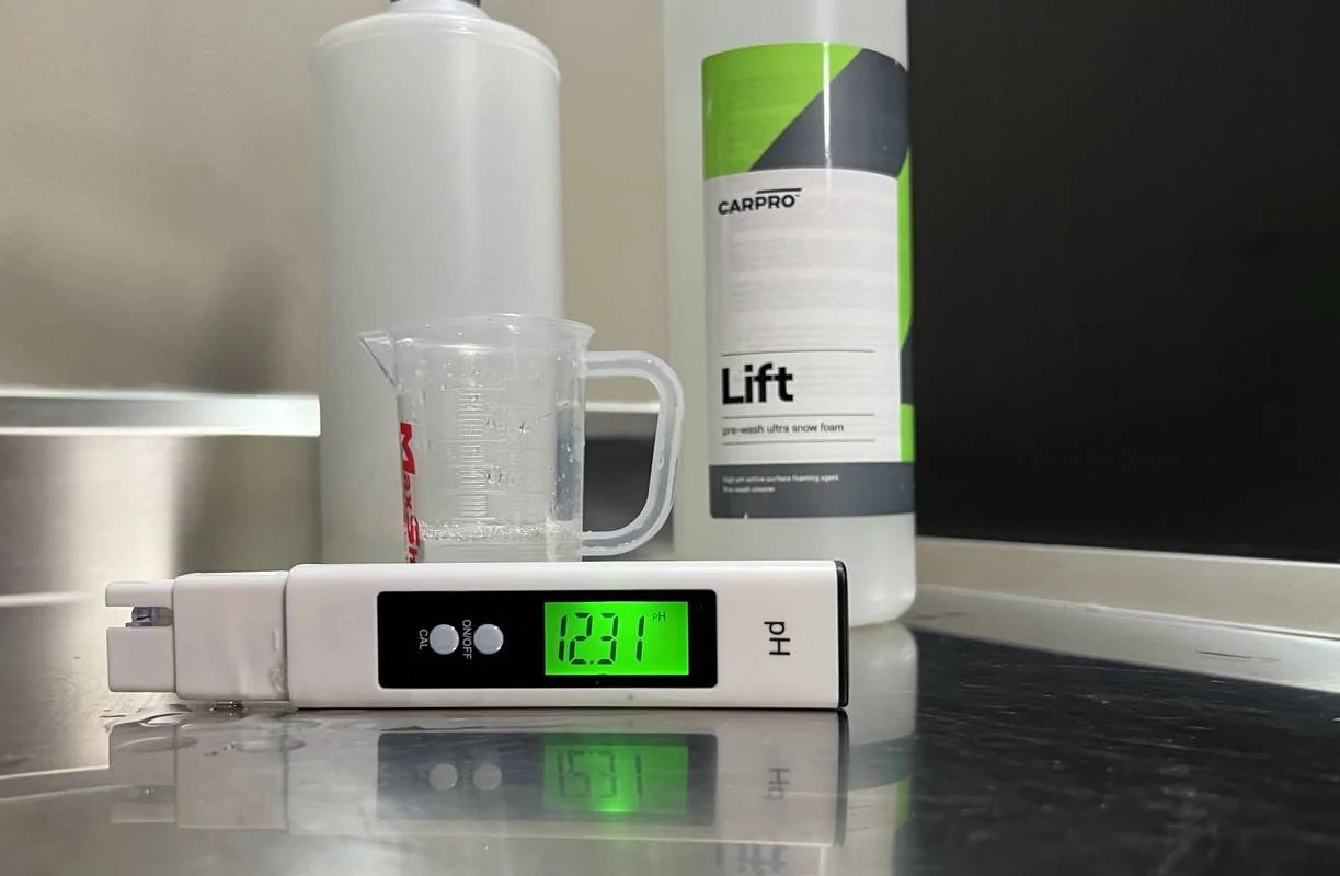

Terms like "pre-wash foaming agent" or "a highly effective first step in the cleansing process" is the clue. Testing Q2M Foam revealed a pH of about 11.95.
Which is line with the sister brand's similar product..................
So that's where the cleaning ability comes from. This not a bad thing, far from it. As a stronger soap to use occasionally on a ceramic coated vehicle, this product would be great thing to have on hand. On a waxed vehicle, I would probably only use this as a strip wash prior to reapplying said wax.

I have a bottle of Gyeon Foam and have used it at least twice now. I do indeed compare it to Lift. I'ts amazing how much all the top shelf detailing products overlap. I was messing around last night and looked at both Carpro Eraser and Gyeon prep. I took the lids off and smelled of them, they smell absolutely identical. Same fragrance. Hmm, I guess I will buy whichever one is cheaper as they both work fantastic :) Same with Bathe+ and Carpro Hydro Foam, Iron X snow and Restart. Only brand I have found that sorta goes their own way is KCx, theirs are a little different.

From what I have been told, Carpro and Gyeon products are made in the same factory, so the cross-over in products is not all that surprising.

3D makes good stuff. Their one step polish, 3D One, is one of my go-to’s. I’d say it’s right up there with Sonax. Gyeon Foam has been on my list but I haven’t pulled the trigger yet as I still have a half bottle of Lift. I’ll give it try after I finish off my bottle of Lift
