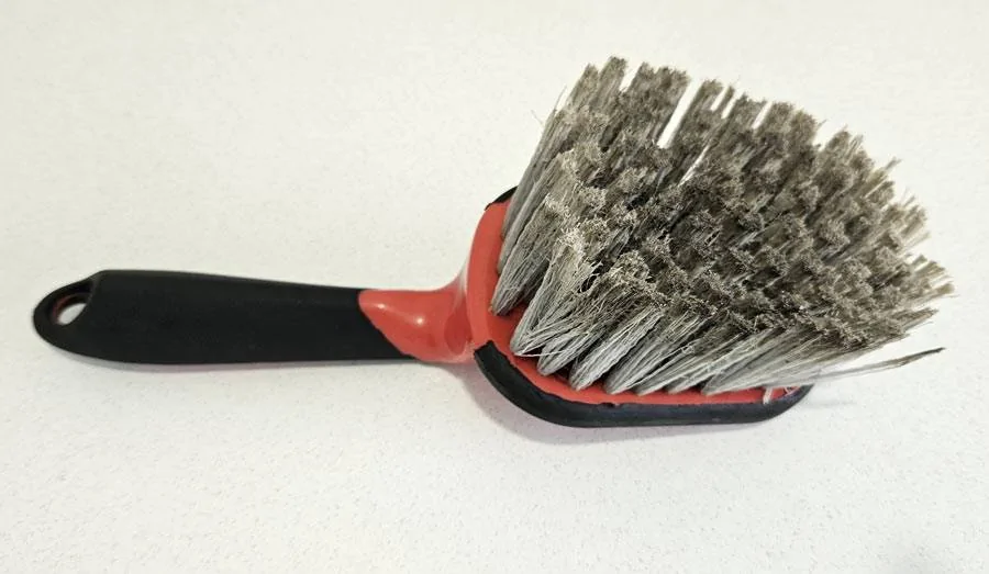

What's the preferred method (read as: most effective) for cleaning wheel brushes?
Dish soap doesn't quite cut it.
Is there a concoction I need to brew?

When you consider what these brushes are being used to remove, and the chemical used to do that job, then you are dealing with the same thing on the bristles...................as in old dressing and the need for alkalinity to break that down.
Having said that, I've found only certain tyre cleaners will do the job here. For example, Brake Buster won't be powerful enough, which is about right considering its designed as a mild to moderate wheel AND tyre cleaner.
The dedicated high-impact rubber and tyre cleaners have worked well though. Think Shine Supply Wise Guy, P&S Undressed, Adam's Rubber & Tire Cleaner, Carpro ReTyre. Normally, you wouldn't use APC concentrate at full strength, but in this case undiluted Green Star, Carpro Multi-X or Optimum Power Clean would be worth trying too, just be sure to rinse well afterwards.

I was going to say an APC mixed like 4:1 or even stronger. I keep a bottle of Green star at 5:1 for heavy lifting and use it very infrequently, normally 10:1... That is my go to for tough jobs like that... as for tire dressing, other than the little round makeup brush, I can't bring myself to use a brush for that.. I still use the little small microfiber sponges, and just discard afterward. I buy in a 24 pack cheap off Amazon...

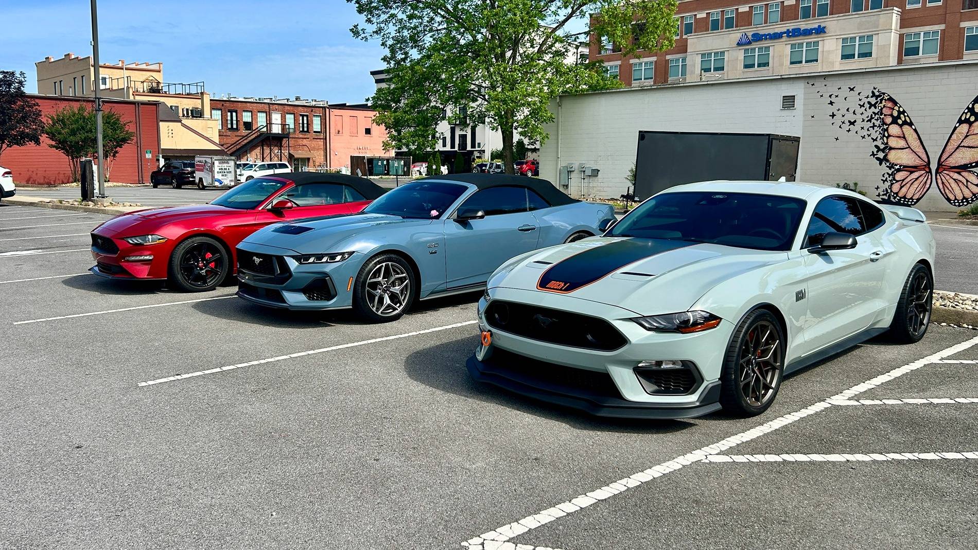

Pre Pamper photos :) This S650 is coming in tomorrow for the full Monte treatment. I got a good look at it today as we went out for a good drive, man it needs some LOVE.... To be a 2024 model the paint is trashed :(

Those are the wheels I REALLY wanted for my S650!

I like them, they do look good. I have a friend that got a set for his S550 last week as well, they look good on a S550 too... Picture attached, not the best pic but you get the idea... Jury is still out how well I like them til after I pull them from the car and do a full decon, prep and coat :) something tells me they will be as difficult as my birdcage wheels :crackup: :crackup:
