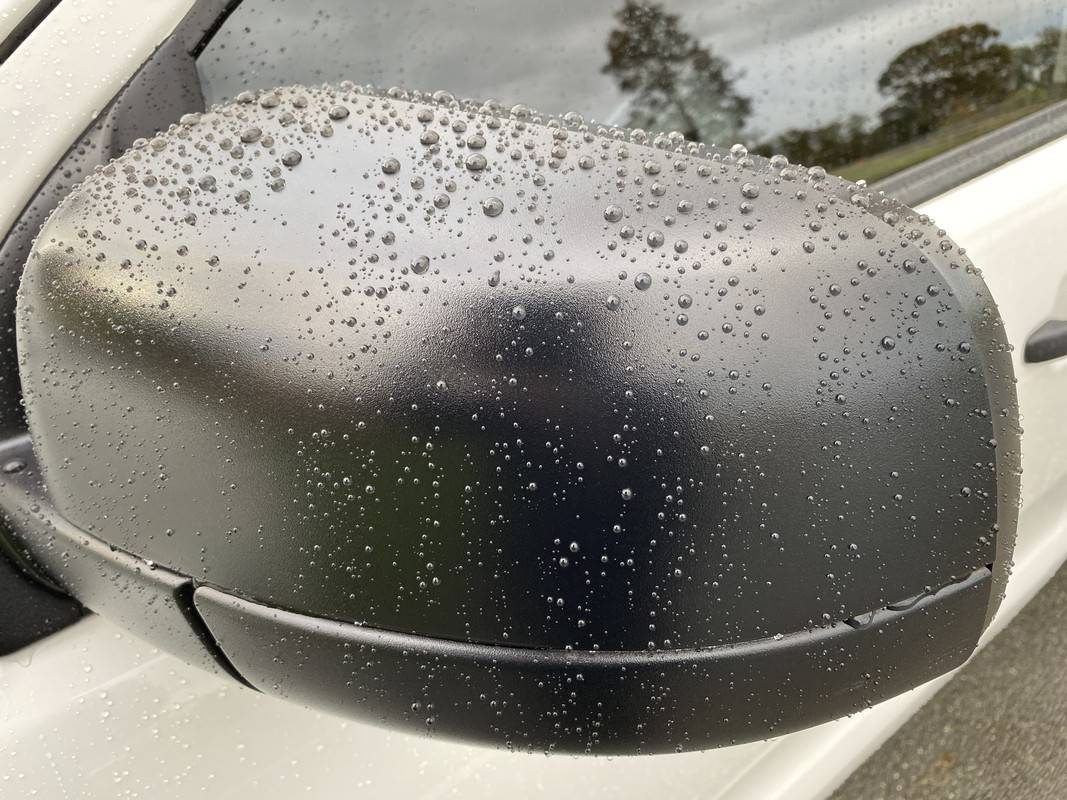

I Second Reload 2.0 for black plastic trim. I use it on mine and it really enhances the finish very nicely.. And is completely safe for paint too....

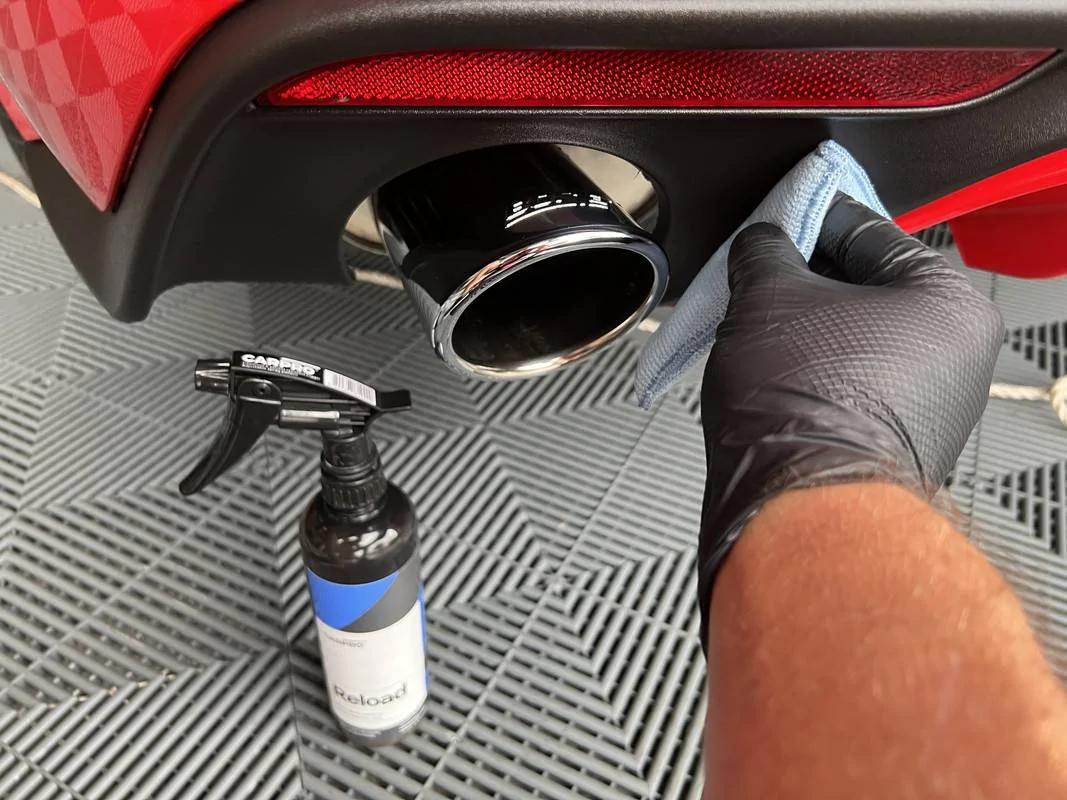

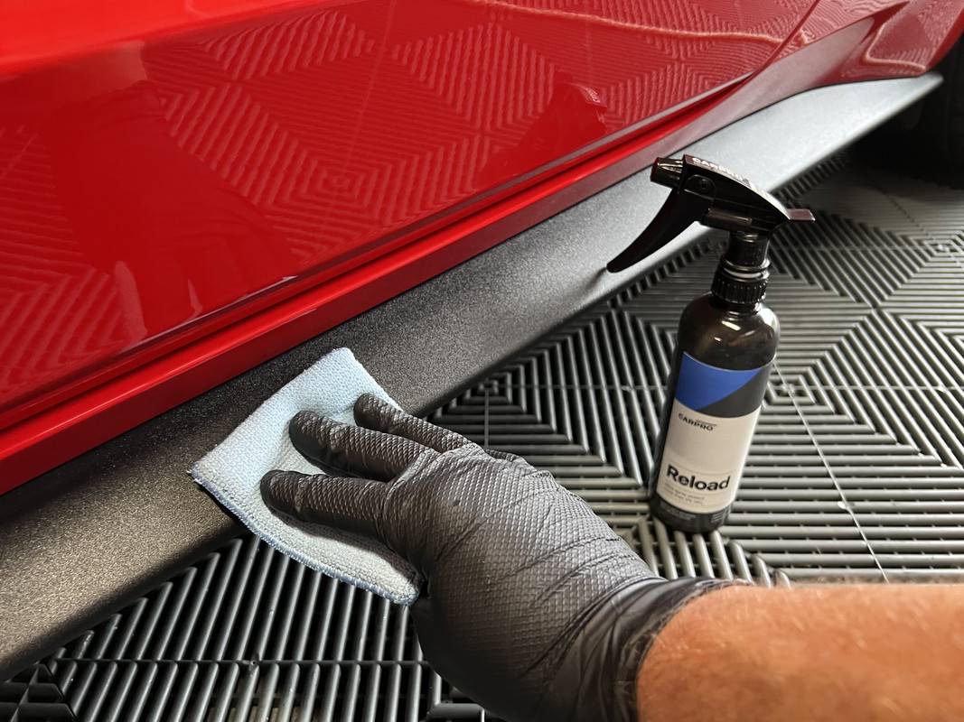

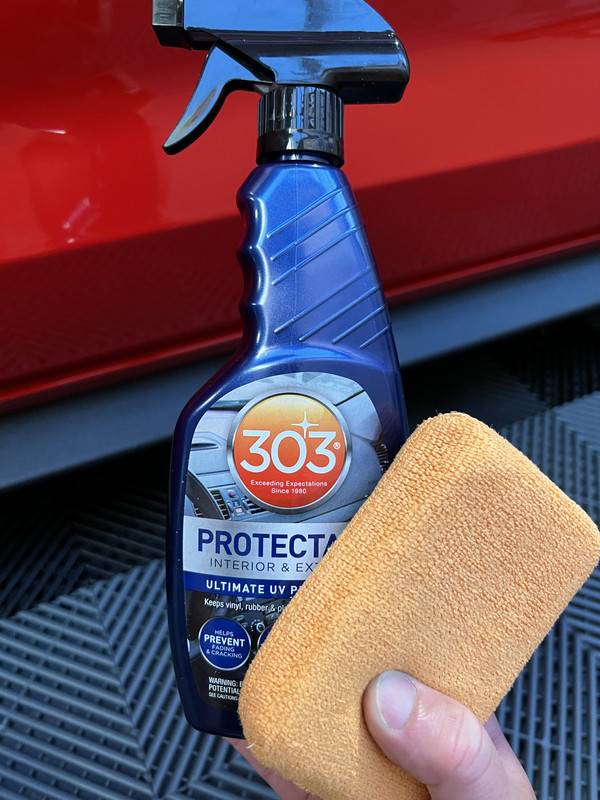

I went from applying 303 after every wash, almost like a ritual finishing touch. I'm not sure where I discovered using Reload on trim, but I'm glad I did because it works fantastically well. Compared to a dressing, you don't have to be ultra careful in not getting it on paint or glass, and it gives these surfaces some hydrophobic qualities, in turn making future cleaning easier.
In terms of application, after cleaning the car, use a prep spray (Eraser, Prep) to wipe over the trim and plastics you intend on treating, allow 5 minutes for the prep spray to properly evaporate. From there, apply using a towel or microfiber brick. I've found you won't need a separate towel to level as it tends to do that for you.

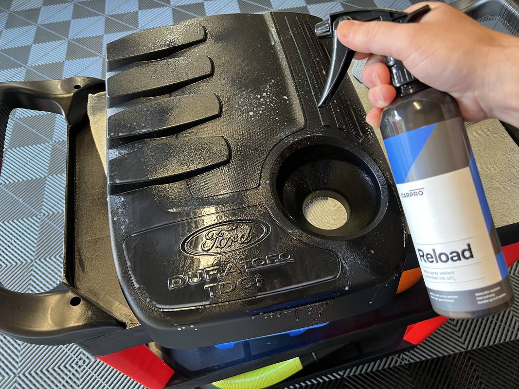

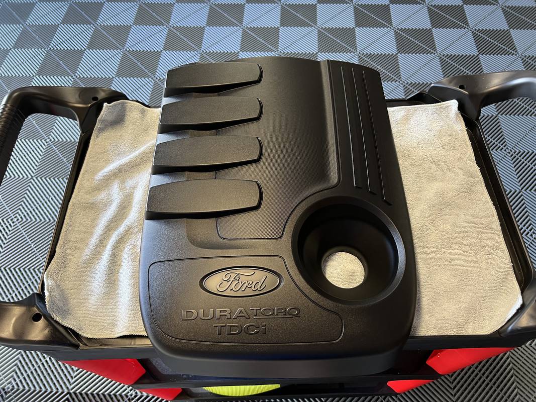

In addition to the Mustang's lower trims and window rubbers, I've also used it on engine bay plastics, the door sill plates, wing mirrors, and engine covers

hopefully you can get this where you’re at, but it comes highly recommended. I’ve not used it yet, but I will soon.
+1 for the 303 protectant. It’s good stuff. I used it after the first wash when my car was brand new. Probably due to apply it again

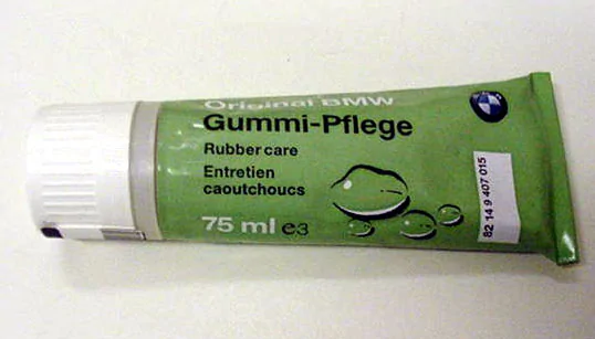

I have the spray 303, but I think this one is more for the rubber / flexible seals ?
For that purpose, I still have a really old tube of BMW Gummi-Pflege :
However :

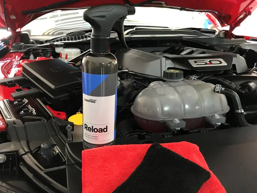

Of the water-based dressings for exterior trim, 303 Protectant is a solid choice. Just know that its not "semi-permanent" and will wash off in rain and regular washing.
Short of going to a trim coating, which I'm moving away from, using one of the (many) ceramic sealants will give you that rich, dark, non-greasy and semi-permanent finish. I really love Carpro Reload for this, and pleasingly, you can order bottles right down to a 100ml size for as little as 7 pounds. I think once you try it on trim, give it a go on paint and see how you like it, one of the slickest, glossiest paint sealants on the market.
CarPro Reload 2.0 Spray Sealant — Polished Bliss
CarPro - ReLoad 2.0 Spray Sealant
CarPro Reload 2.0: Silica & Siloxane Spray Sealant — Slims Detailing

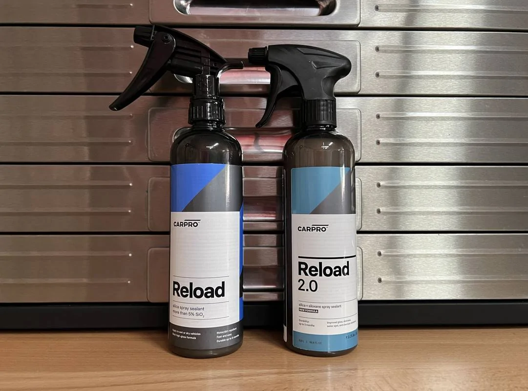

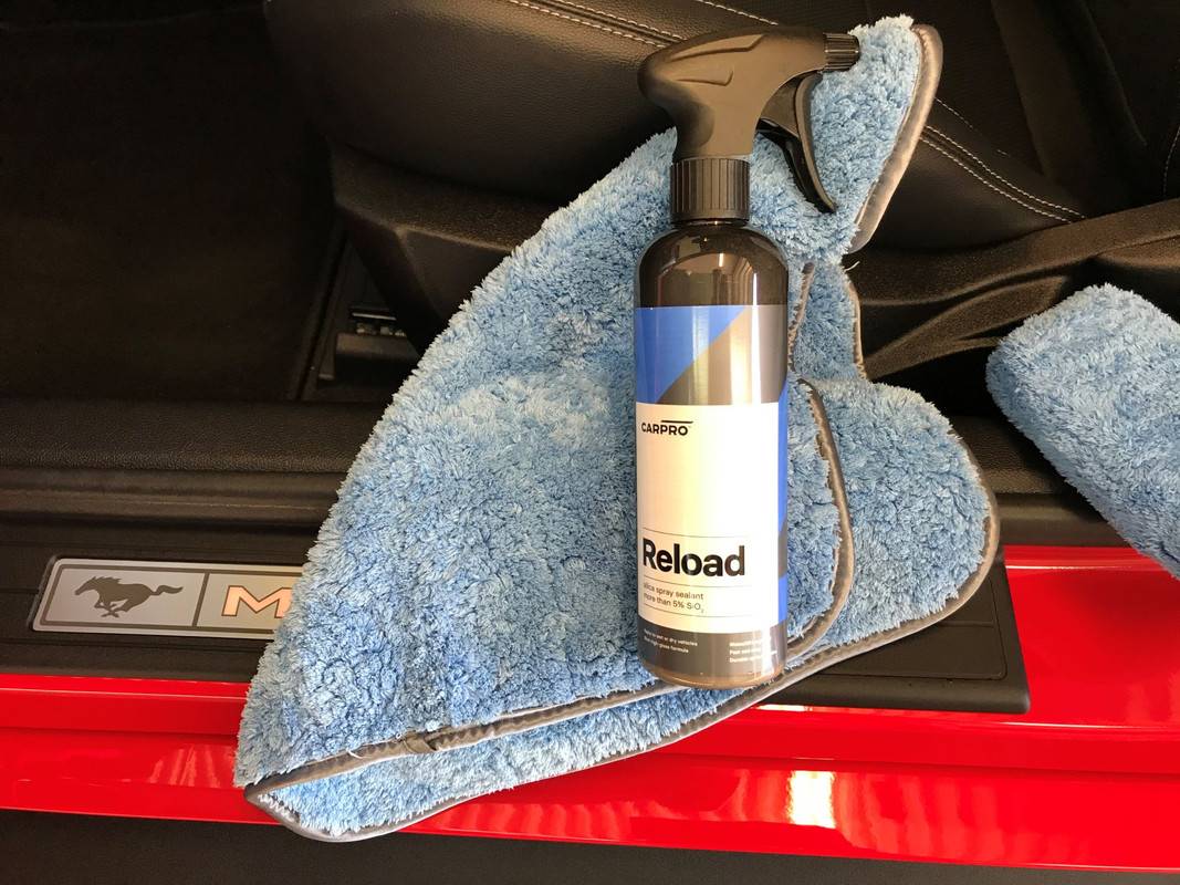

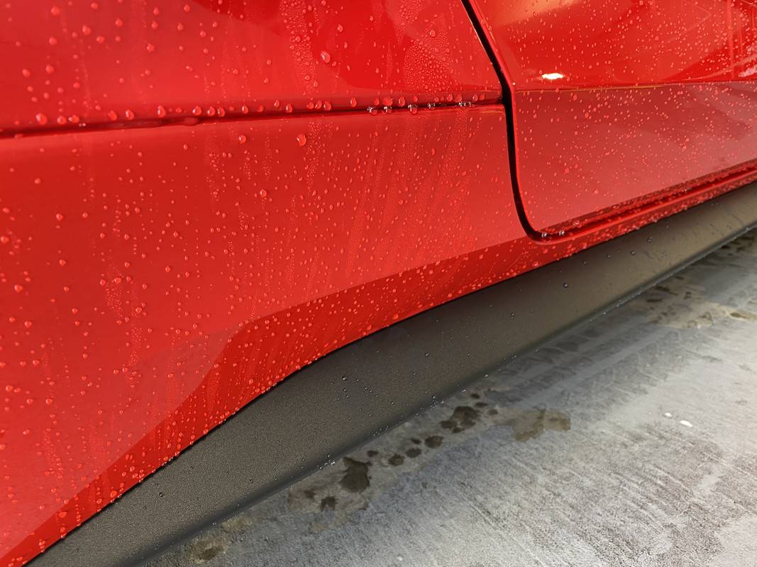

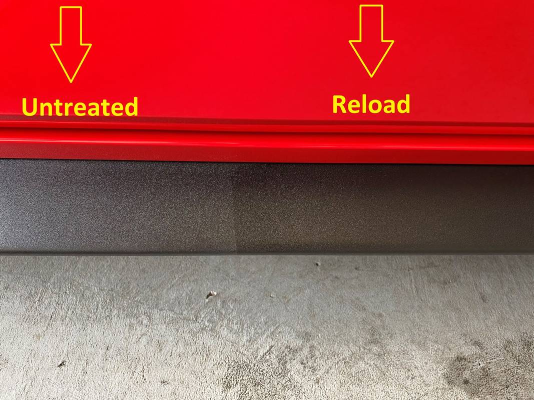

Below is the older Reload v1, the latest v2.0 is even better. As you can see, it's a subtle enhancement, while also providing UV protection (like 303) and hydrophobics (unlike 303). I also find its easier to apply because you don't have to worry about getting it on the paint.

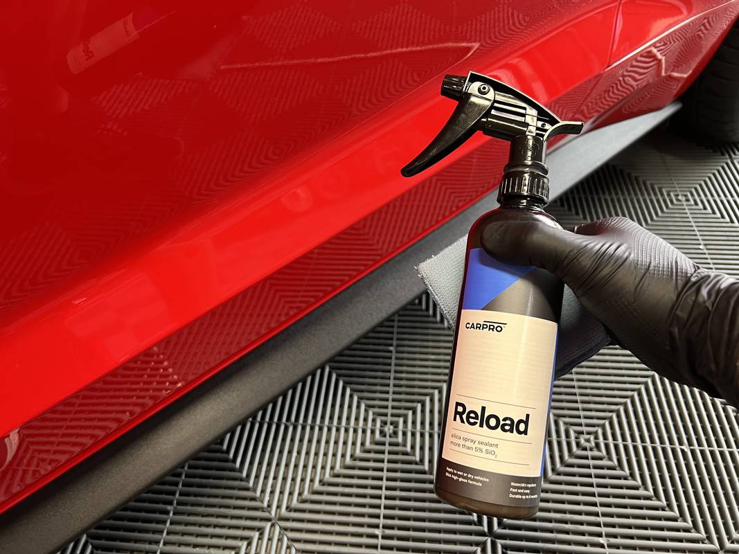

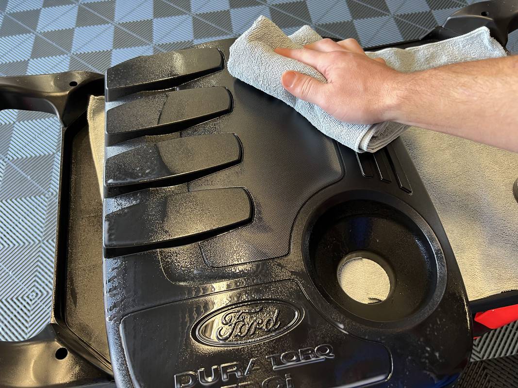

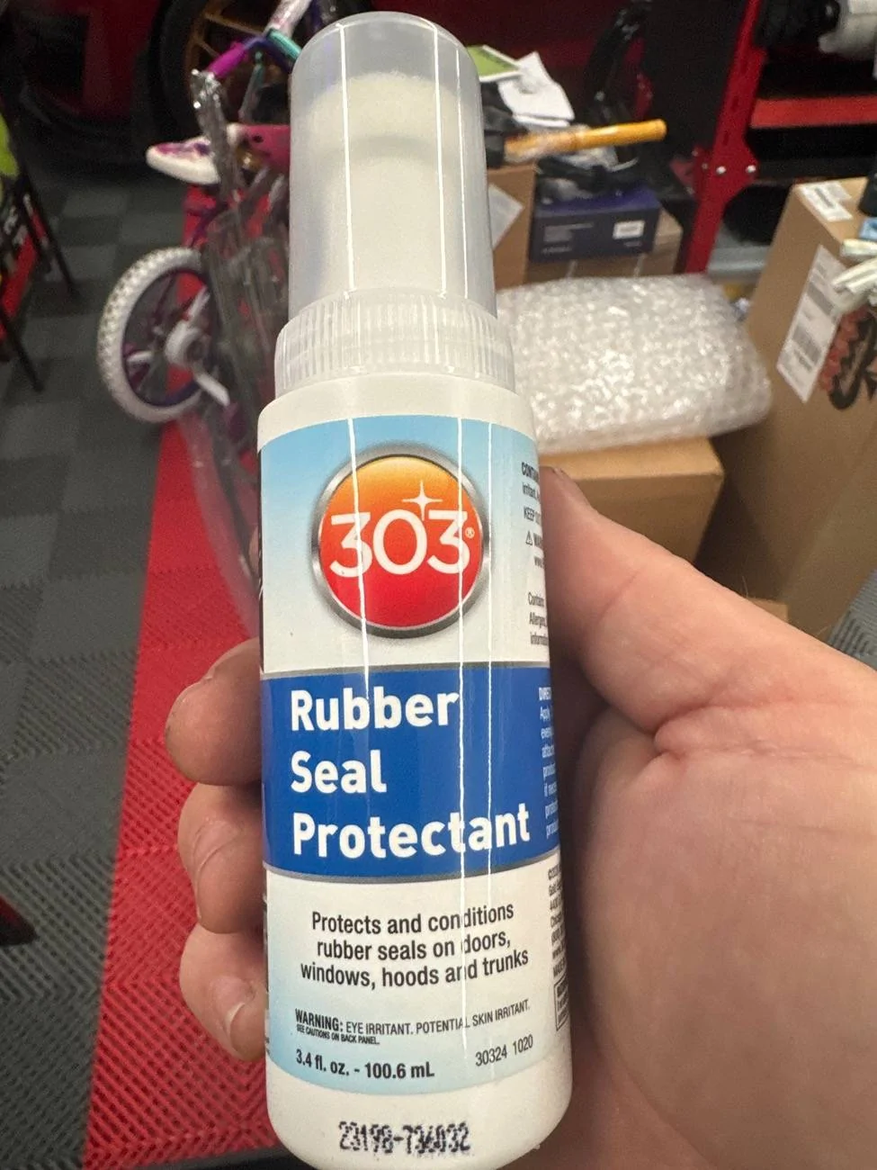

The 303 Rubber Seal Protectant would appear to be of a thicker consistency than regular 303 Protectant. However, both are water based dressings.
303 Protectant can be used on a large variety of surfaces -
- Rubber Seals
- Rubber Trim
- Black Plastic Trim
- Tonneau covers (vinyl)
- Interior Plastics
- Leather trims
- Vinyl Interior trims
- Engine bay plastics, rubbers, hoses
- Tyres, which gives a very subtle enhancement

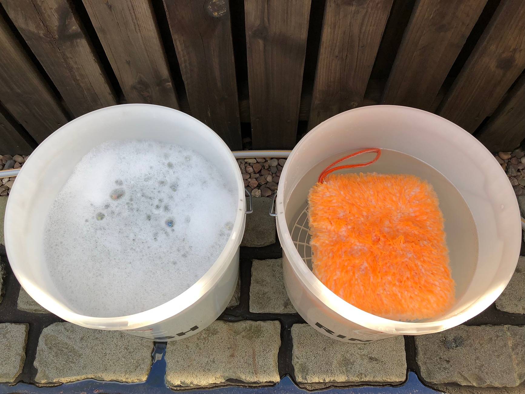

It should be arriving with a bottle of brake buster, which is a new product for me as my normal wheel cleaner seems to have escalated in cost somewhat since it’s last purchase.

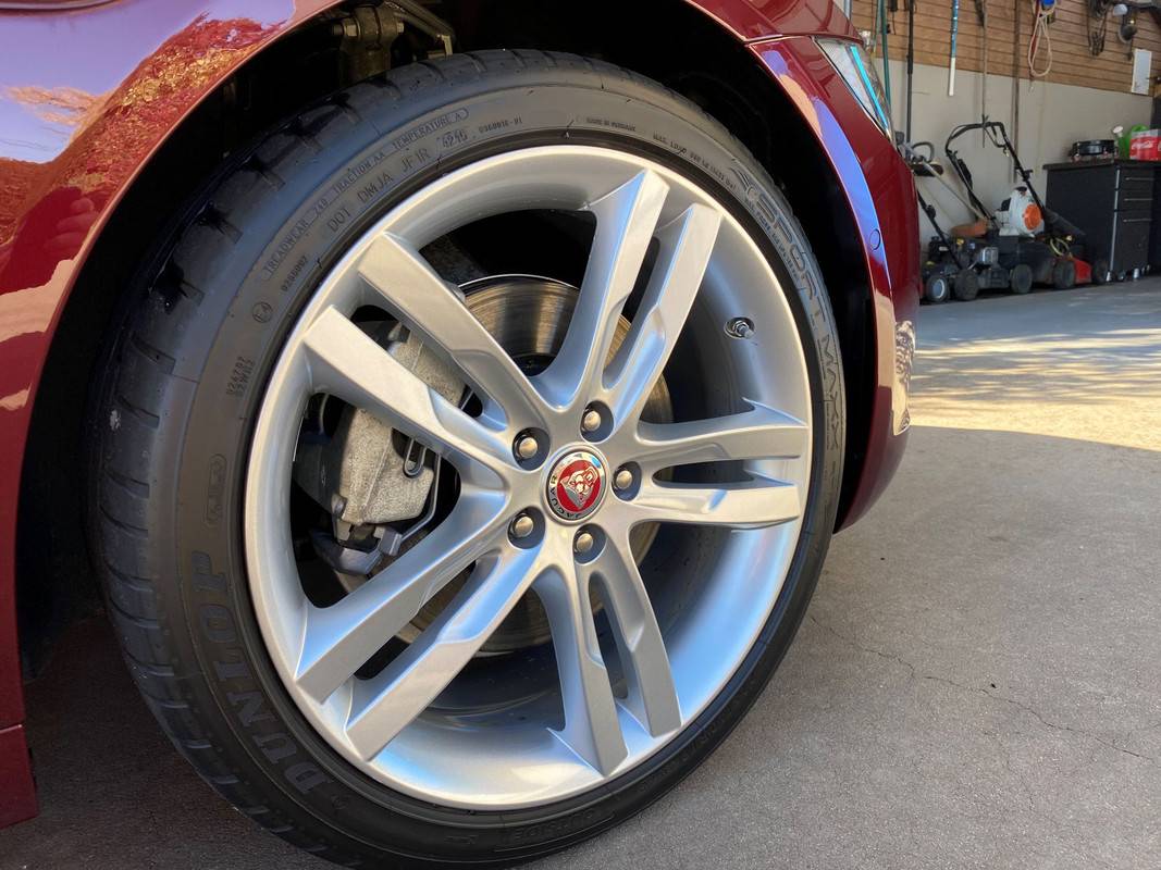

Brake Buster is an excellent! I love how it foams and lathers, however its also extremely slick and contains corrosion inhibitors.
For tyres, you will love how it lathers up under agitation, the best I have found. I use it undiluted for maximum ability on tyres, or foamed for light cleaning.
On wheels, you may find Brake Buster at full strength a little aggressive, in fact it will strip waxes and products like Hydr02 or Wet Coat. I use it in my foam cannon, which in effect dilutes it. What I like most about the foam is that it sticks to the vertical surface of a wheel and wheel arch, therefore extending your working period. If you don't have a foam cannon, then one of the pump foamers will work, or just a regular sprayer, both diluted at 10:1.
And for those who think Brake Buster can't do some heavy lifting when required, this is it attacking never-before cleaned tyres...............................
Undiluted, no contact....................................
After scrubbing...............................................

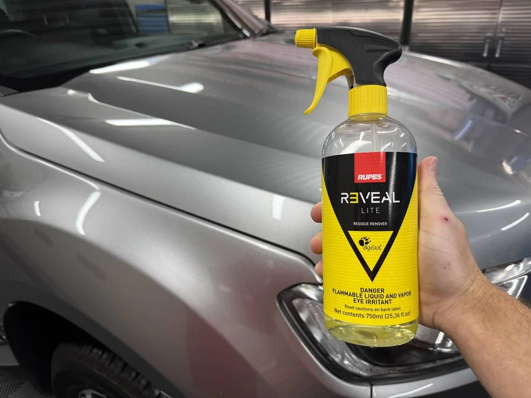

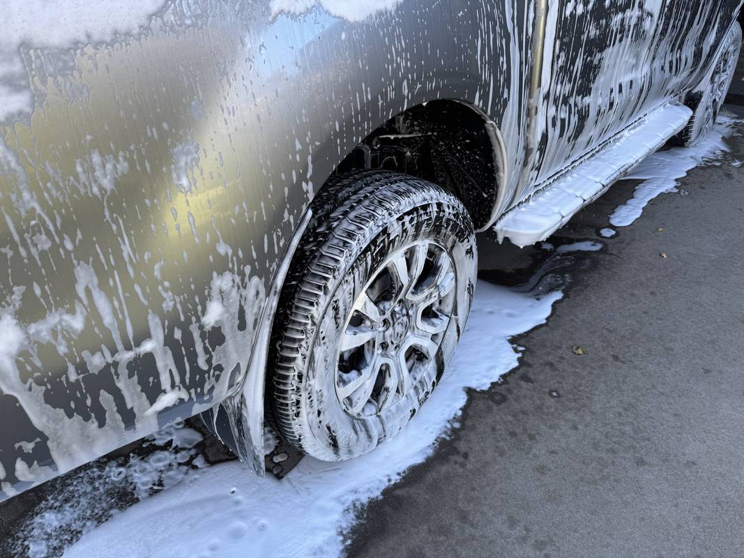

Decontamination & Prep Work -

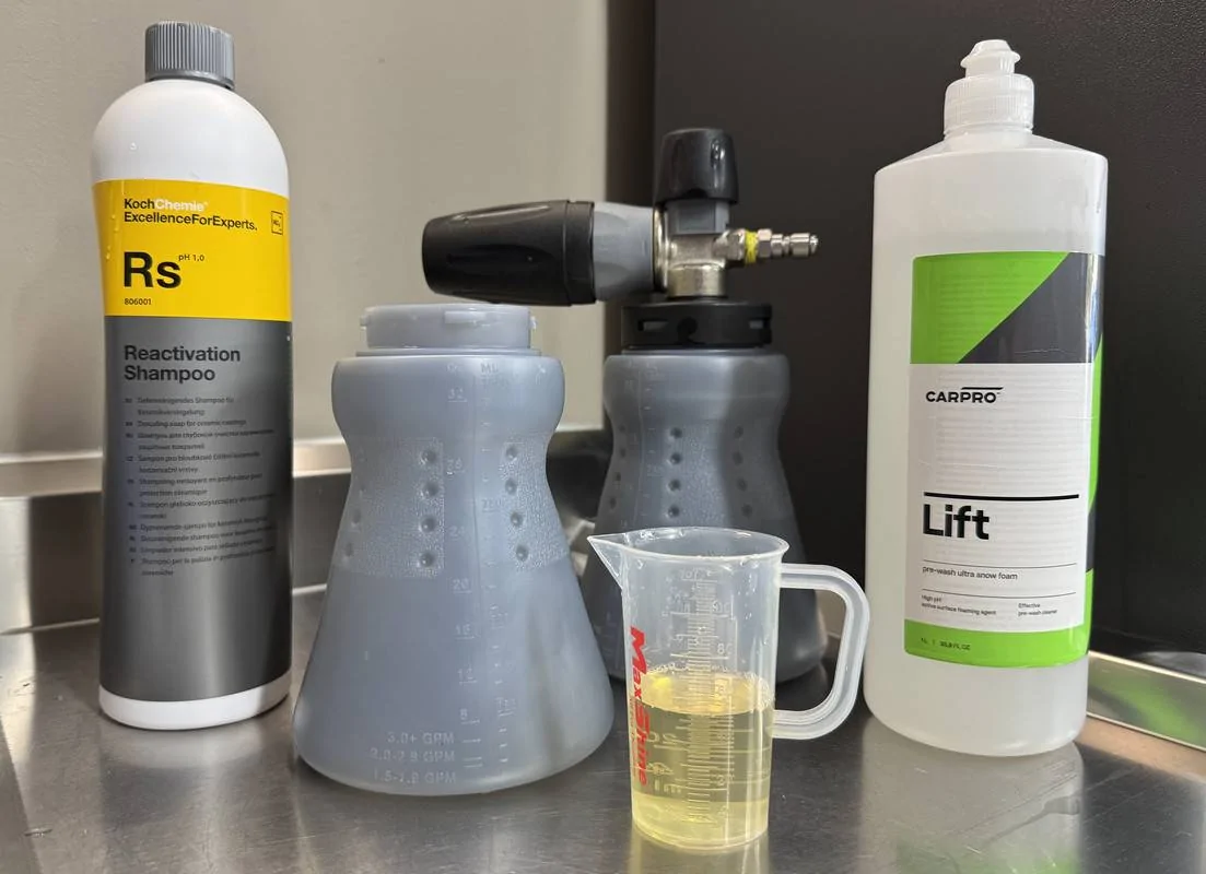

This project began last week with a partial decontamination via an iron remover and clay treatment. Today, I foamed the car down with Carpro Lift, rinsed, then foamed with KCx Reactivation Shampoo.
Carpro Lift mid-dwell..................
This was my first use of Reactivation Shampoo, which an acidic soap designed to revive ceramic coatings, in particular breaking down and neutralizing mineral content. Obviously, there is no ceramic coating to revive here, but considering the vehicle sits outside in all conditions, the removal of potential mineral content is worthy endeavour. RS will also help strip away the spray sealants and drying aid’s I’ve used to limp the car through until now. This soap is pretty strong, so rather than eyeballing it, I made sure to measure this one out, 50ml in the bucket and 60ml to 940ml in the foam cannon.
Now, those quantities might sound a little anemic, and I've noticed GSF won't foam very well at similar suggested dilutions. But pleasingly, RS foams brilliantly at those numbers while also being exceptionally slick. It does have a rather strange aroma though, much like a bathroom shower cleaner.
With the car rinsed for the final time, I used the blower to remove as much water as possible, then went around with a large drying towel and Rupes Reveal Lite to finish the decon step. The Reveal also helps evaporate the moisture, especially helpful considering how flat the paint after the strip washing. At this point, the paint was squeaky clean!

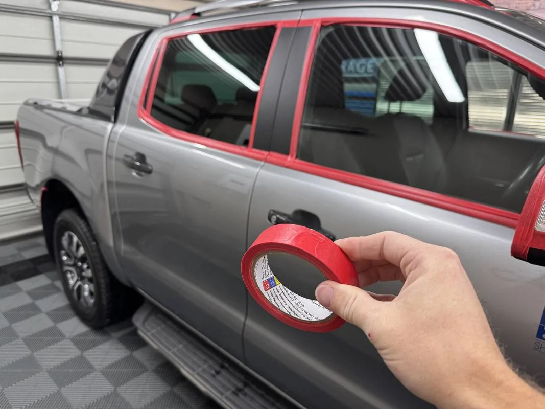

The final step was to go around taping up various trims, some of which were treated with Solution Finish earlier this year. You can see I also taped the glass side of the trim while I was at it as I planned to polish the glass too.
Products Used In this Step -
- Gyeon Iron Remover
- Economax Clay Mitt
- Gyeon Clay Lube (Diluted 5:1)
- Carpro Lift (Alkaline)
- Koch Chemie Reactivation Shampoo (Acidic, Diluted 15:1)
- Rupes Reveal Lite (IPA Prep Spray)
- Carpro Masking Tape

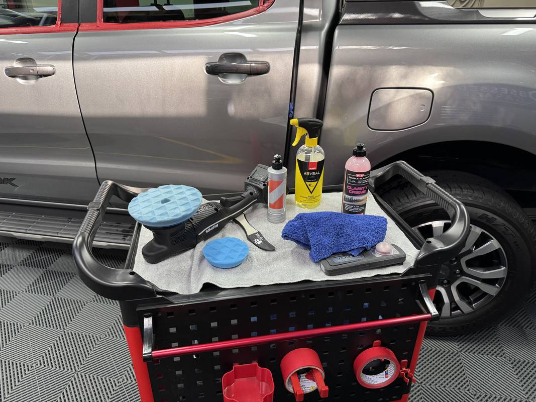

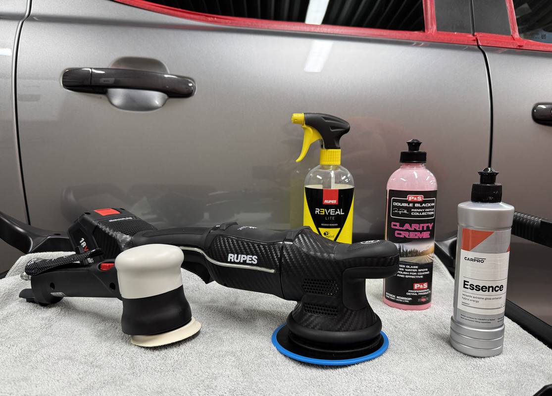

Polishing –
The goal for polishing wasn't for an all-out correction, just a refresh. My father couldn't care less about flawless paint, so I was not about to spend days using multiple steps or even trying various compound and pad combinations. I went straight to the ShineMate blue foam with Carpro Essence. Why? Because Essence does a few things at once, such as being relatively mild, in fact it uses the same abrasives as another favourite of mine, Carpro Reflect. However, Essence also leaves behind a layer of Si02, in effective priming the surface for a coating. That Si02 also has the ability to fill certain defects, which is kinda cheating but considering the goal, I really don't care. And finally, it's stupid easy to work with, doesn't dust and is a dream to wipe off.
A couple of tips when using Essence -
- Like any "all-in-one" type polish, you need to be mindful of what that CAN do to your pads and towels.................
- As you finish with each pad, put it straight into a bucket with water and APC, microfiber detergent or an alkaline soap such as Lift. Don't put them straight into water as you will make things worse.
- With your towels, you can be a little less anal, but be sure to wash them straight after your polishing session. If you can't wash them ASAP, put them into separate bucket of water with APC/detergent/soap and allow them to soak till you can.
- In both cases, you are avoiding the sealant from setting up in the fibres of the towel or foam material, in turn rendering them useless.
- For more cutting performance, run more passes to fully cycle the abrasives.
- For more filling ability, short cycle by spreading rapidly over the section and then completing a single set of passes.
- Essence is said to be best with a light foam finishing pad, and especially good on a microfiber finishing pad. In my case, I know it works well with the intermediate level ShineMate blue foam pad.
You will also see P&S Clarity Creme on the cart, that was teamed with a Rupes Coarse Wool pad on the LHR75 Pneumatic. There weren't really any scratches to deal with, I just wanted to deep clean the glass. Clarity Creme is brilliant at doing this, especially on an aggressive pad like that.
There were a few isolated scratches here and there that needed more than what Essence is capable of doing. For that I used Griot's Fast Correcting Creme on the iBrid Nano. Wow, that stuff is brilliant! Once again, I'm left wondering why that brand has been left on the bench for the Australian market. And yes, the headlights needed polishing AGAIN, so much for the special Opti-Coat headlight coating, which barely lasted 4-months of the supposed 12-month claim.
I also had some company today, no doubt wondering when it was time for walkies. At one point I had the front passenger door open, which obviously meant it was time for walkies and had him attempting to climb in.............sorry for the false hope buddy, maybe tomorrow.
Products Used In This Step -
- Carpro Essence
- Griot's Fast Correcting Creme
- P&S Clarity Creme
- ShineMate Blue Foam Pads (4-inch and 6-inch sizes)
- Rupes DA Coarse Wool (3-inch size)
- Rupes DA Fine Foam (2.5-inch size)
- TRC Creature Edgeless Towels
- Rupes Claw Pad Tool
- Rupes iBrid Nano Long Neck (2-inch backing plate)
- Rupes LHR75 (3-inch backing plate)
- Rupes HLR15 (5-inch backing plate)
- Carpro Essence
- P&S Clarity Creme
After removing all of the tape and a quick wipe over with a damp towel to remove the dust created by Clarity Creme, I covered the car with two microfiber blankets and called it a day. Tomorrow, a more thorough wipe down with Eraser, followed by the coating.

I do wonder if the Capro Essence primer polish played a part in this.
Never tried the stuff D but I'm curious about the SiO2 prep layer. Do you ever use it after a standard, more aggressive polishing sessions prepping for ceramic or would that be a waste of time?
..then went around with a large drying towel and Rupes Reveal Lite to finish the decon step.
I don't recall you mentioning this product before, (my apologies if you have,) but is there anything special about this panel spray?
Essence is basically a finishing polish with Si02/ceramic in it.
Carpro originally designed it for finishing on really soft paints that are prone to marring because it will fill minor imperfections that can be inflicted during the wipe off. The idea being you can coat right over the top without a prep-spray wipe down, in turn minimising towel work and therefore re-inflicting more marring.
Otherwise, you can use it as your finishing polish after a heavier cutting compound.
Rupes Reveal has been around for about 18-months now. I like it, but Carpro Eraser is superior. There is also a Reveal Strong, which is like Gtechniq Panel Wipe in being very aggressive. Reveal Lite can be used like Eraser, as in sprayed directly onto the panel. However, Reveal Strong must be applied into a towel and not directly.

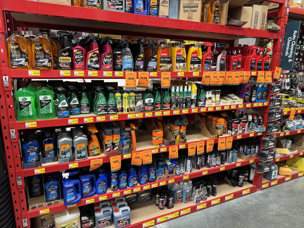

So, Bunnings (think Home Depot for US readers) have joined the car care and automotive sector. I noticed a few Meguiar's products creeping onto the shelves earlier this year, but they now have an entire isle dedicated to automotive, with several shelves of that on car care. This will undoubtably shake things up a little, which I will explain shortly.
Retail ain't what it used to be, where each store "stayed in it's own lane".
What next?
Fridges and toasters at Bunnings?
Maybe then we could call it Masters 2.0.... except with unhelpful staff (if you can find them when needed), and monopolistic anti-competitive pricing, along with an arrogant take it or leave it attitude towards both their suppliers and customers.
And don't get me started on inventory reporting... when the website says low stock - it means out of stock. When it says in stock - it could mean out of stock, and new stock is on the way.
Q) If other enterprises can have accurate real-time inventory reporting, why can't Bunnings?
A) Arrogance. They couldn't give a flying fcuk if customers have to drive all over town to multiple stores just to find something that is supposedly "in stock".
Oh wait... I got started on a pet hate. :giggle:
Boy, do I miss having Masters as a competitor.
And in Breaking News down under in 'Stralia...
Total Tools is starting to sell gardening products.
Nothing to get excited about.... move along.
