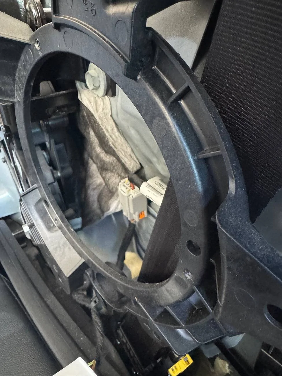

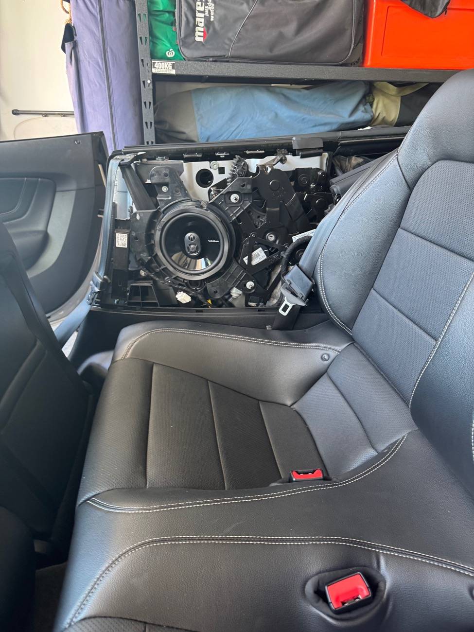

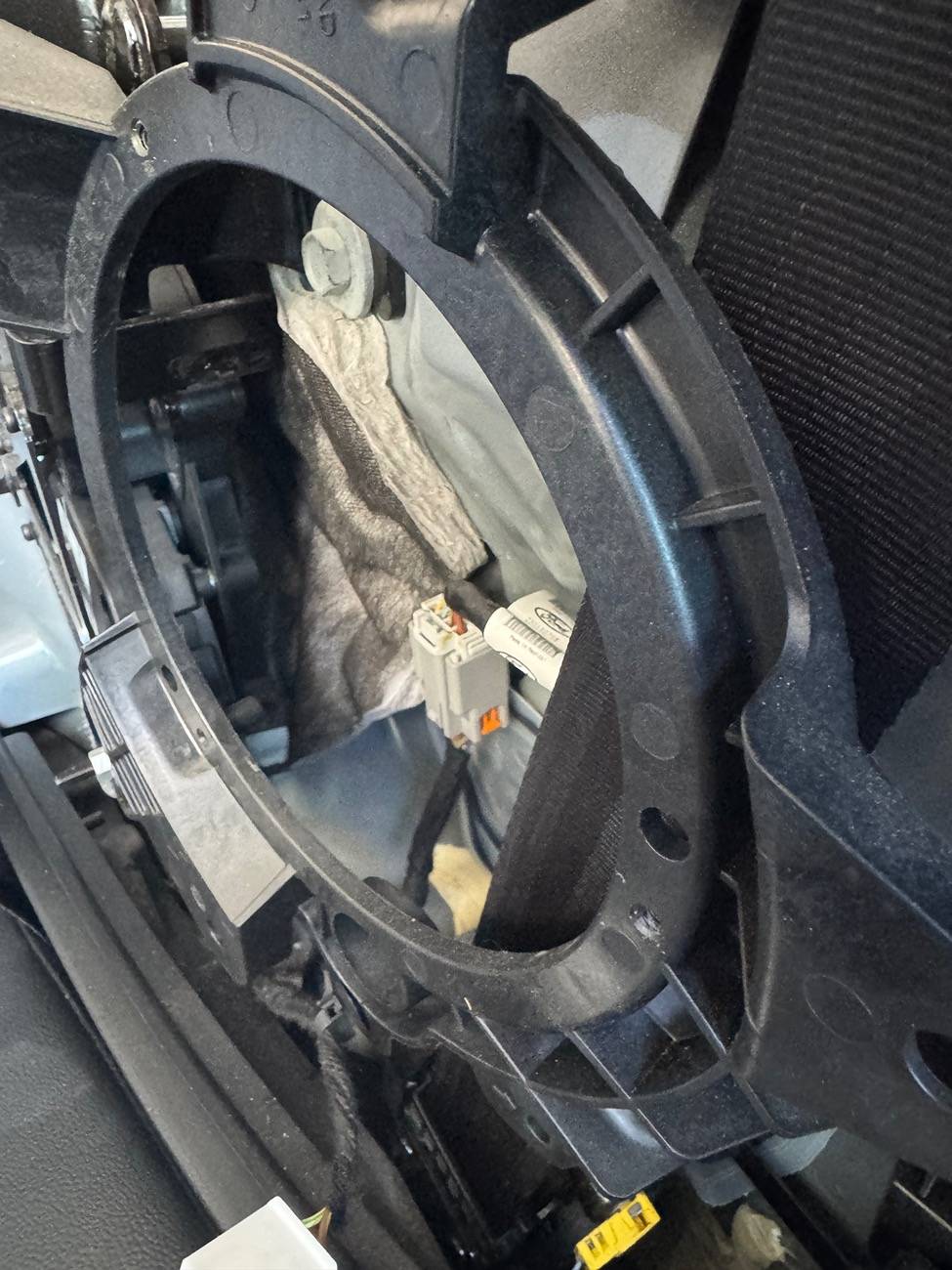

Looking for suggestions on what speakers others have been able to fit in will fit in the rear seat panel. Depth seems to be limited by convertible top mechanism /car structure.

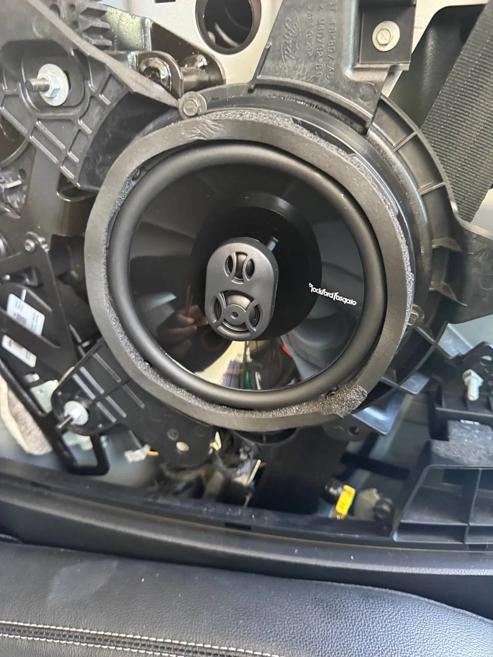

I used JBL 639’s without an issue.

Sorry they were GTO 638, 3 way speaker's. Depth is 2 1/16.

I am going to install these speakers in the rear seat panel of my 2016 convertible. Do they require any adapter rings or anything else? I've got the Metra 72-5602 connector. Thanks!

It’s been a day or two since I installed those but I don’t recall needing anything special to install them. Other then modifying the connector, but you have that covered already.
